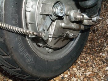

Undo your front brake adjuster, you will notice that when you take the adjusting wheel or nut off, the is a small trunion that sits in the operating arm put this to one side for now. Undo the cable from the brake adjuster, the adjuster should now be free. Take the top hat out of the housing where the cable goes in,
You can now fit the adjuster to the lugs on the brake backplate where you just took the top out out of.

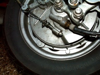

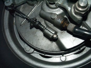

To do this slide the thread bolt part of the adjuster with the spring already on it, into the lugs from the back to wards the front, i.e. the part of the adjuster that takes the cable should be pointing backwards. On the thread that comes out, with a suitable washer and a 10mm nyloc nut.

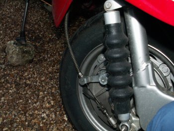

Un route the cable as far as where it comes out from the top of the forks, re position as in this picture here. It will be best to take your front brake lever out of the handle bars at this stage and pull the inner out at least half of the way. Route the outer cable as shown in this picture, and trim to suit its new length using good quality cutters or hacksaw. Fit the trunion that you took off the adjuster back into the disc operating arm, then on that hold the top hat, thread the inner cable back through so it passes through both these parts, continue until the cable is pulled all the way through.
