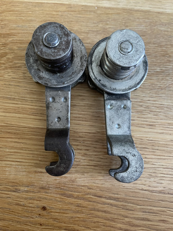

Postby Storkfoot » Sat Jul 09, 2022 6:44 pm
Here’s another two I now have. The top one is off an early unrestored S3 TV175 so I am almost certain it is original. I think the one below is a pattern copy that has been chromed. The preening and dimples look different.
If you search for a picture of the Casa Lambretta copy online, there are no dimples and the preening is non existent. Doubtless, there have been several pattern copies over the years. I know there was a Vietnamese made one several years back.
Re: Disc brake actuator
Postby nsaints » Sat Jul 09, 2022 7:54 pm
Here's two of mine on the bench earlier today
I think the one on the left is a copy as it's the worst performing of the 4 I have. What I mean is the lever has to travel the longest before the pads bite. it's nearly impossible to setup the brake correctly - spongy feeling, lever hits the bars too easily
The one on the right is possibly original. Nice operation, easy to setup the brake's biting point, not spongy like the copy
I notice the reverse side of the actuator plate is convex towards the edge, where as the suspect copy is flat
The actuator on my TV - very good operation
Probably the best operating actuator I have
The actuator on my GP - lack of dimples. I think this is a Casa actuator
good operation, much better than my suspect copy actuator
Finally - Saturday night were never better - posting pictures of Lambretta actuators :roll:
