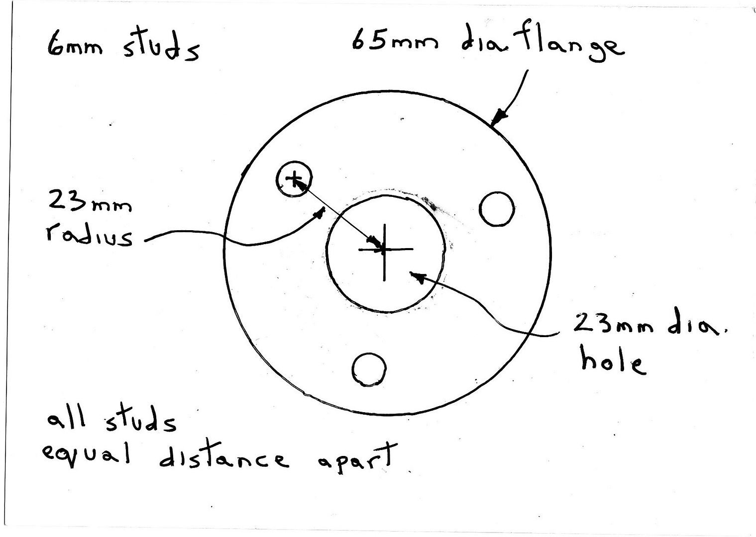

hi peeps
i'm probably asking for the impossible but here goes.
i'm currently running a Performance pipe with a "quiet" stainless muffler. when i say "quiet" i'm comparing it to my Sito Ancillotti with stainless downpipe that i had fitted previously.
no way is this new pipe what i call quiet (and i'm deaf in my right ear).
can anyone point me in the right direction for a muffler that gives a genuine reduction to the loud "crack" that i'm lumbered with at the mo.
here are details of the flange i have to fit to:
thanks for any help guys :)

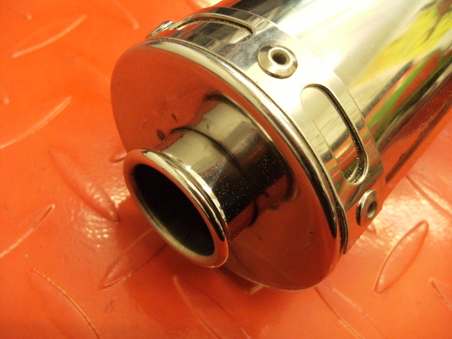

Can this one be repacked with good quality fibre mat from a MX shop?
Scooter Paul
Posts: 374
Re: "Quiet" muffler required
Postby peejay » Sat Aug 02, 2014 6:33 pm
can this be repacked?
Postby mickyb » Sat Aug 02, 2014 9:00 pm
yes, but you've got to drill the rivets out first
mickyb
Posts: 69
Joined: Fri May 30, 2014 2:41 pm
Postby rossclark » Sun Aug 03, 2014 12:10 am
Getting the band back on and it rivetted on is a PITA as well
Postby Digger » Sun Aug 03, 2014 6:28 am
rossclark wrote:Getting the band back on and it rivetted on is a PITA as well
Yes but it can be done - It gets easier the more you do. :)
Digger
Posts: 992
Postby peejay » Sun Aug 03, 2014 9:17 am
thanks guys for the info :)

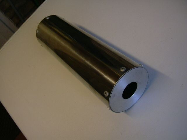

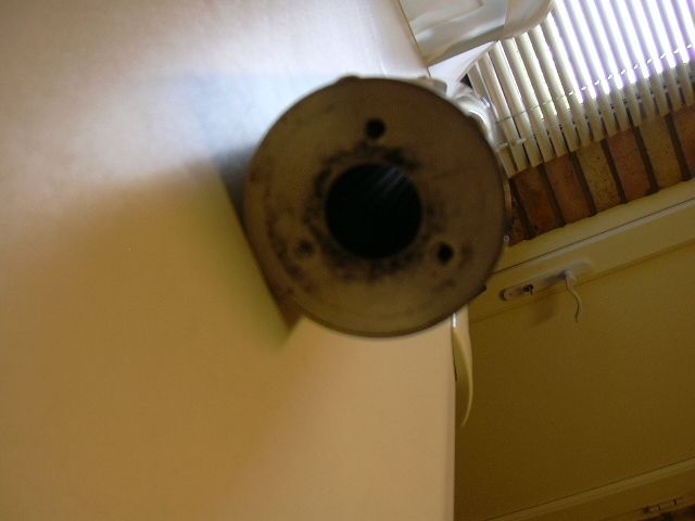

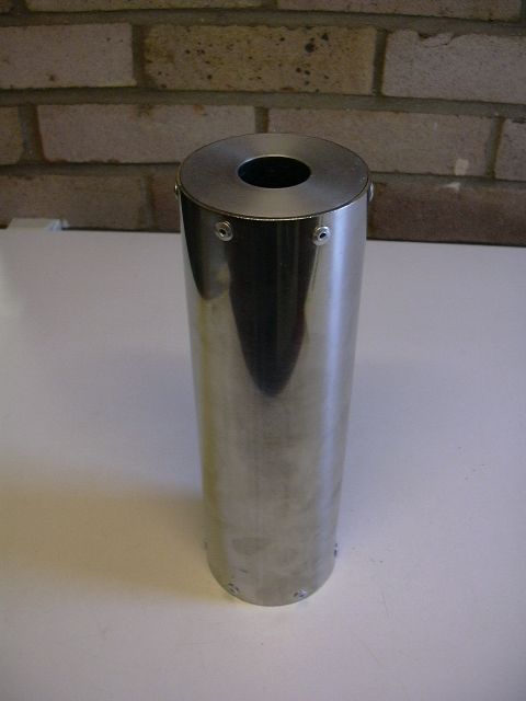

I made this for my JL3,but the centre pipe wasn't the same size so had to make another.Centre pipe 28 mm approx 23mm from centre for fixing holes which are 40mm apart.You could drill and helicoil new holes if needed..O/A size 76mm.Its staimless with 10 mm ali ends,so is heavy and you'll need another bracket,but it knocked 6db off the pipe noise. £35 plus p&p if your interested

thanks for the offer of that end can, i would like to stick with the one i have if possible (if i can repack it) or a different one that would bolt straight on.
