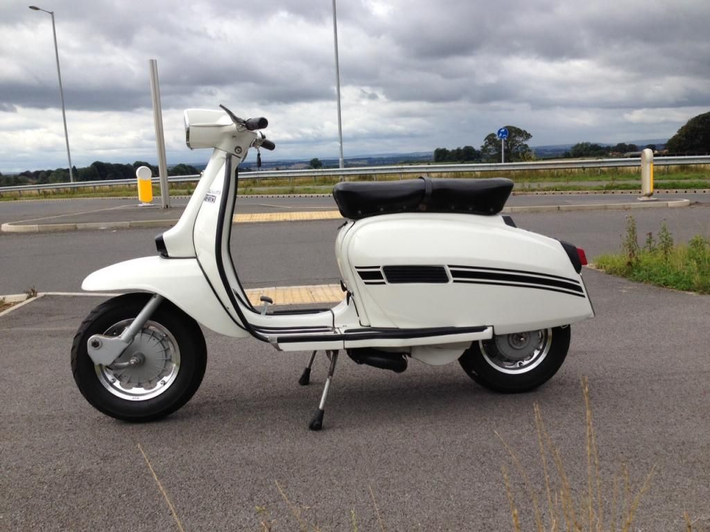

Thought you might like to see my 1971 GP125. It's got a quite interesting history. Bought from Eddy Grimstead in 1971, used until 1974 and then stuck in the back of a dry garage until 1999. It was then cosmetically restored by a scooter dealer who used it as a display piece for another 12 years.
I bought it in 2011 and it had just 8000 miles on the clock. Since then I have (slowly) been sorting it out mechanically whilst trying to keep it looking fairly standard. It now has:
Casa 185 kit
Polini CP23 carb
BGM crank
MB Clubman exhaust
Electronic ignition with Chiselspeed M-Tech advance/retard
AF tubeless alloy wheels
19/46 gearing
Pro Tec shock
It now produces a heady 10.64bhp with a stump pulling 11.59ft/lbs of torque!
Apart from the above, the scooter is almost all as Innocenti made it. The nice thing is that the paint (being 15 years old) has a bit of patina and doesn't look freshly sprayed which suits the look perfectly.

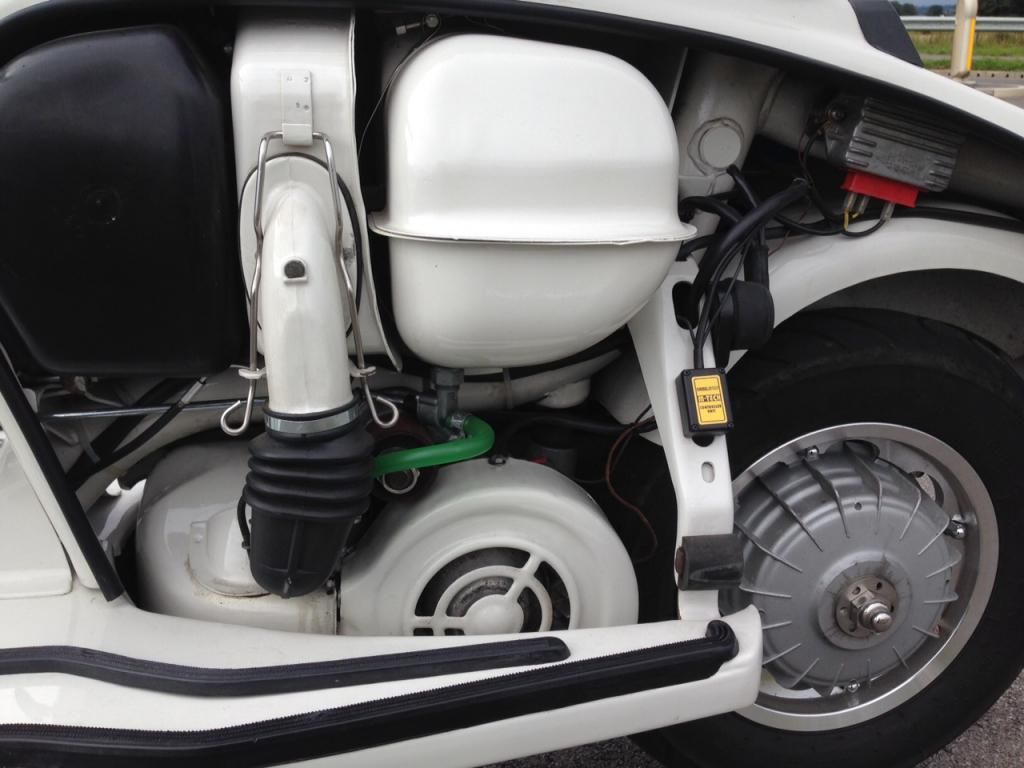

How do you find the polini cp23 carb ? My brother had one on a siver special with 175 top end and he removed it because he could only get about 25 to 30 mpg from it.

I haven't had chance to check out the fuel consumption properly as yet. From memory I think it did about 50 miles on 2/3rds of a tank so that's about 45mpg.
Starts and runs pretty well though and the carb really is tiny so you'd never know it was different unless you really looked.
I wanted to keep the airbox so it limited my choices.
I'll do a proper check soon and post the result.
