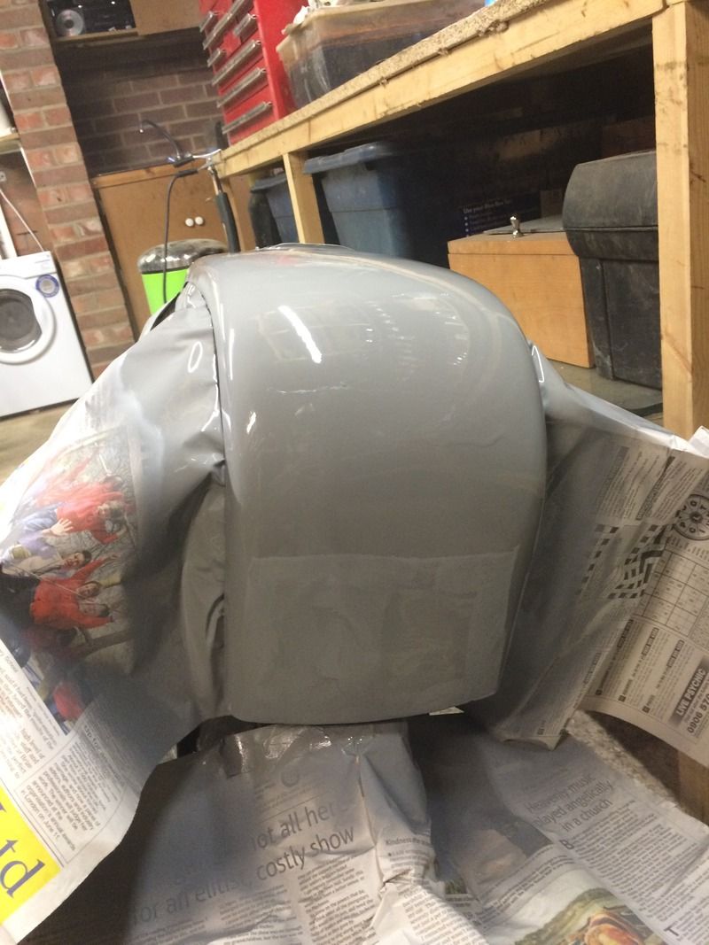

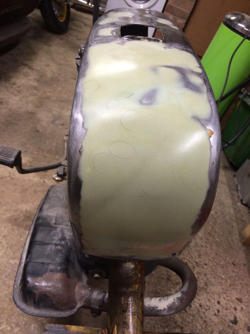

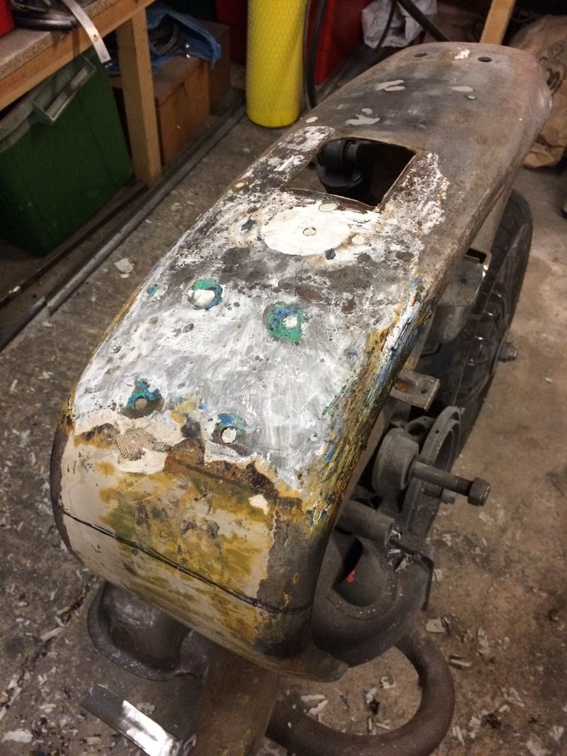

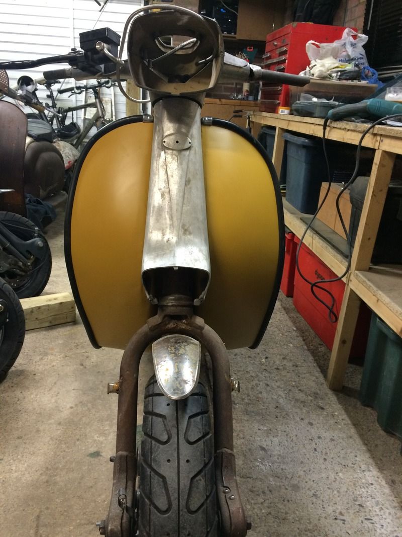

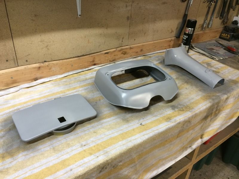

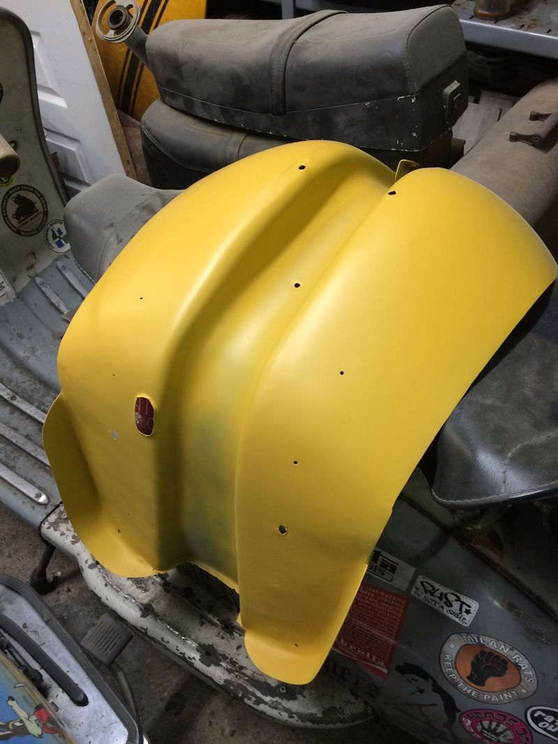

Bit of GSC progress, bodywork prep mainly.
The old sign writing had to eventually go

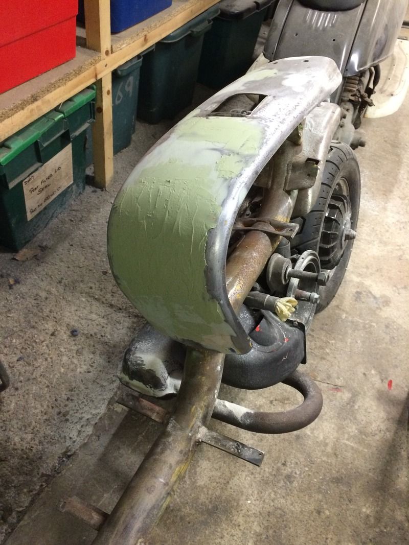

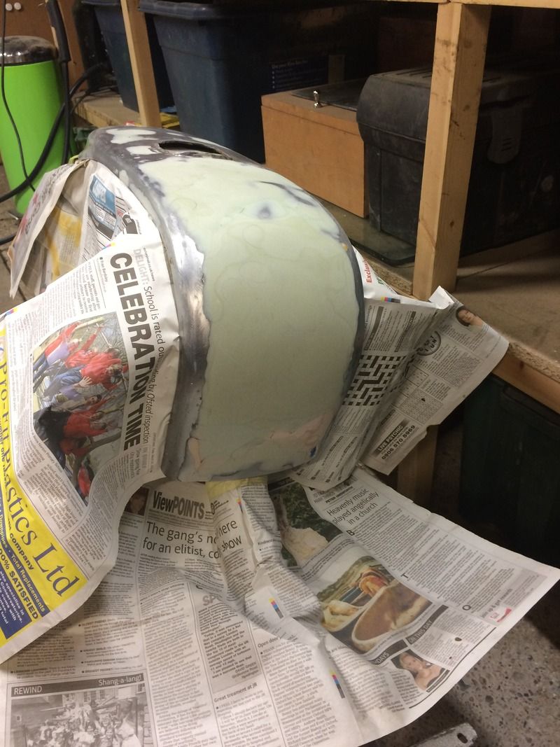

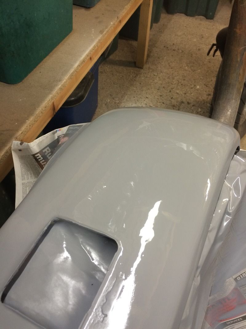

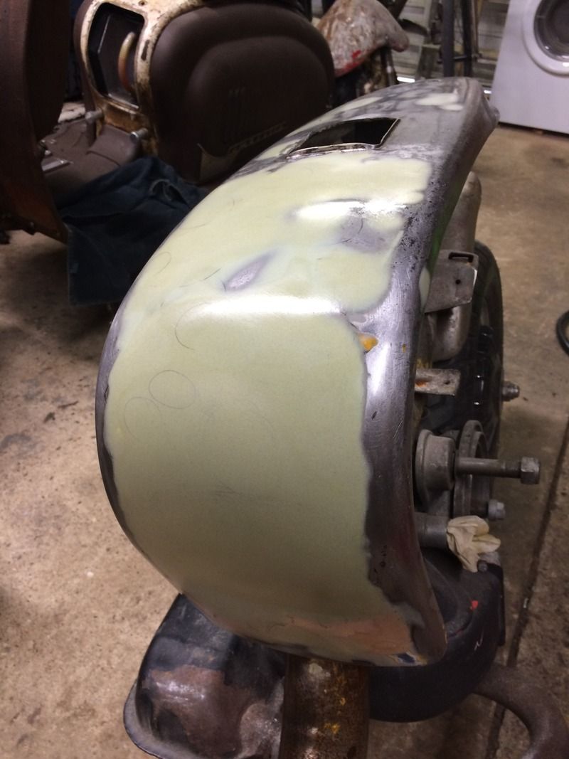

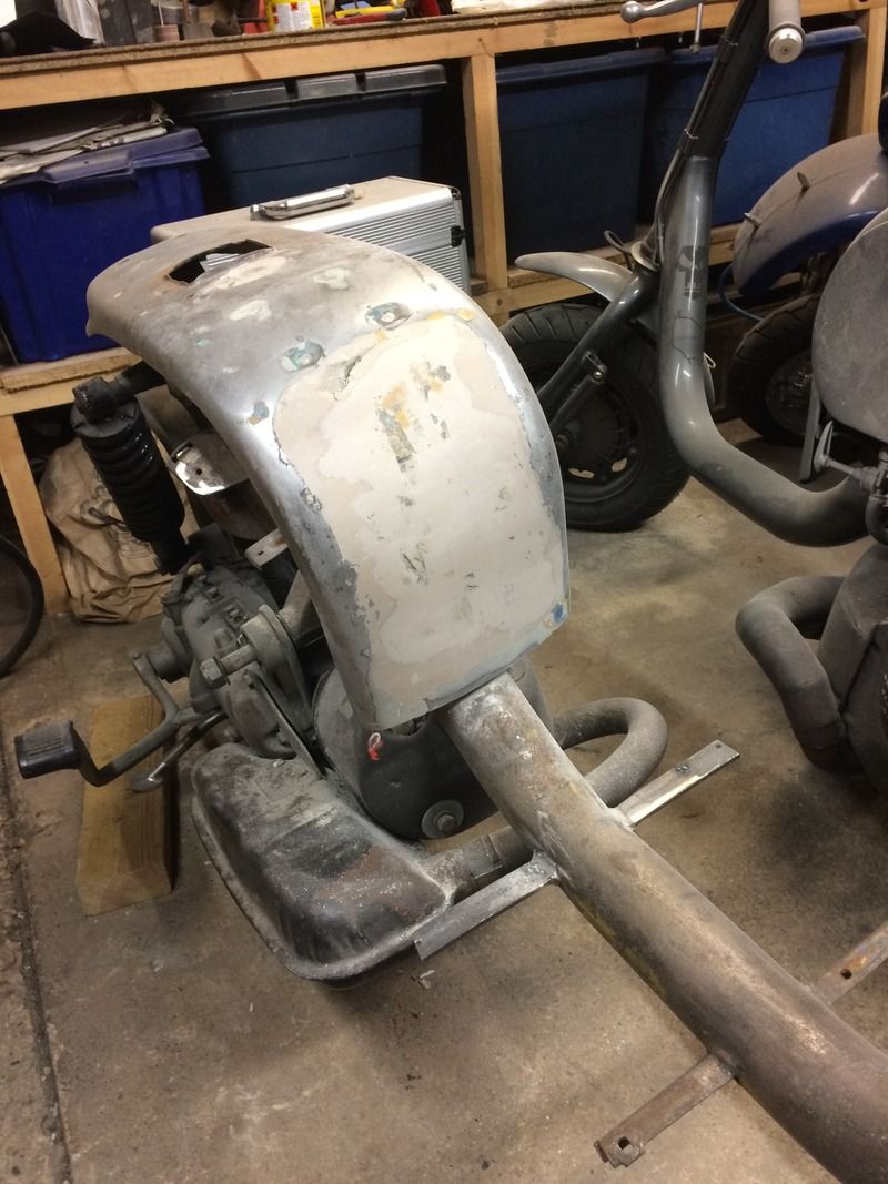

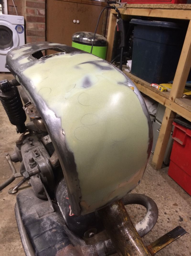

Mammoth filling session starts to tidy toolbox door area and top of loop
30+ hrs later filling and sanding

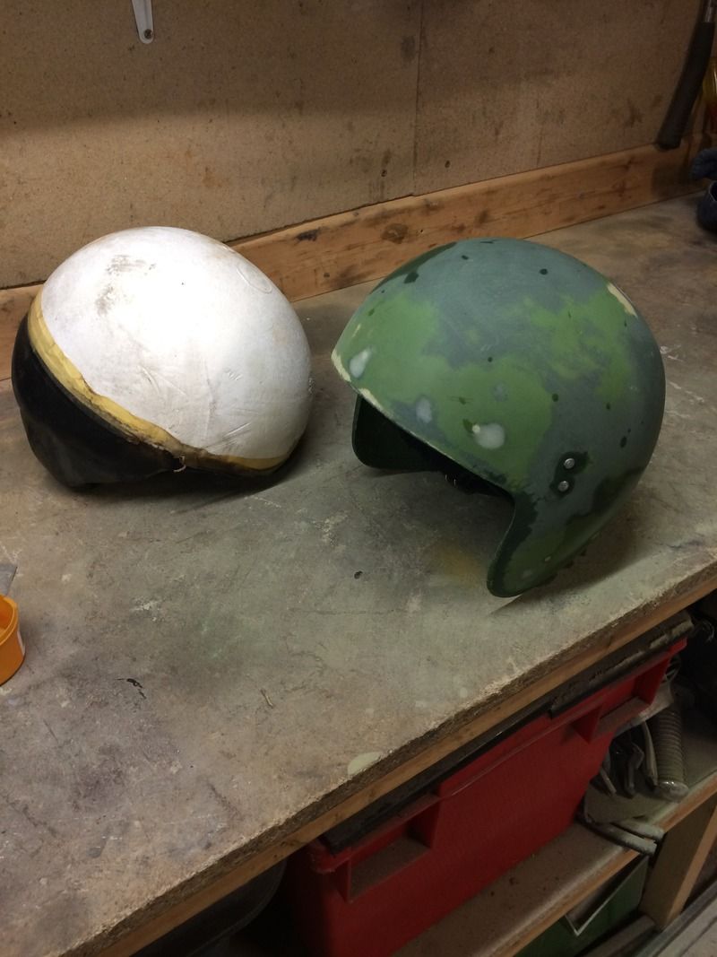

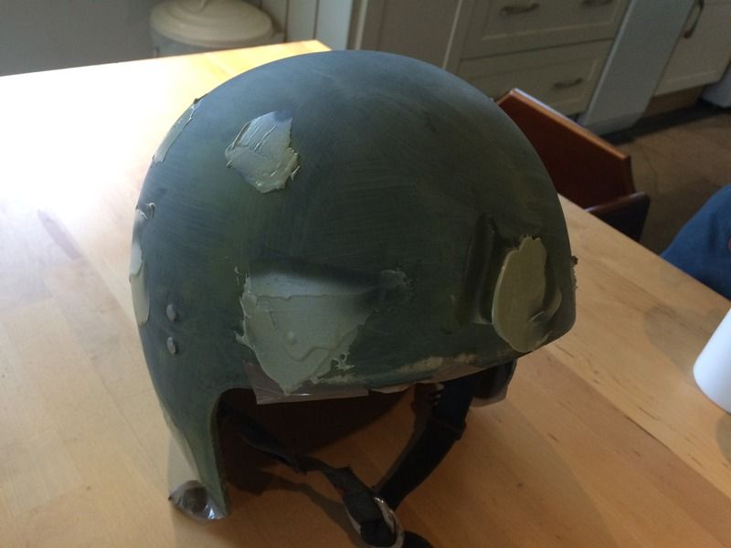

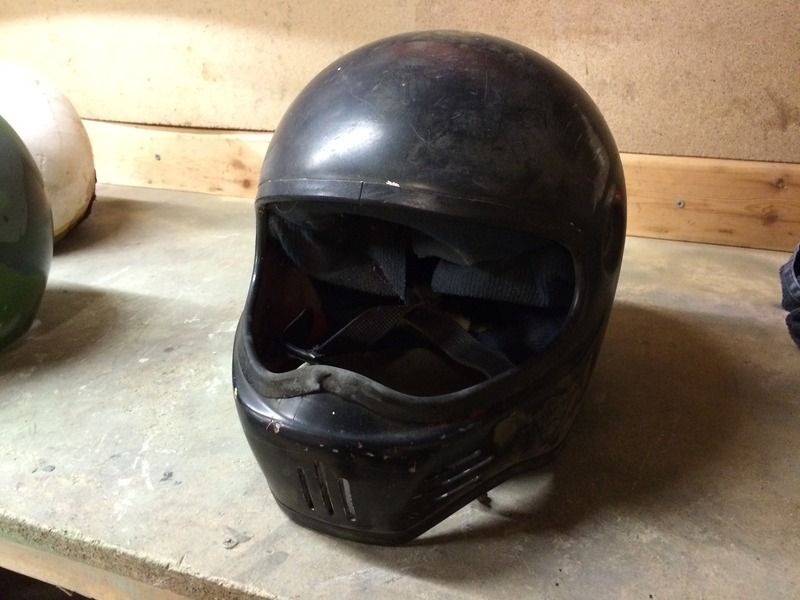

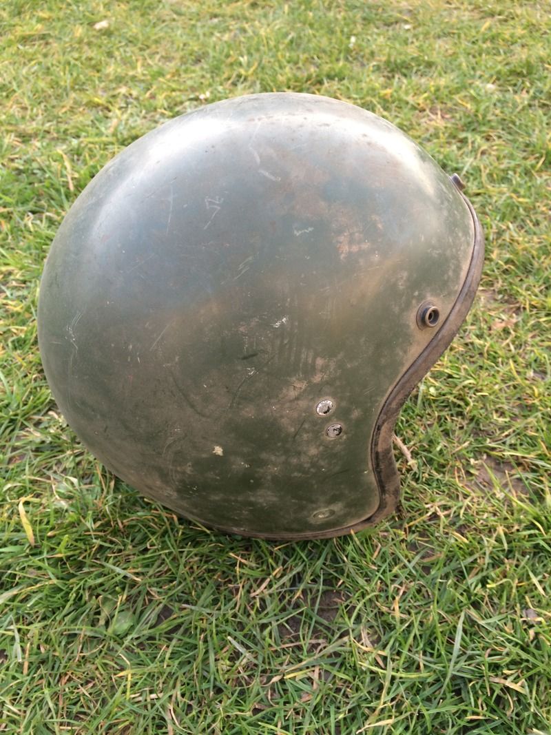

Plenty more prep work to go. Doing a couple of crash hats too.
My 1st lid... TMX2000!!!!
... and a piss pot. Probably only for leaning the bike on!

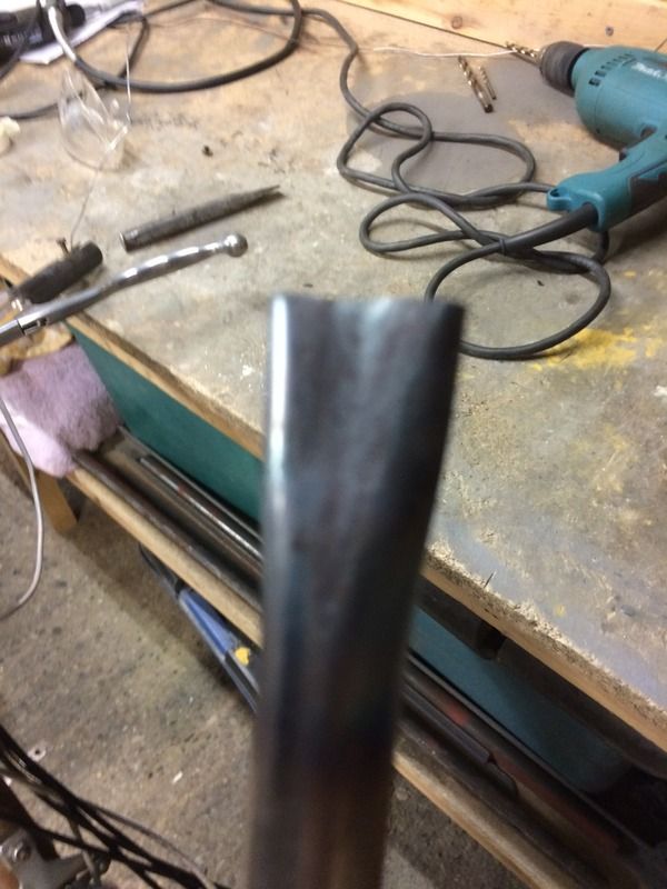

Leggies nearly finished, final coats of spray putty, nearly ready for final floor runner drilling. Leggies have been a bit of a nightmare to get straight. Should probably have used some new ones to save the endless filling and shaping.
GSC TBC...

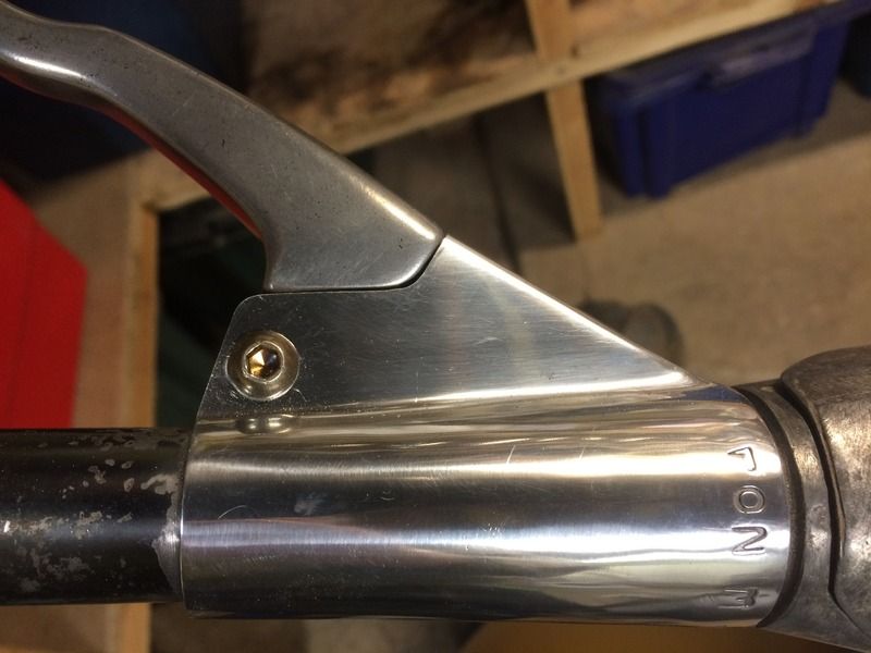

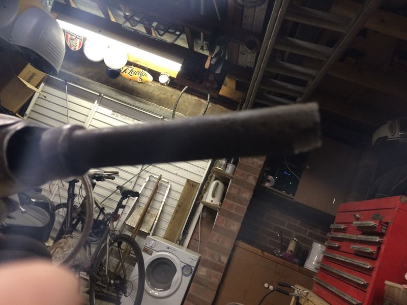

Knackered bar end
Went posh with MB brass bits for gearchange side

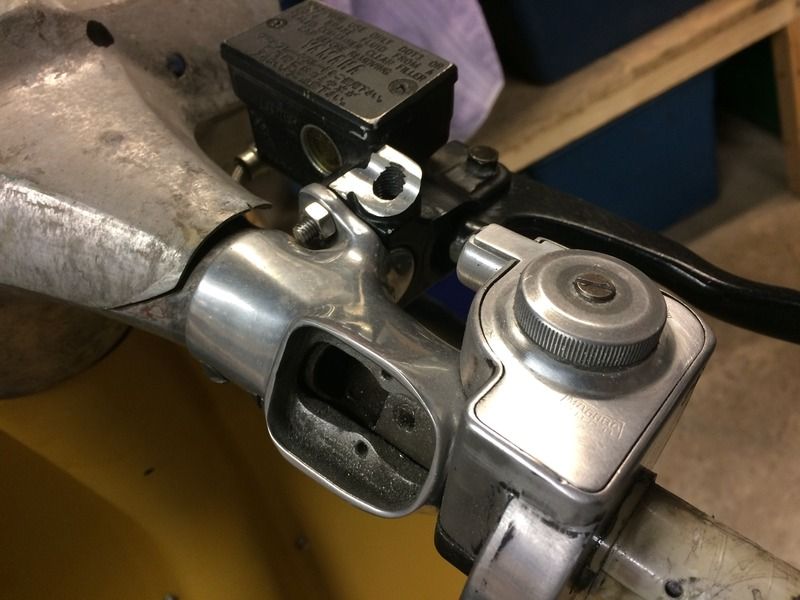

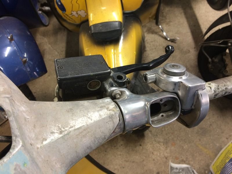

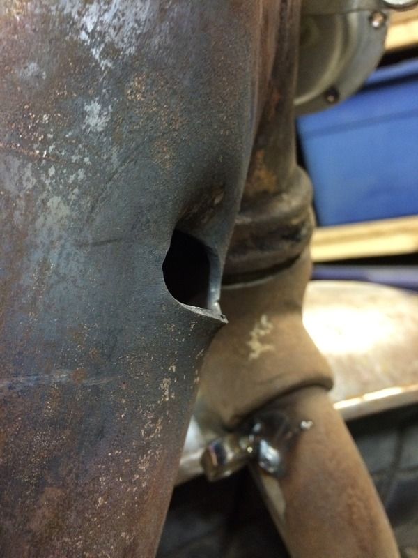

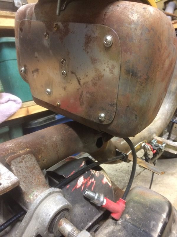

Stripped QA and noticed master cylinder mirror housing directly in cable route
Dremel out. Sorted.

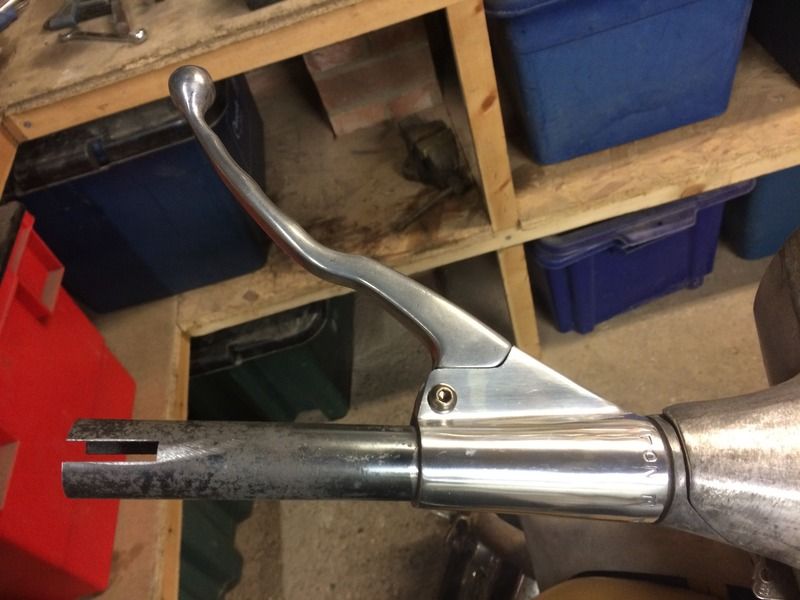

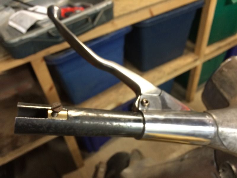

Back to gearchange side for Yam clutch lever fitting to match brake

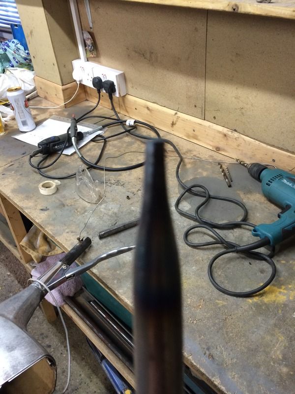

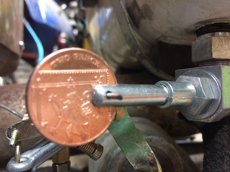

Fitted MB stainless rod and QA gear wheel, don't know how effective it will be mind. Had to Dremel bout 20mm out of gear housing slot to get brass bush to sit in correct position to allow gear wheel to line up with cable slots. See above.

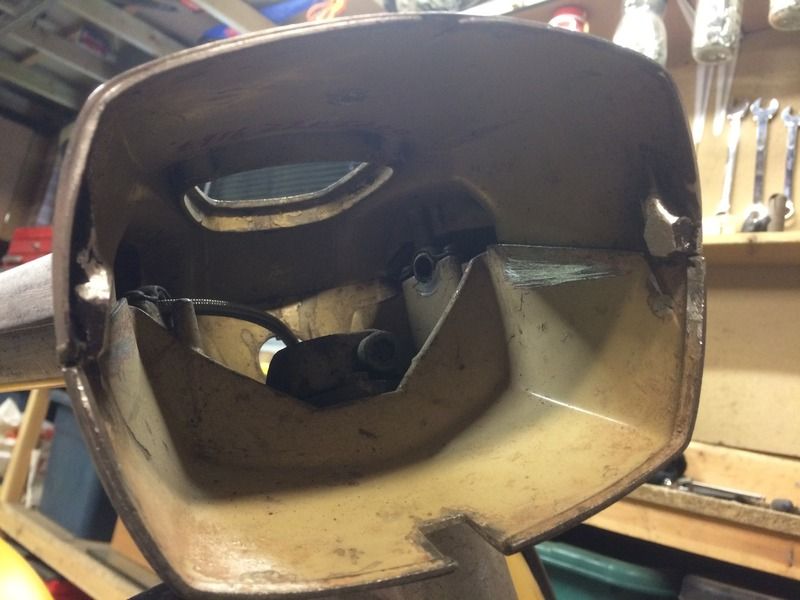

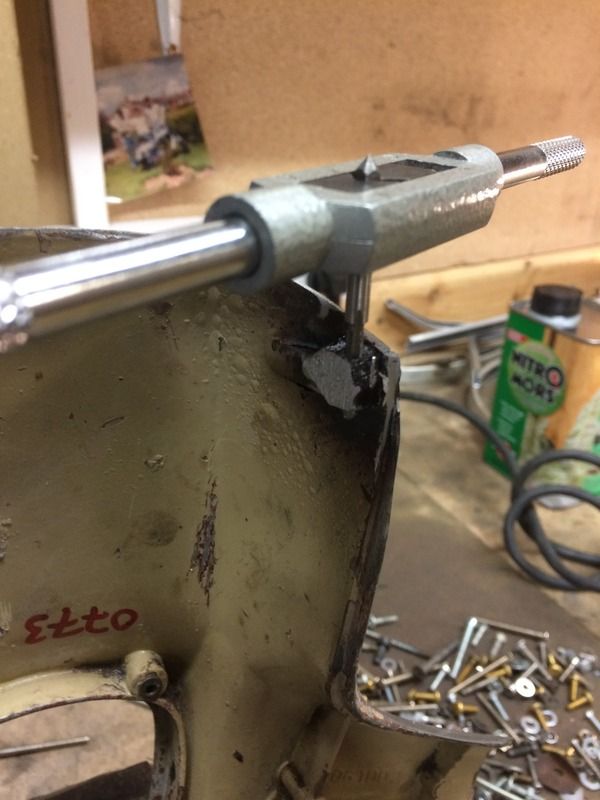

Headset top rim threads were knacked so got a blob of ally done and retapped.

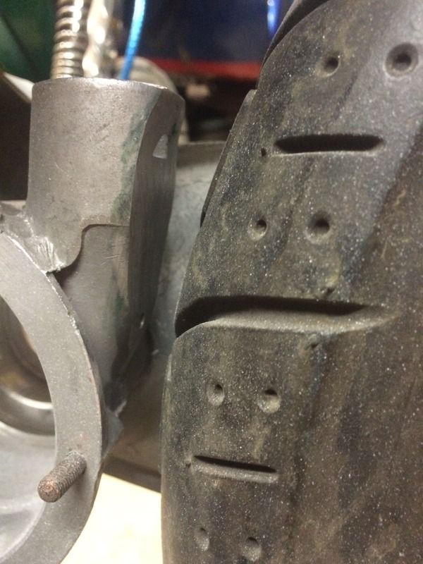

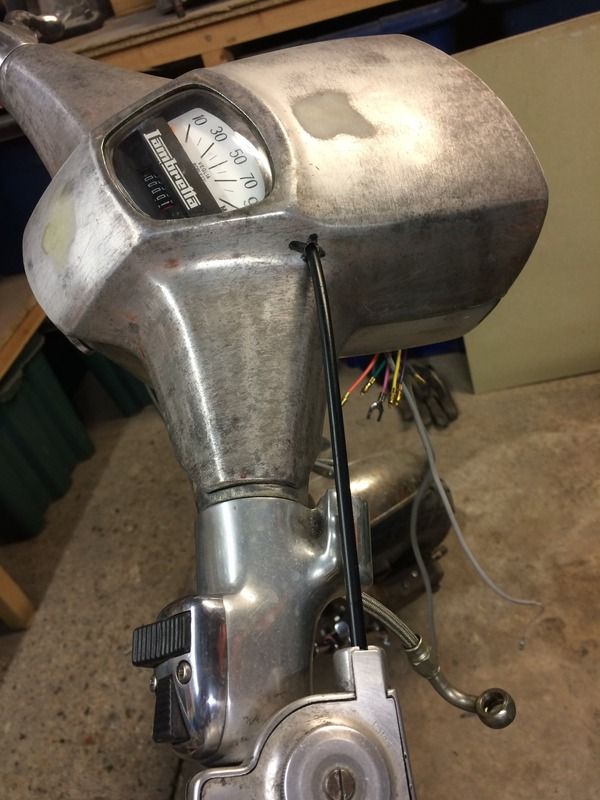

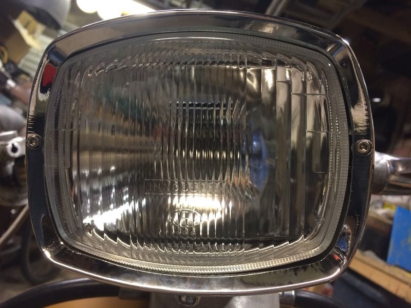

It's an early Indian headset so still Italian styled. Bought a new Scootopia GP headlight unit from Corrado but the rim was a mile out, headset fault, not rim. Files out for more fettling.
Bingo. Bit more tweaking req'd, not perfect on the bottom edge but getting there

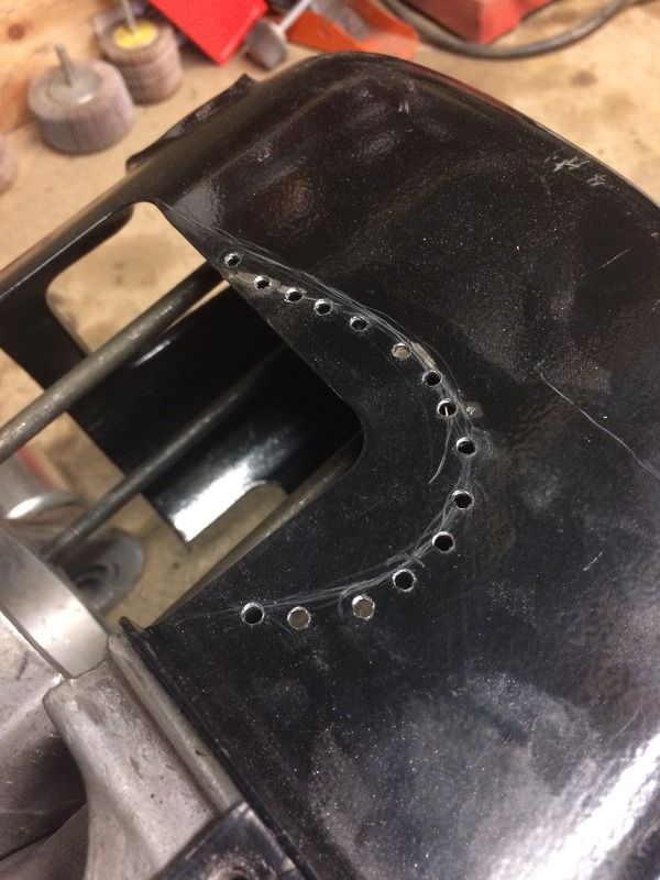

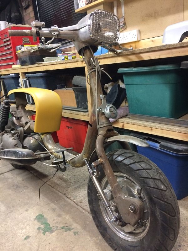

More dry building....

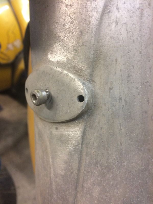

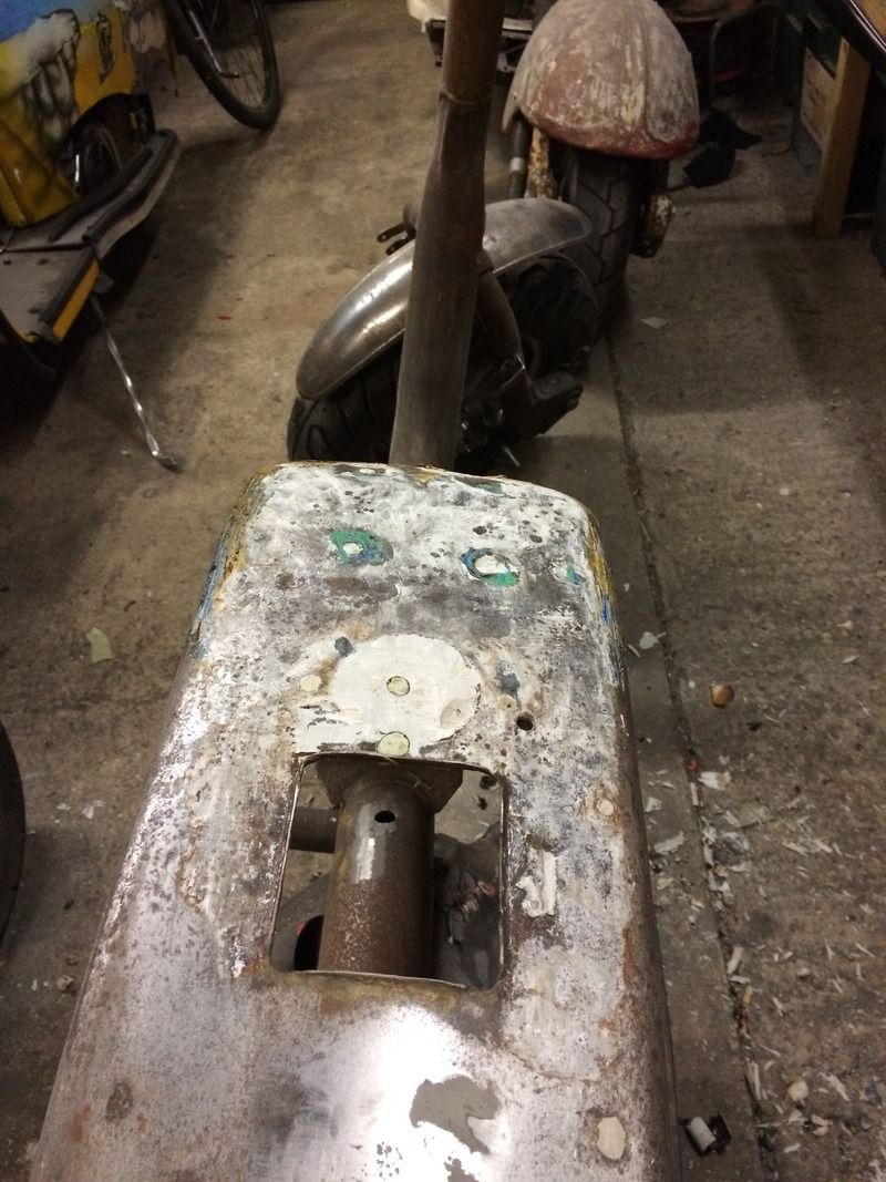

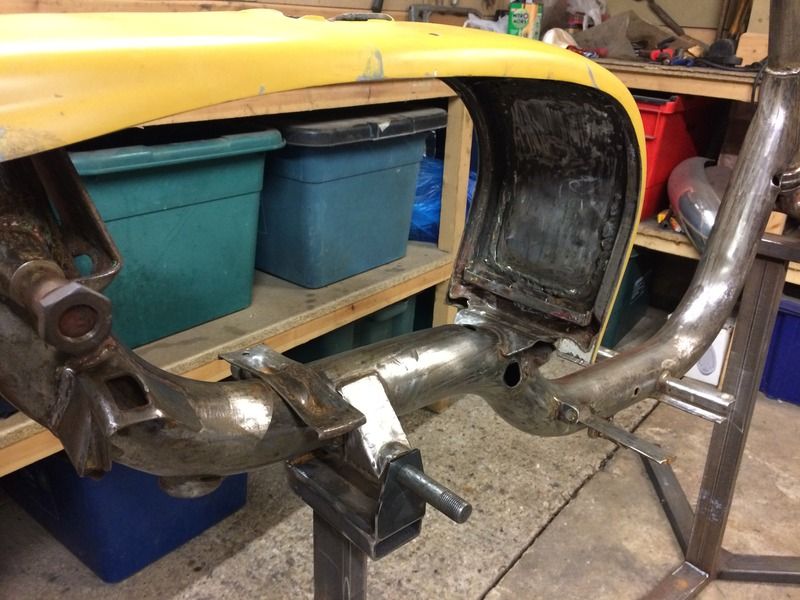

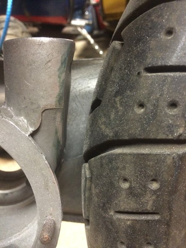

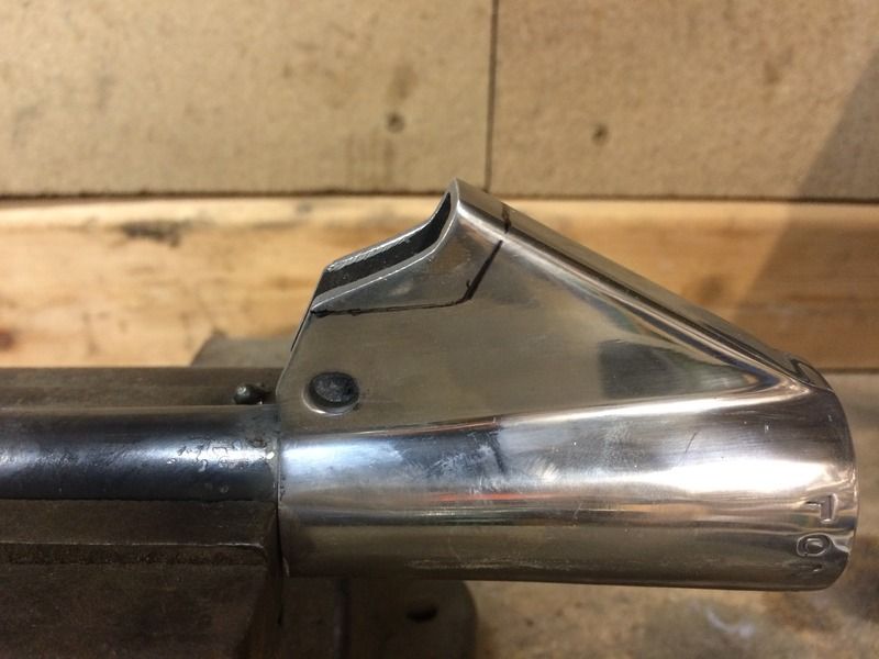

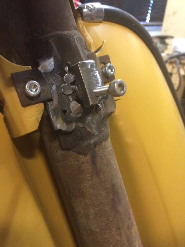

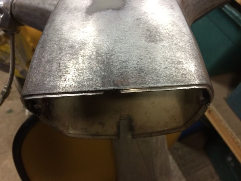

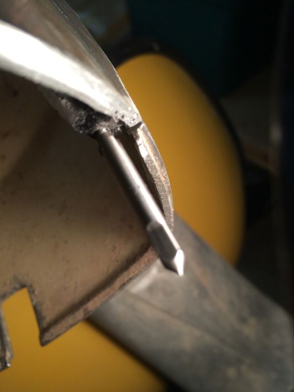

Horncase mounting as top lugs been cut off for shortened steering column. Welds to tidy.

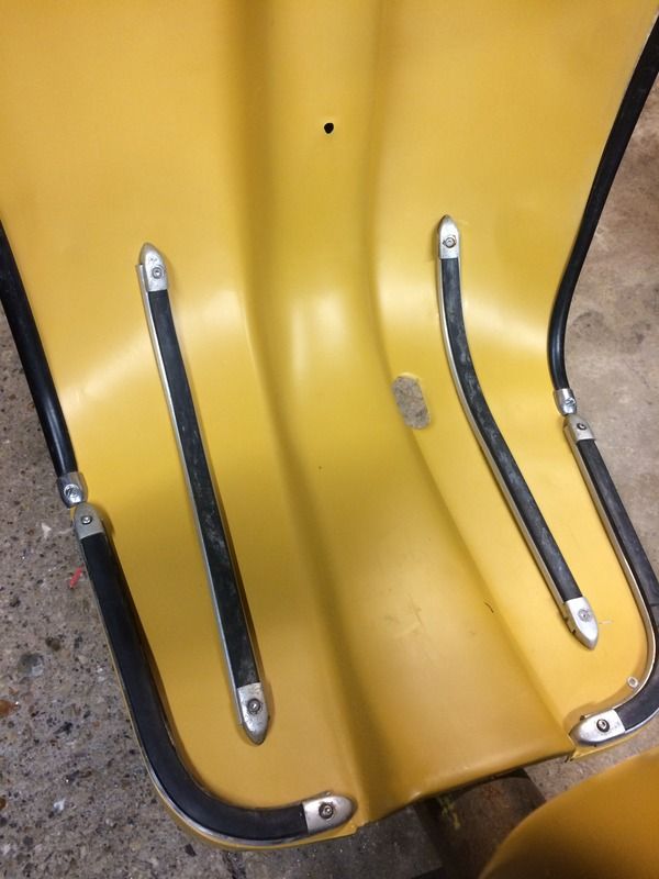

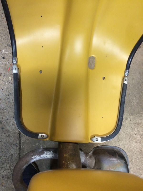

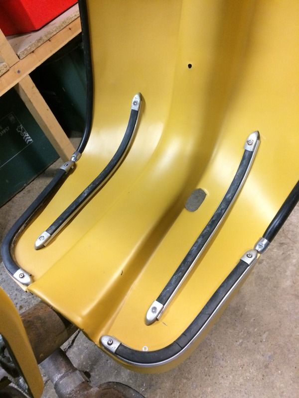

Floor runner Mock ups and drilling using Vep runners, not an exact fit on the leggy curves.

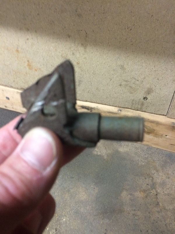

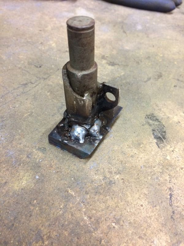

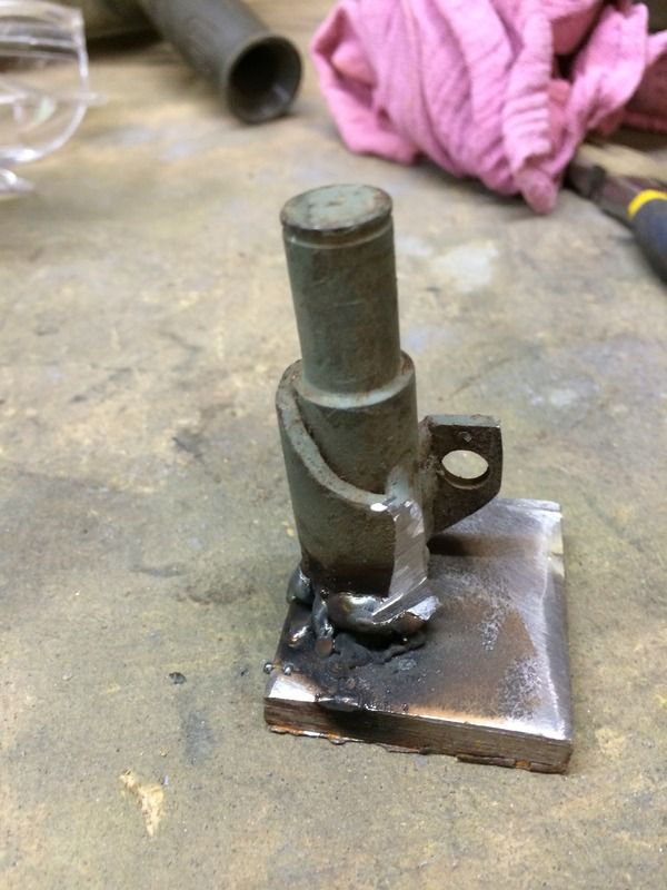

Rear brake pin had previously been removed for racer styling, got given one off a mate but was a bit mullered

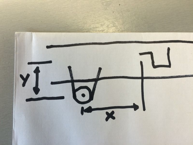

Needed some dimensions, which I got off BLA Nobbly

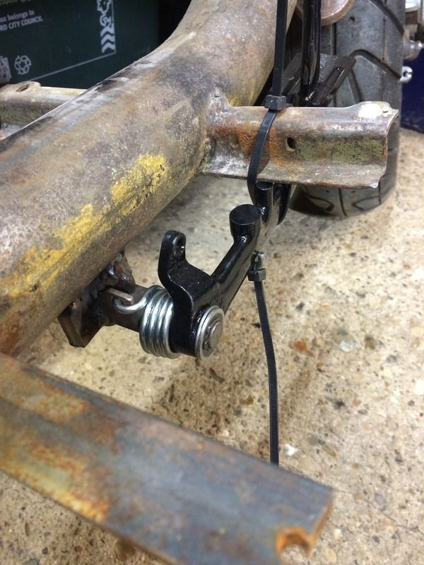

Brake pedal mounted

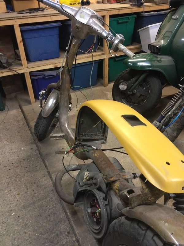

Postby LateAgain » Mon Jul 18, 2016 3:30 pm
Bit more dry building... all welds to be tidied later!!!
Hydraulic hose guides

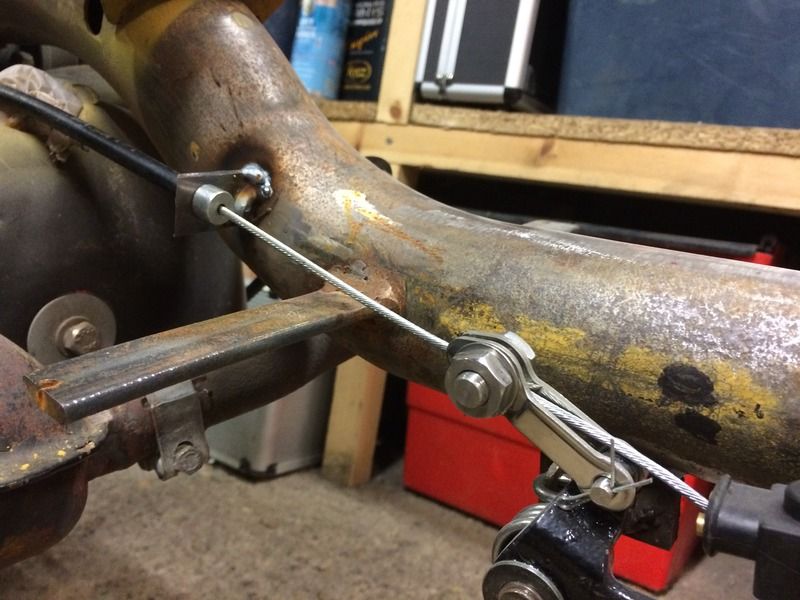

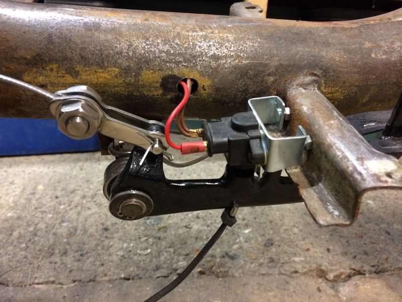

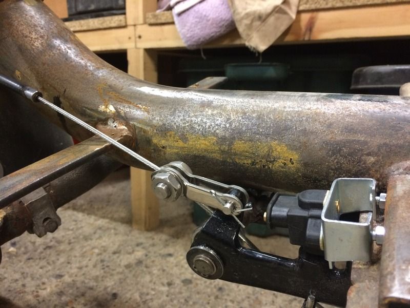

QA throttle cable

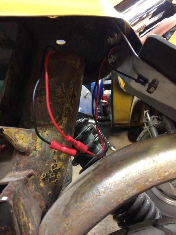

Sorting out the loom

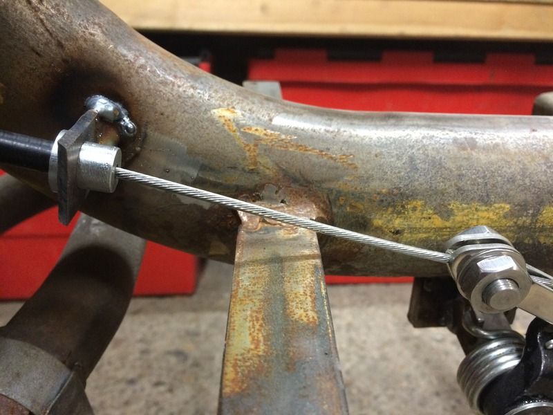

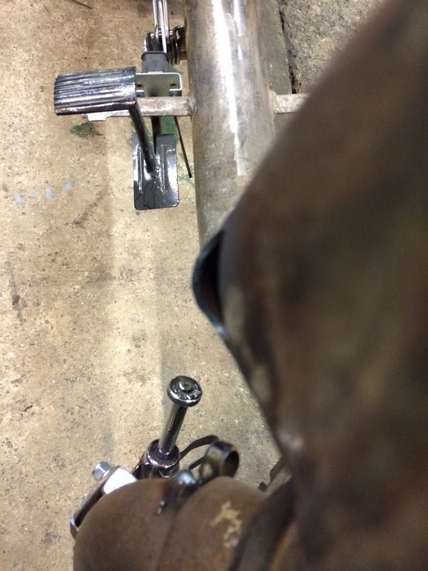

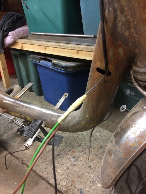

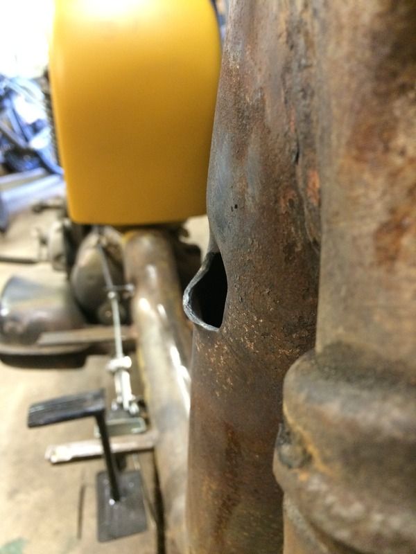

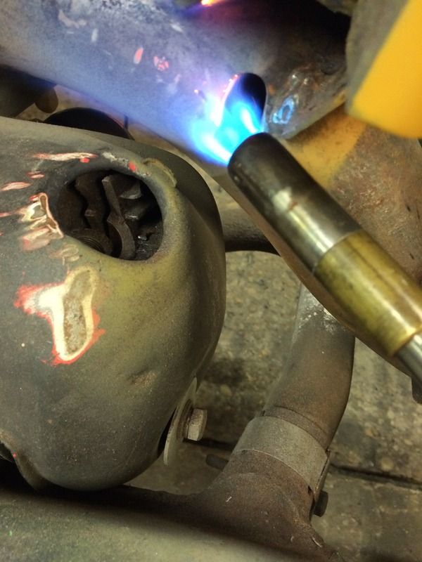

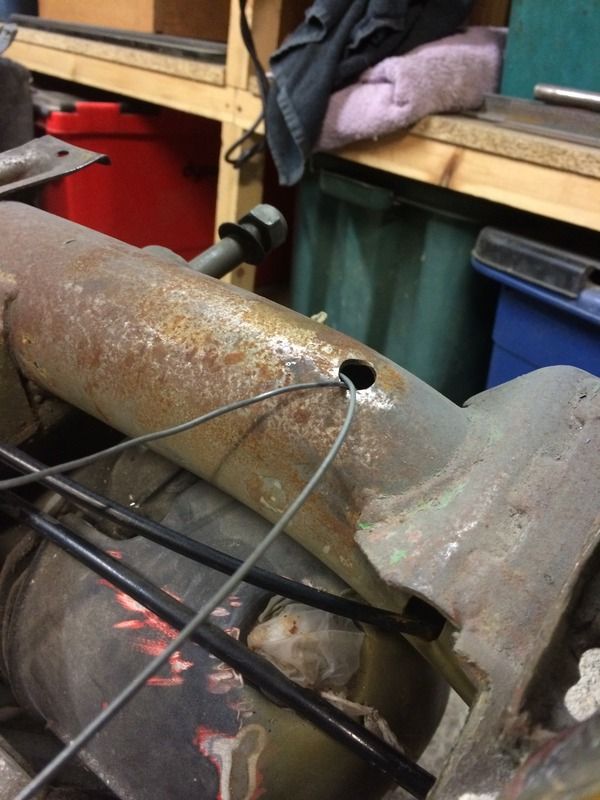

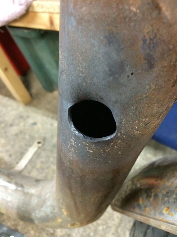

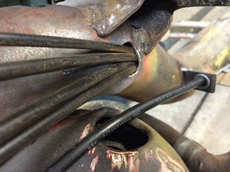

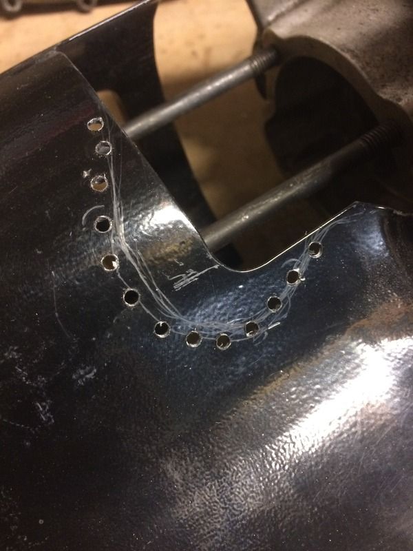

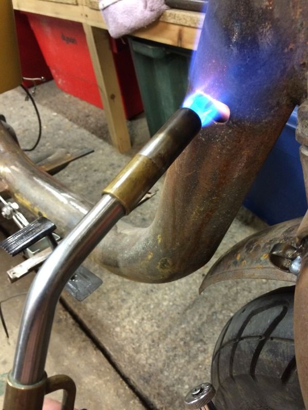

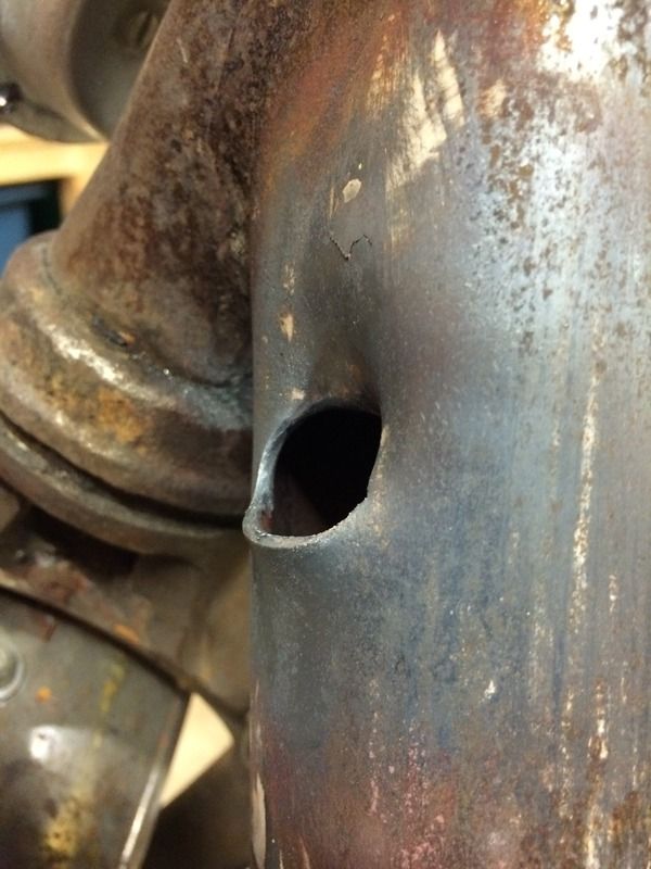

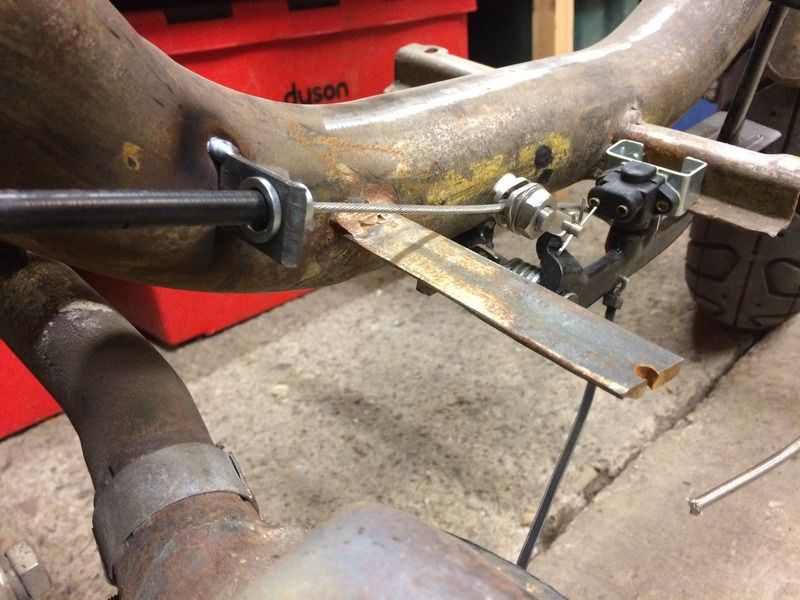

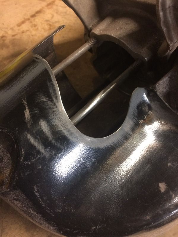

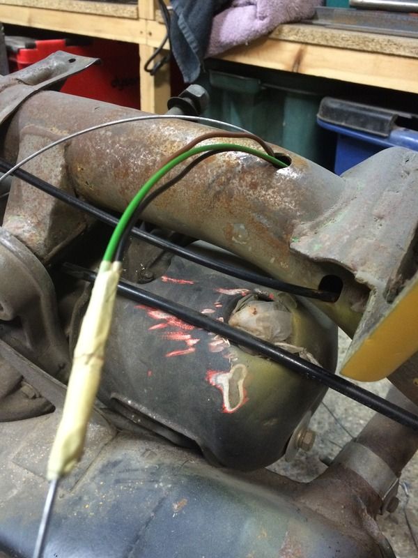

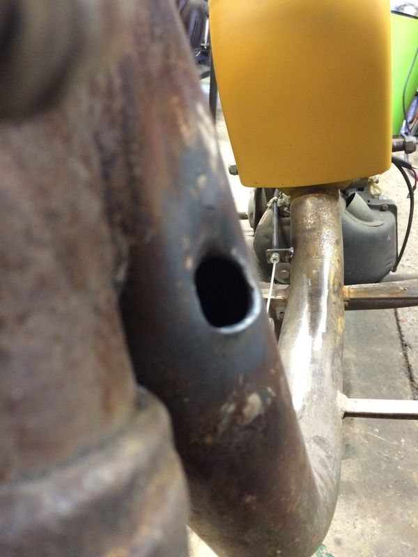

When I offered up the outer cables to check for routings, I wasn't happy with the way they entered and exited the frame,
the angles were too tight on the slots I had created. Out with a torch and some round bar...
Bingo.

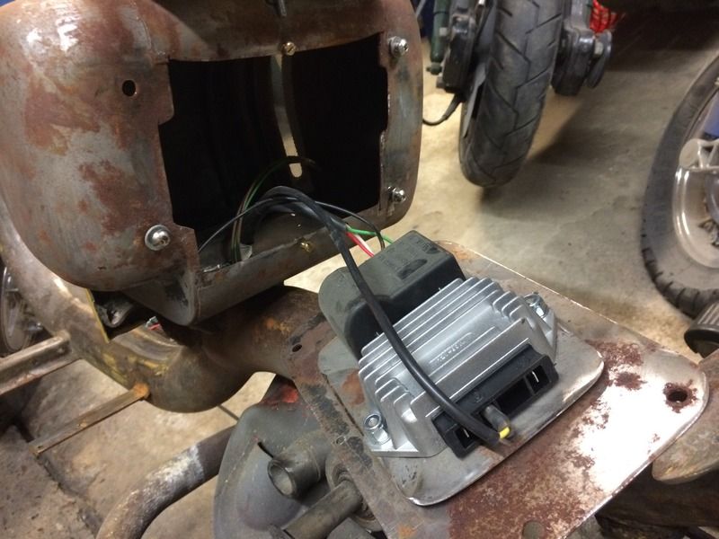

Not a lot to report lately.

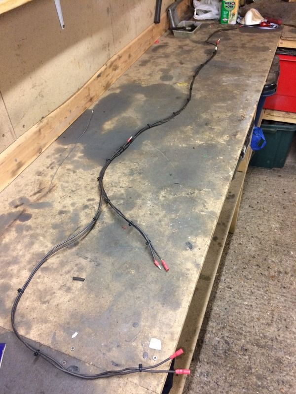

Wiring all in place but not sleeved yet to make a loom. Not quite sure how to go about that yet.

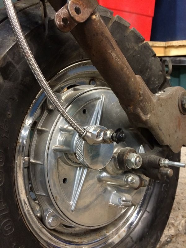

Rigged up front hydraulic
Old skool

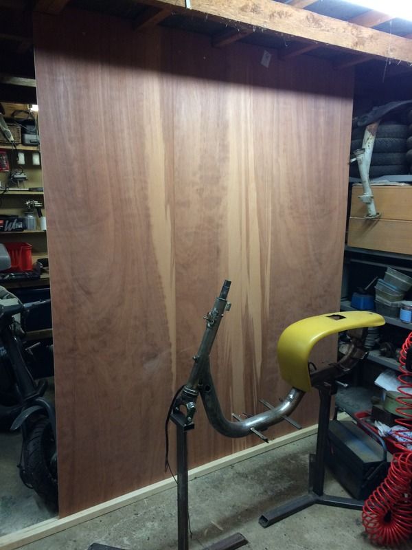

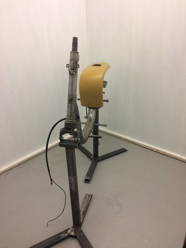

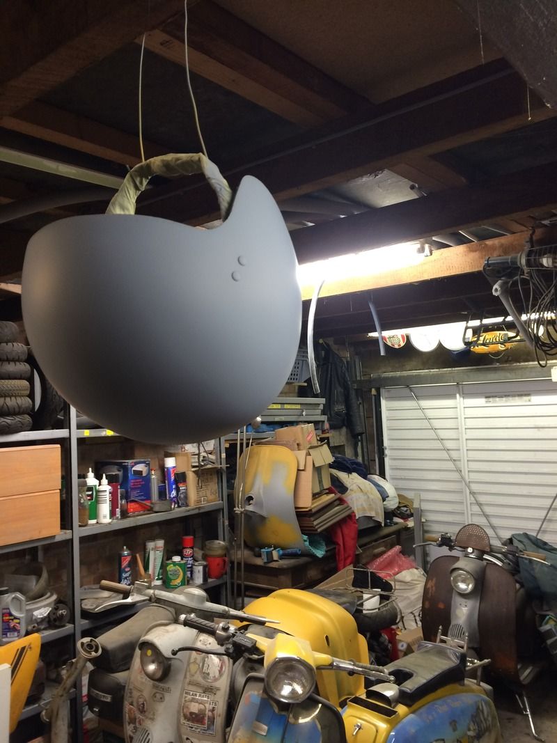

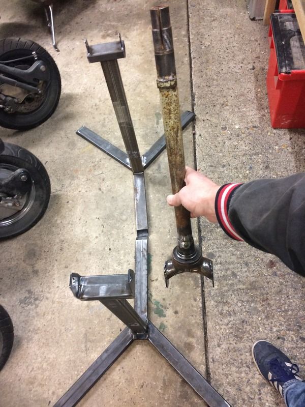

Had a stand made to aid spraying, no contact points on frame

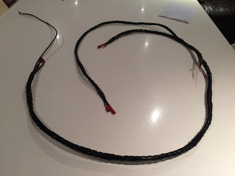

Wiring loom made

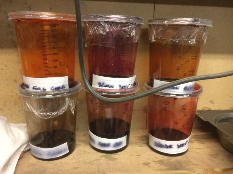

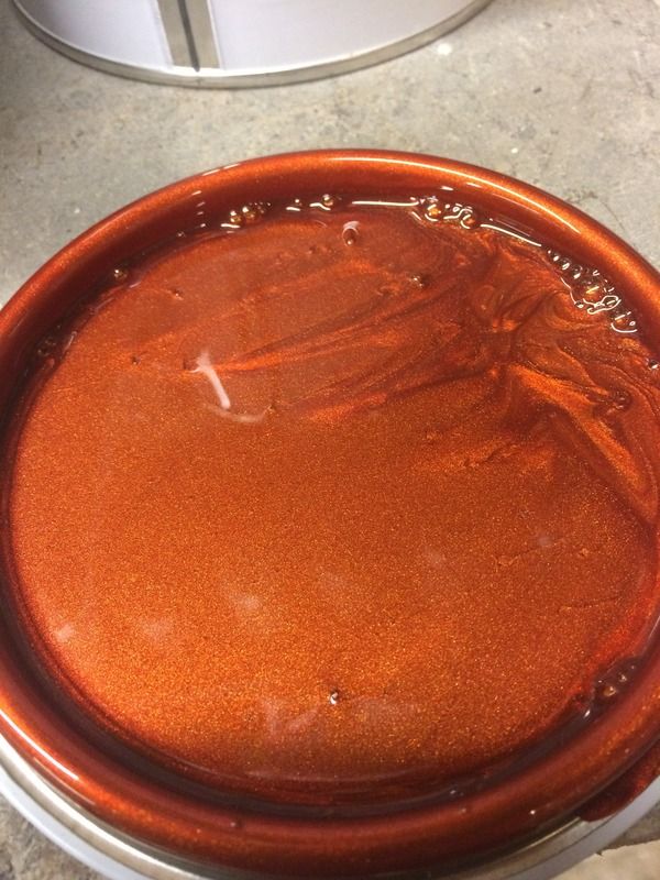

Sussing out and mixing 4 base candy colours

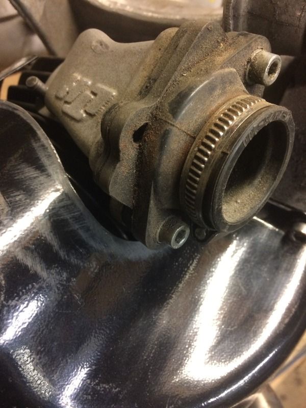

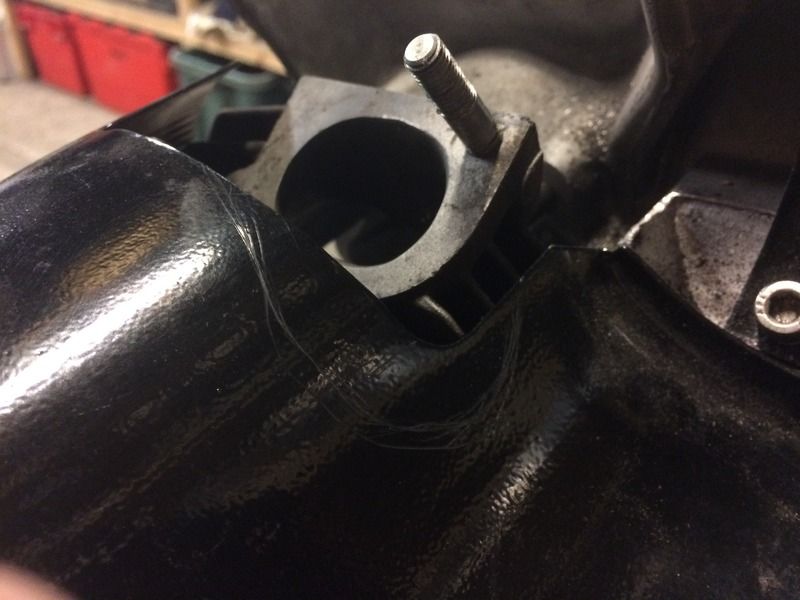

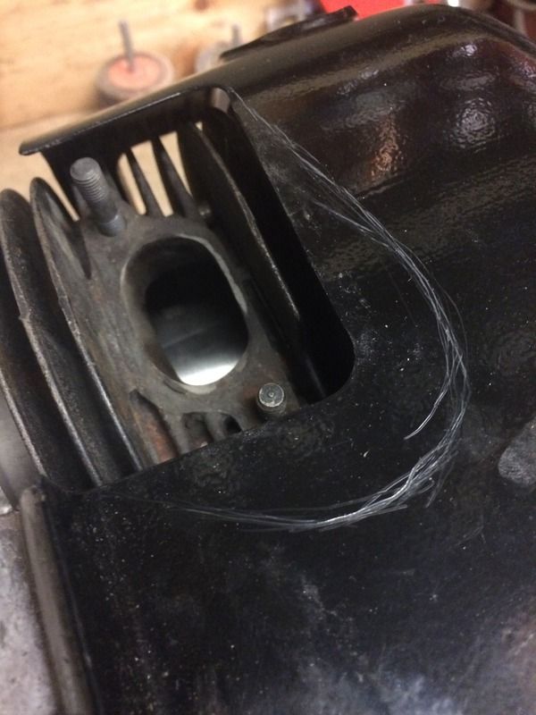

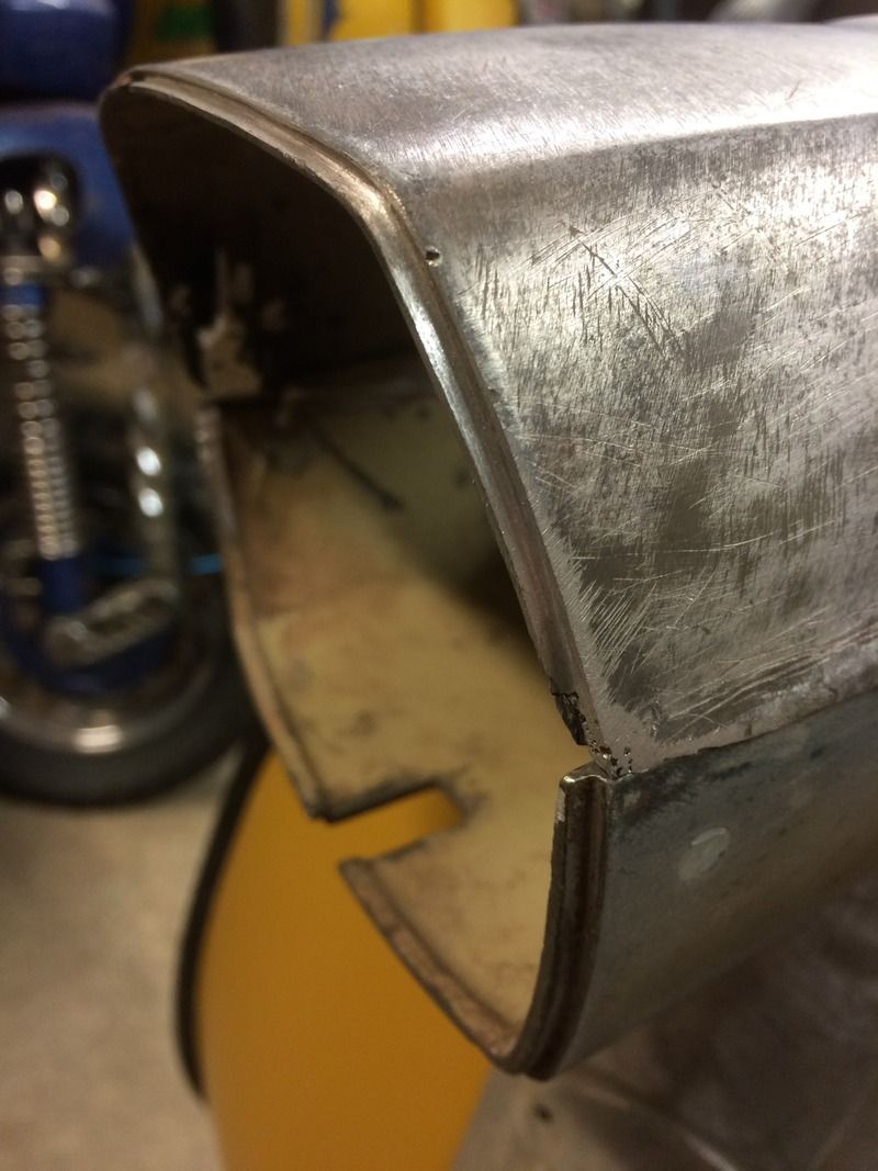

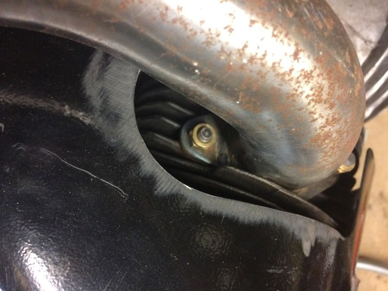

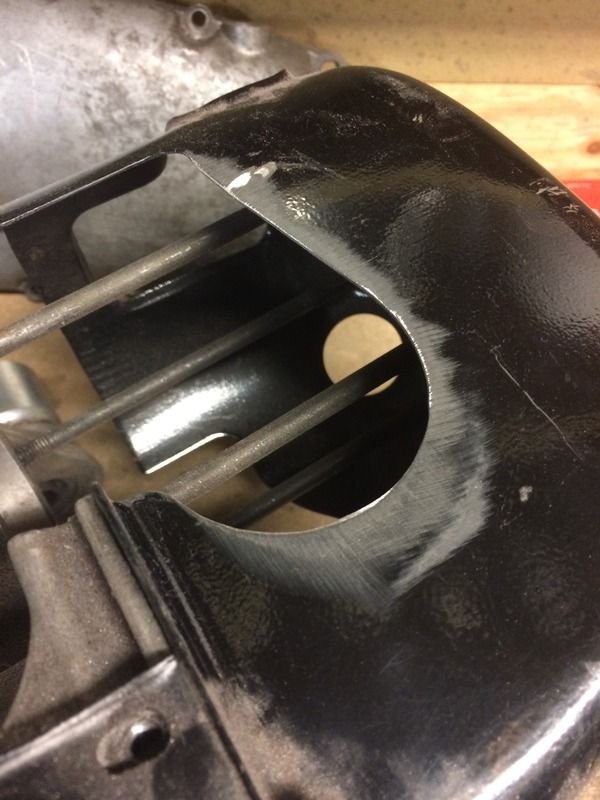

Trimming cowlings for (the b*stard) exhaust nut and Reed valve

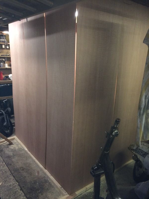

Building a spray booth in the garage
Getting ready for spraying and it's -4'C outside.
