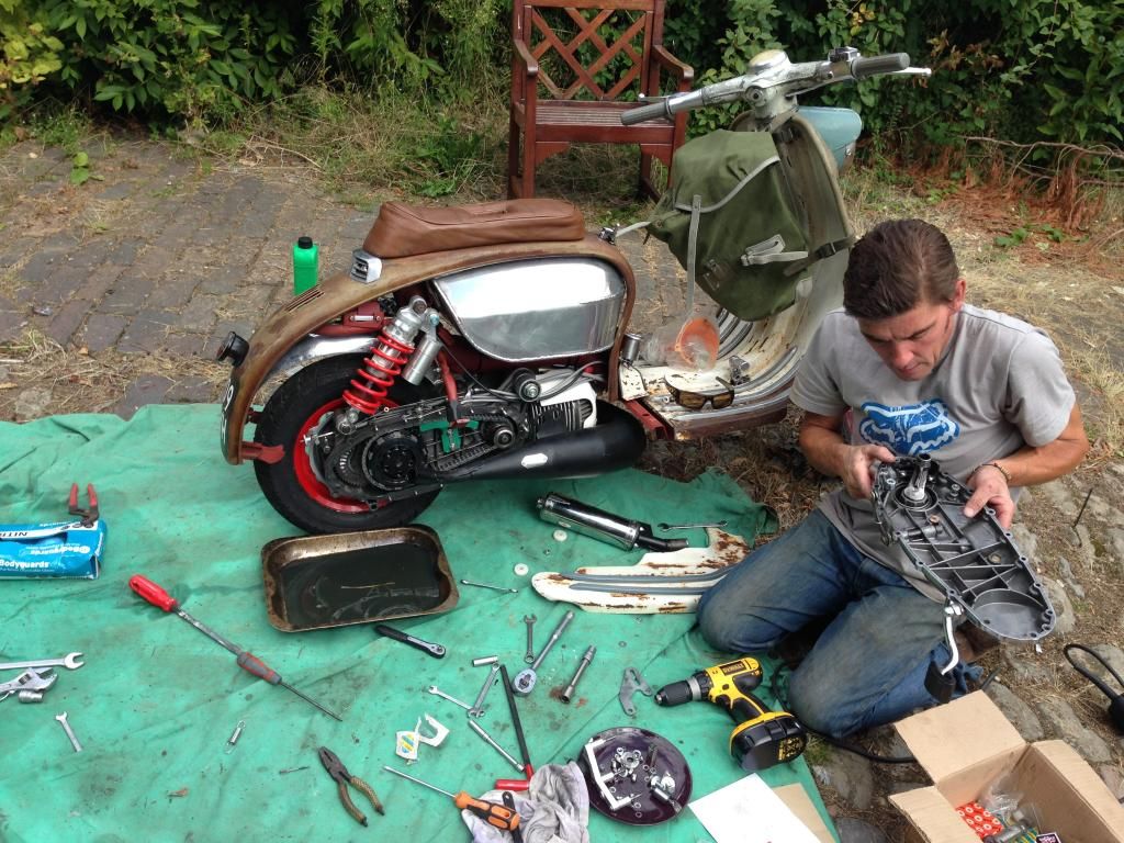

So me n lateagain were already for iow but smurf was seriously leaving it till the last min so after some late nights working on his fatty ( one 4am ) It all came down to the night before.......
Unfortunately the mext mornin (Friday) the kickstart piston went as we were leavin!!.... So had to strip the fecker before the off!

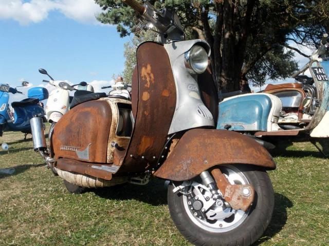

Ready to roll!... Zero miles on smurfs fatty ... Running in and actually still building it on the way there!!!

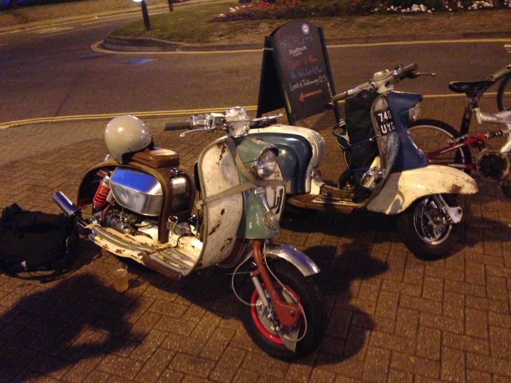

So just made it to the island before closing time!.. Stopping at the king lud on see front for a cheeky one...
The day after on the green
Lateagain turns up on the Saturday mornin with the rest of the roadrunners

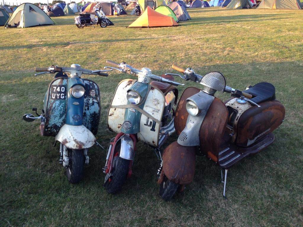

And the fat boy three are all finished and mission completed.....
Smallbrook campsite
Friggin excellent weekend!! And We even made scootering mag!

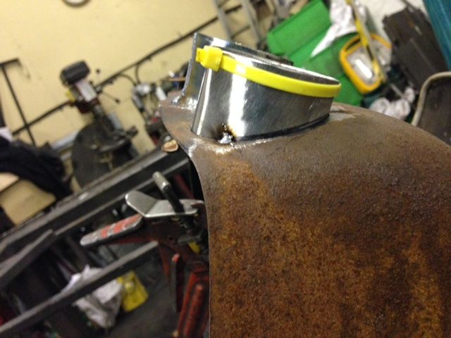

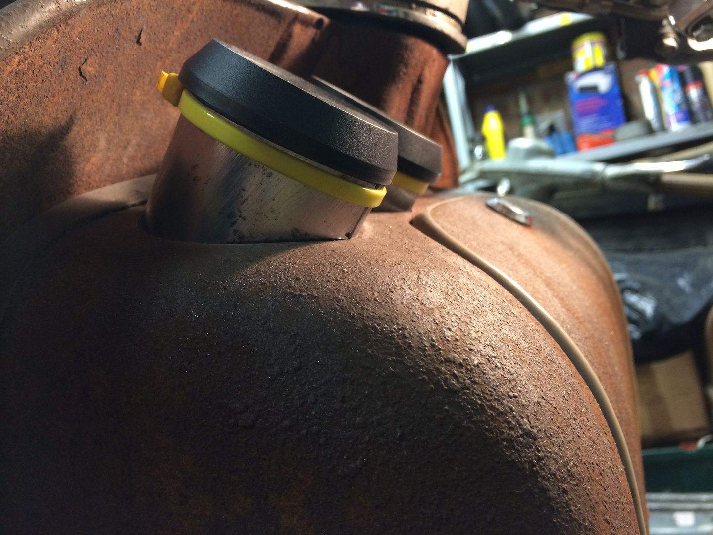

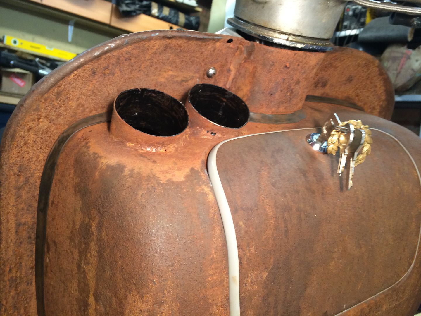

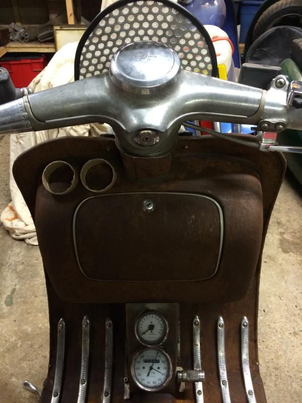

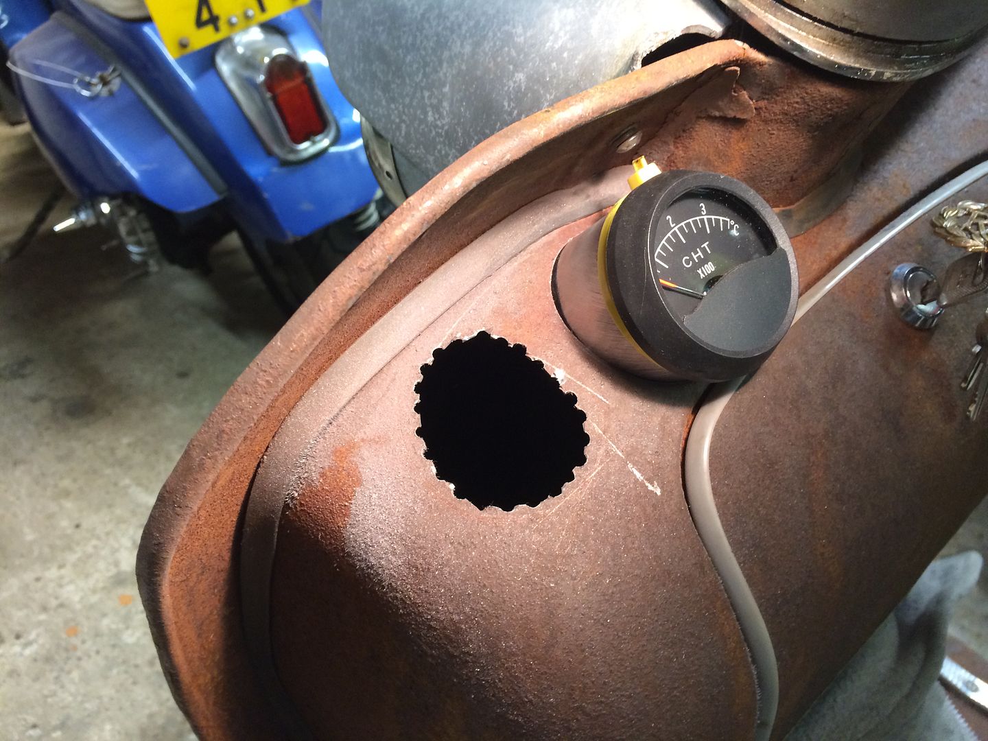

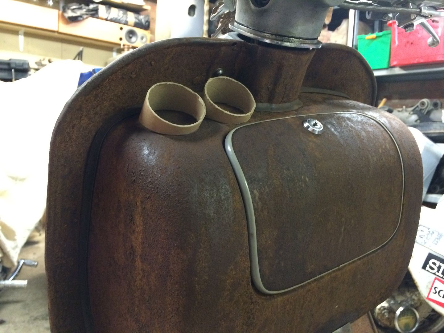

Russian roulette fuel stops and Nobby's piston holing on a bullet-proof MB TS225 tune sent me in an EGT and CHT gauge direction... overkill maybe but gave me something to do once the kids were in bed.

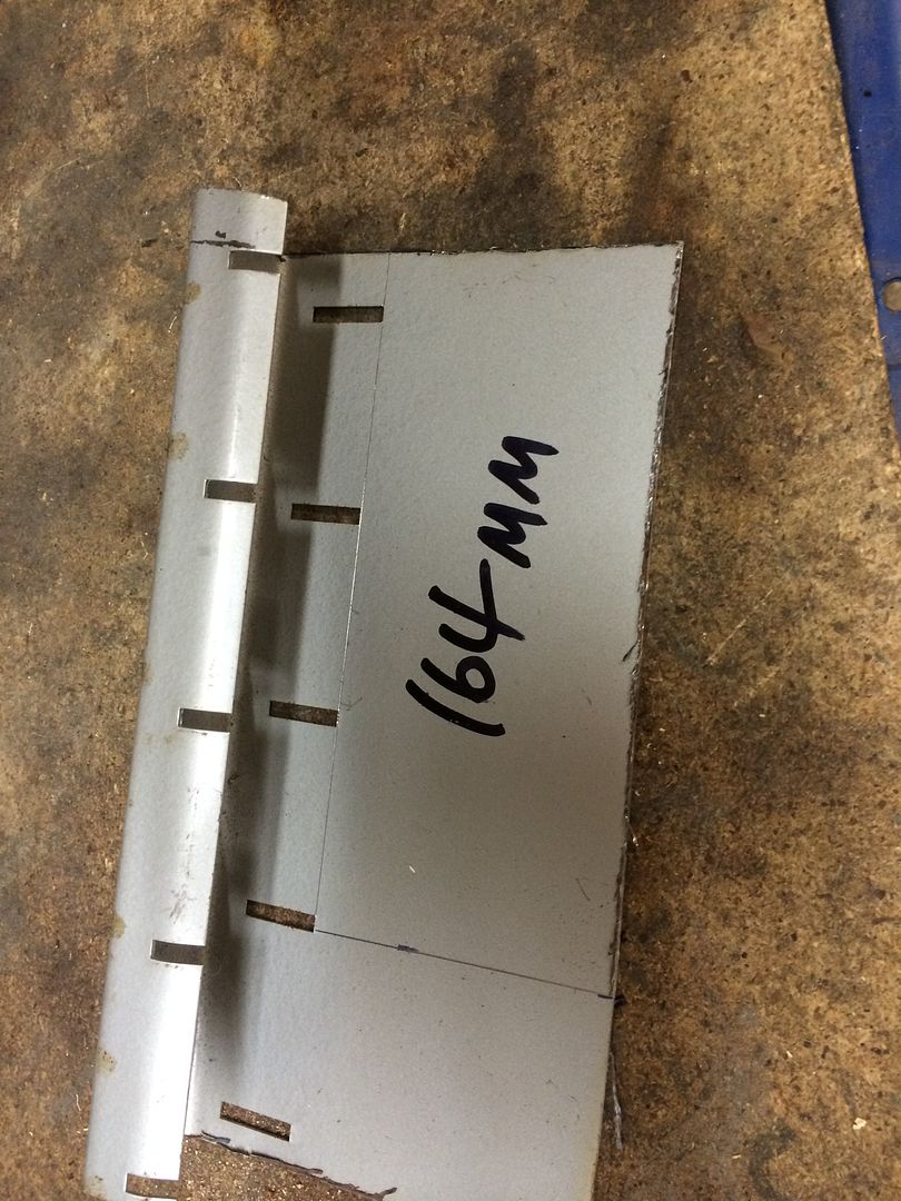

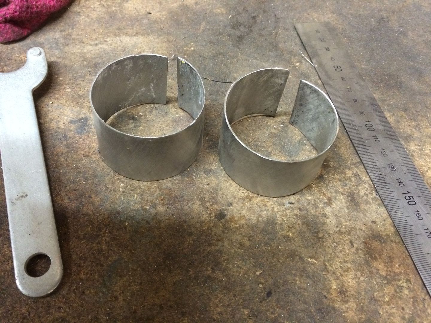

Dug out some racking and worked out necessary circumference for the Skydrive gauges
Cut and formed round a scaffold tube

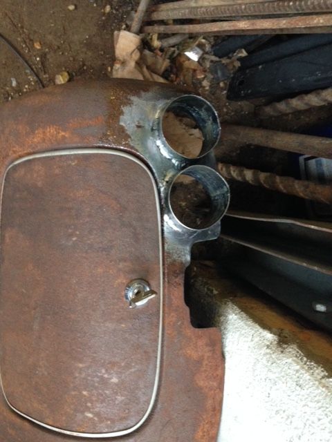

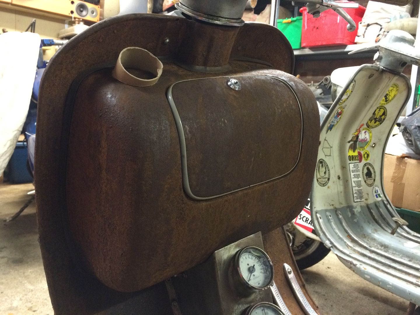

Sussing out positioning, cut some cardboard tubes out to mock up

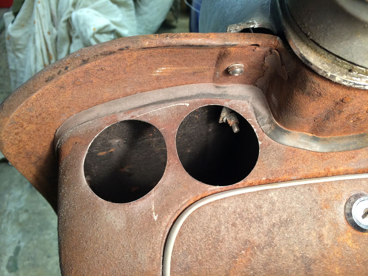

Decided on two on the left hand side

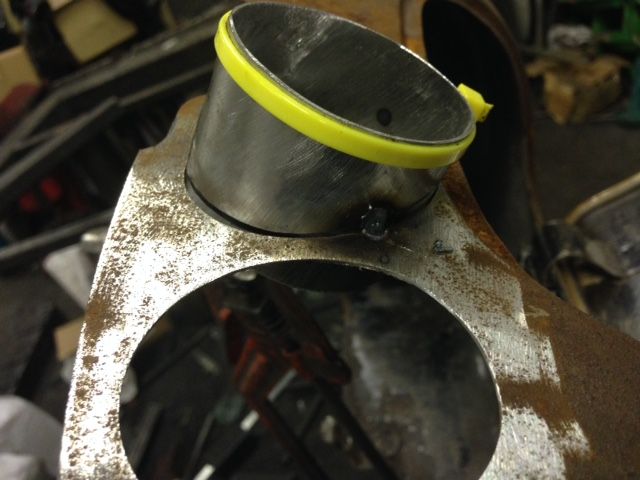

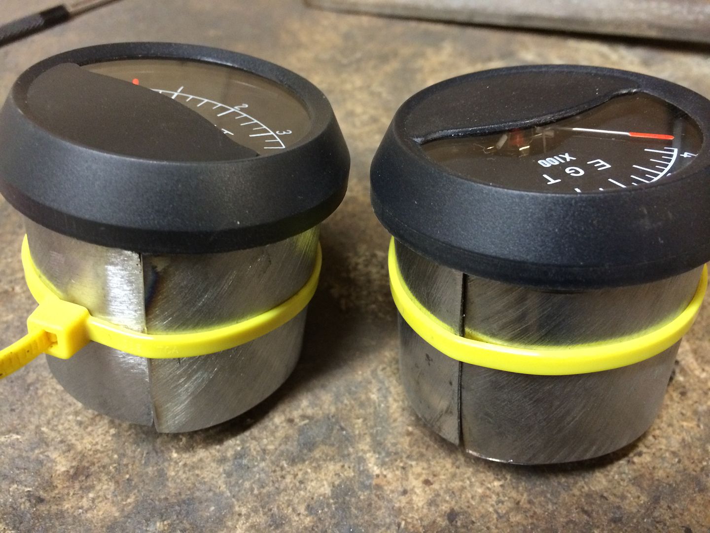

Cable tied tubes round gauges

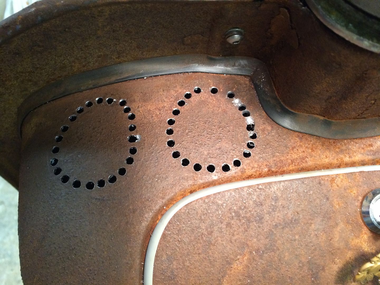

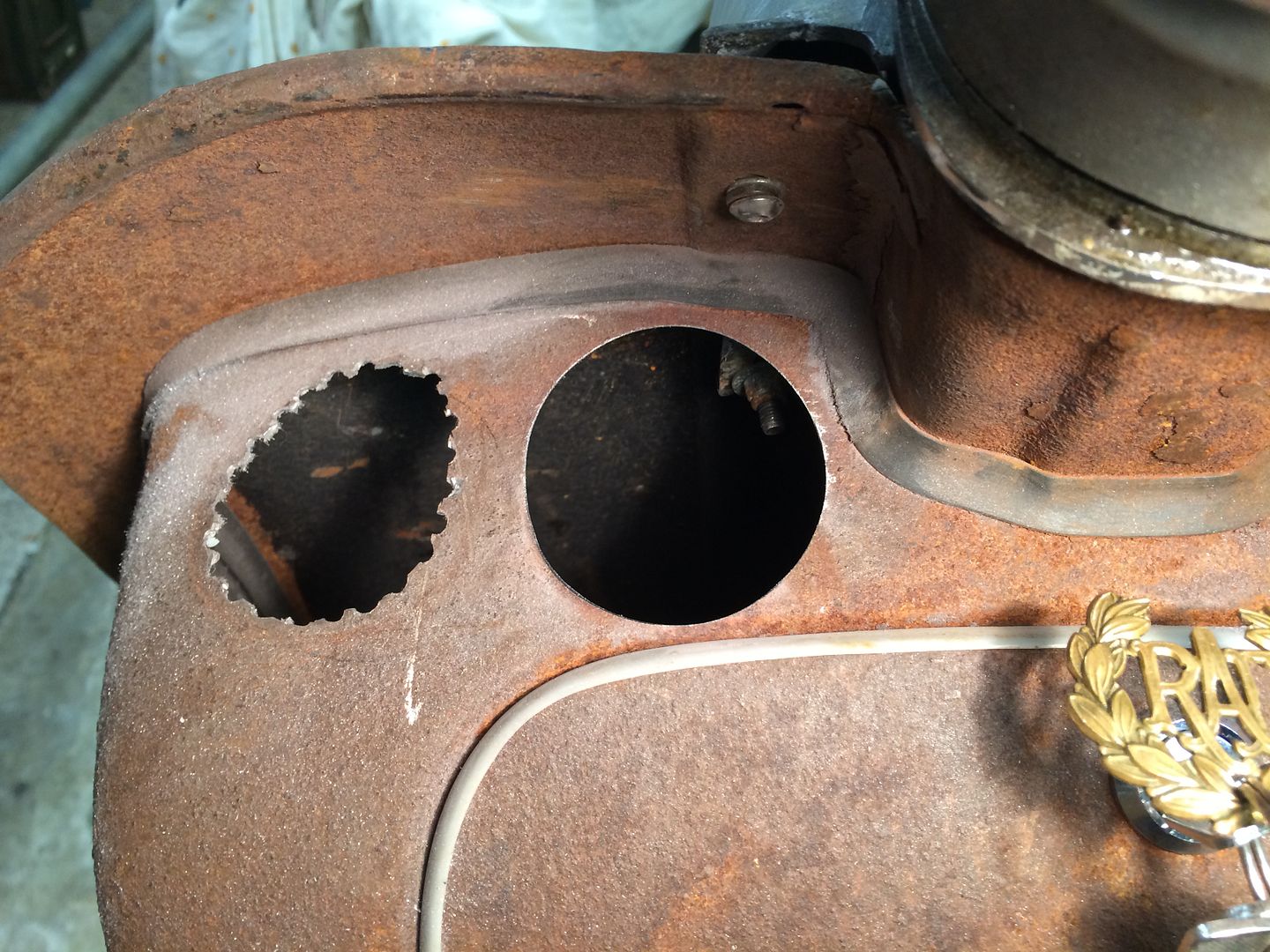

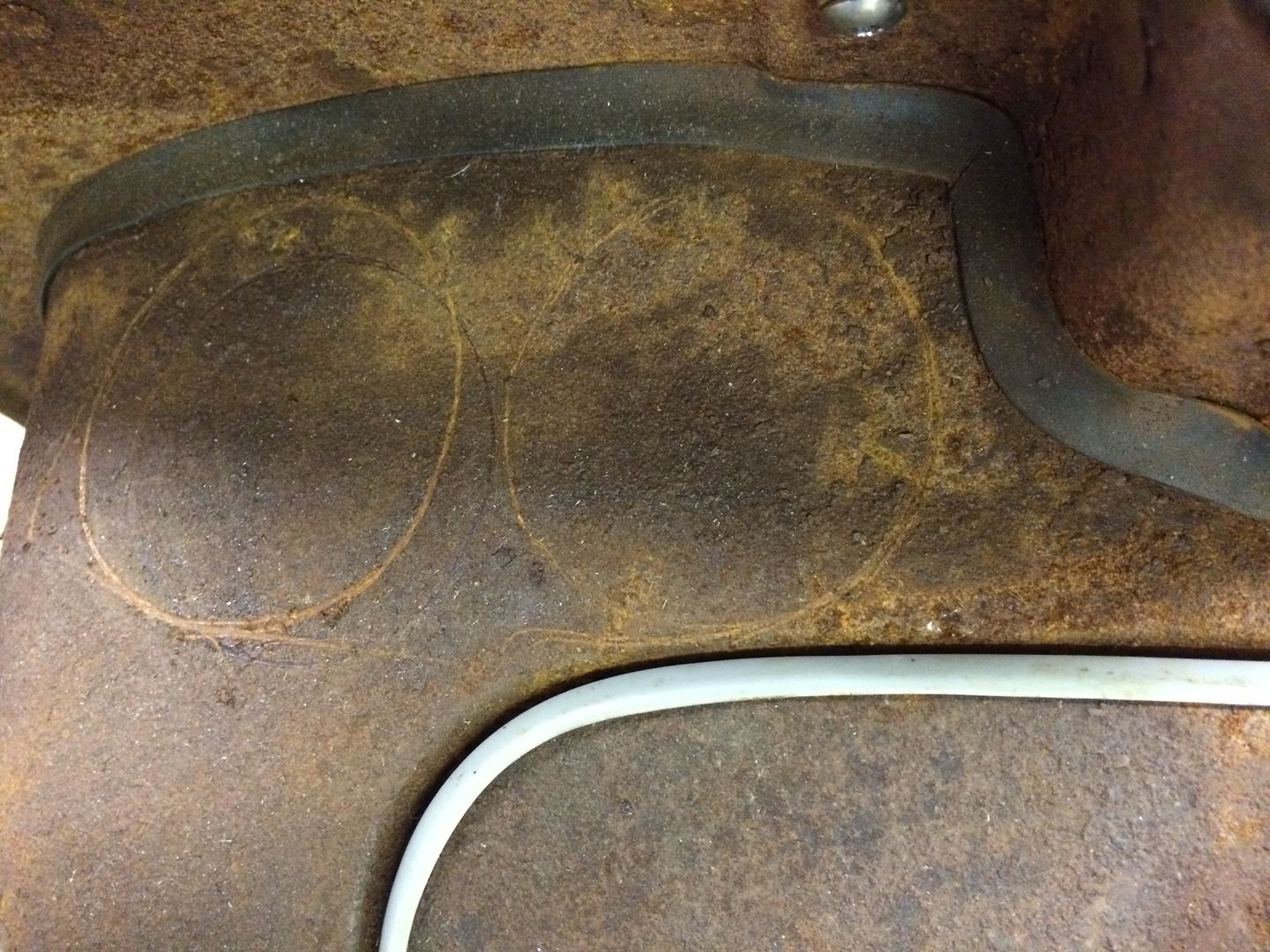

Scribed

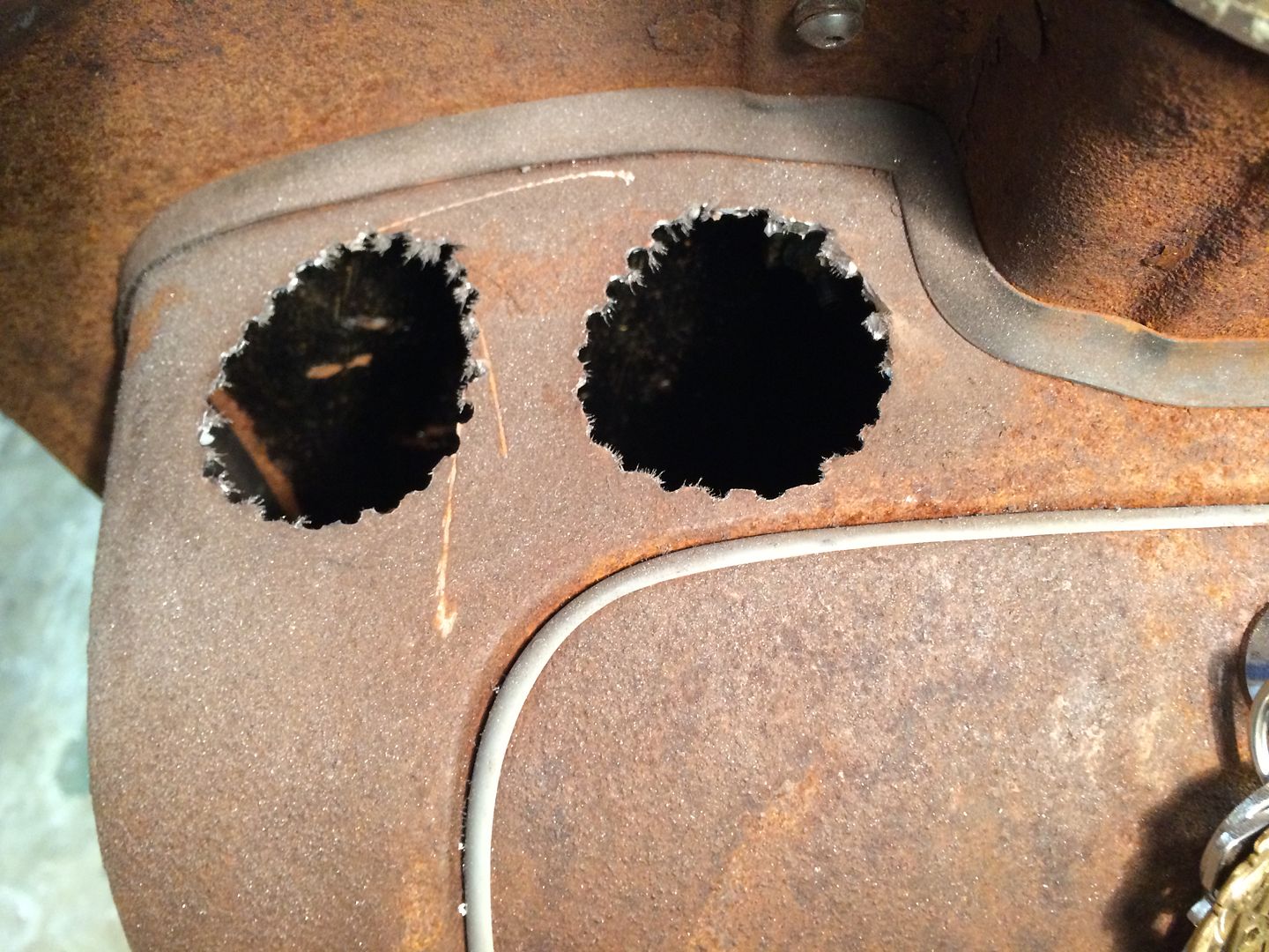

Chain drilled
Butchered...
Tidied up
Angle of the dangle check

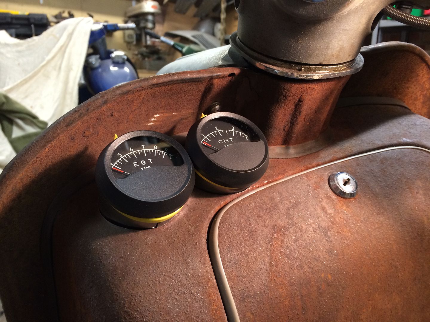

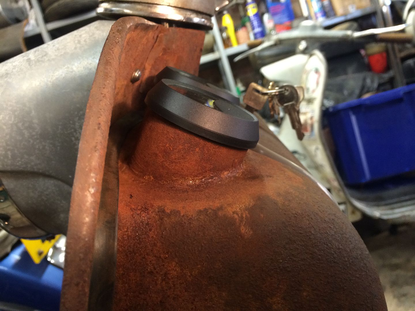

Next one tidied...

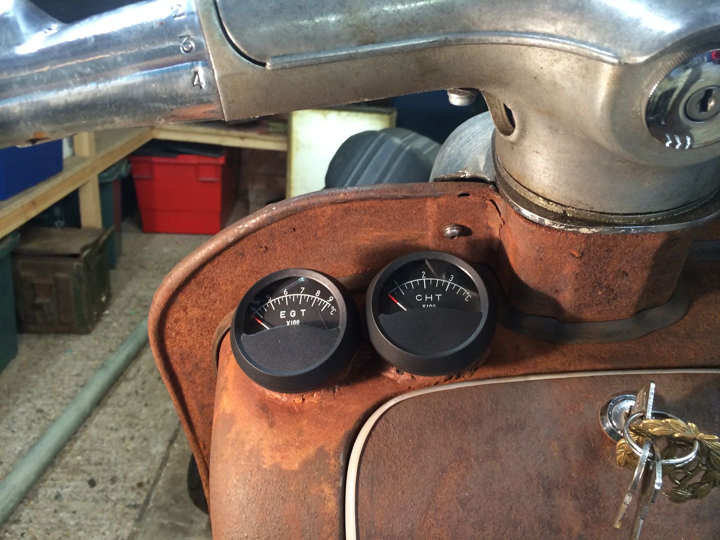

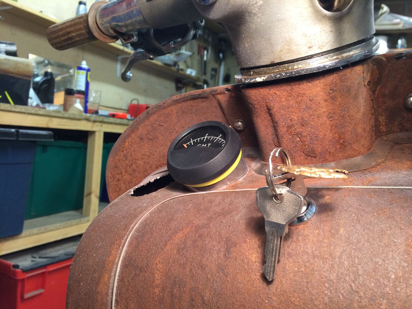

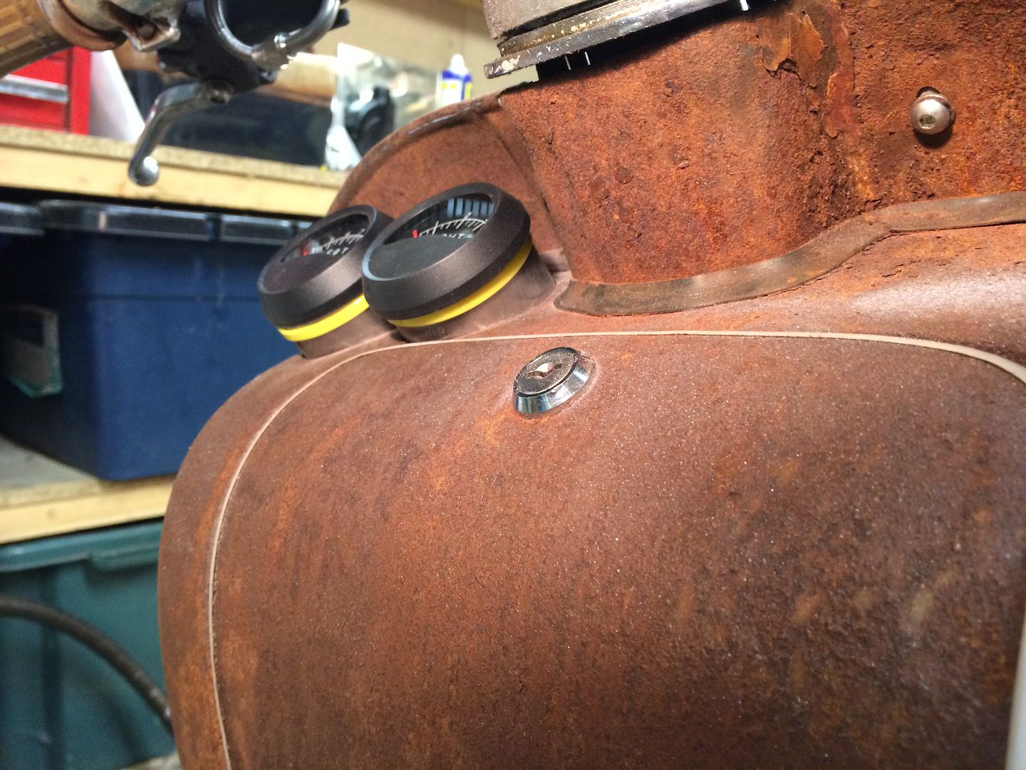

Clocks in...
Off to Nobby for fab fabbing skills
Bit of Fat Boy 3 Death Juice rusty starter applied
Clocks mounted. Bingo.
TBC...
