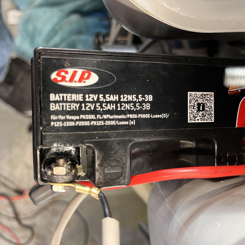

My Series 2 with indicators has a 12v SIP battery. The positive terminal has two connectors one for the indicators and the other to the loom. The negative is, of course, just to earth.
I have charged the battery up and I am now getting 12.39 volts showing on a multimeter between the positive and negative. I won’t be using the scooter for the next month, or so. I am planning to just measure the voltage every few days to see how much charge it loses.
Is 12.39 volts acceptable and how much should an unused battery (but one that is wired up on the scooter) lose over the next month?

I have been monitoring this battery and the other two Batteries I have on other Lambrettas. This battery was down to 9v in a week, or so, whereas the other two I have have stayed at around 12 or 13v. Given that neither of my other DC battery Lambrettas have indicators, I suspect the indicator system, possibly the flasher unit, is draining it.
I have bought one of the CTEK battery chargers, as recommended by Jonoy. These chargers have a function to analyse the battery itself and whether it is capable of holding charge. It shows that this SIP battery is okay.
So, when this scooter is not in regular use, I’ll continue to keep the CTEK connected.

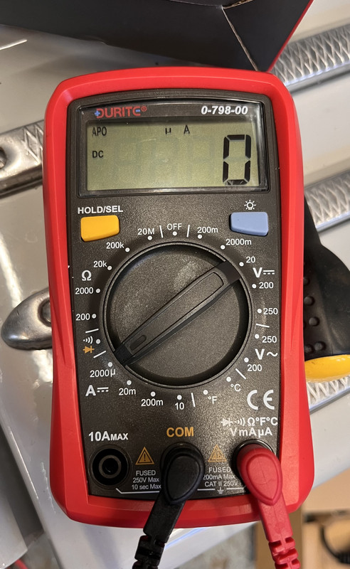

Here is the battery and the setting I used on the Multimeter. I put the red of the multimeter to the negative of the battery (earth cable disconnected) and the black to the earth cable. I kept that connection for a couple of minutes but got no reading. The battery is charged up. Would that affect whether I get a reading, or not?
At some point when I was messing around with the multimeter I did get a reading of “1” between the battery earth and the chassis but when I tried to replicate this later, I got no reading.

Just as a belt and braces excercise...... Move your red lead to the (10Amax) hole and select the 10A scale on the rotary dial.
If you've messed up somehow, then you may have blown the internal fuse inside the multimeter that protects the milliamp/microamp scales (200mA). The 10amp scale has a separate fuse internally.(10A)
The reading of "1" that you got would suggest that you measured a current that exceeded the scale range. When measuring an unknown current always start with the highest scale and then work down from there if necessary to avoid damaging the meter.

OK this is very approximate engineering, but works to explain.
You have 5.5Ah battery that has completely discharged in no more than a week.
A week is 168 hours.
5.5Ah divided by 168hours is 0.0327 or 33mA. If it were losing charge by leakage, then you would see it, especially as the initial current when fully charged would be higher.
Your battery is goosed.
Or your meter is VERY badly calibrated. I've never seen one as bad as that, so I doubt very much if your meter is at fault.

I have blown both fuses (the 10A/250v and the 0.2A/250v ) inside the multimeter :roll: I have ordered some more fuses.

Having inserted new fuses, I have today been trying to measure any current drain.
I put the multimeter red to the negative of the battery (using the mA socket) and the multimeter black to the earth connection on the frame, from the battery. I found:
With the flasher unit and indicator switch connected up, I was getting a reading of “2”
If I disconnected the wire that goes to the switch at the flasher unit, the reading was also “2”
At this point, I believe that this is telling me that the drain is not the switch but may be the flasher unit.
If I disconnected the flasher unit entirely, I get no reading.
Am I correct that the flasher unit is the drain please? Also, what does the 2 mA drain tell me?
