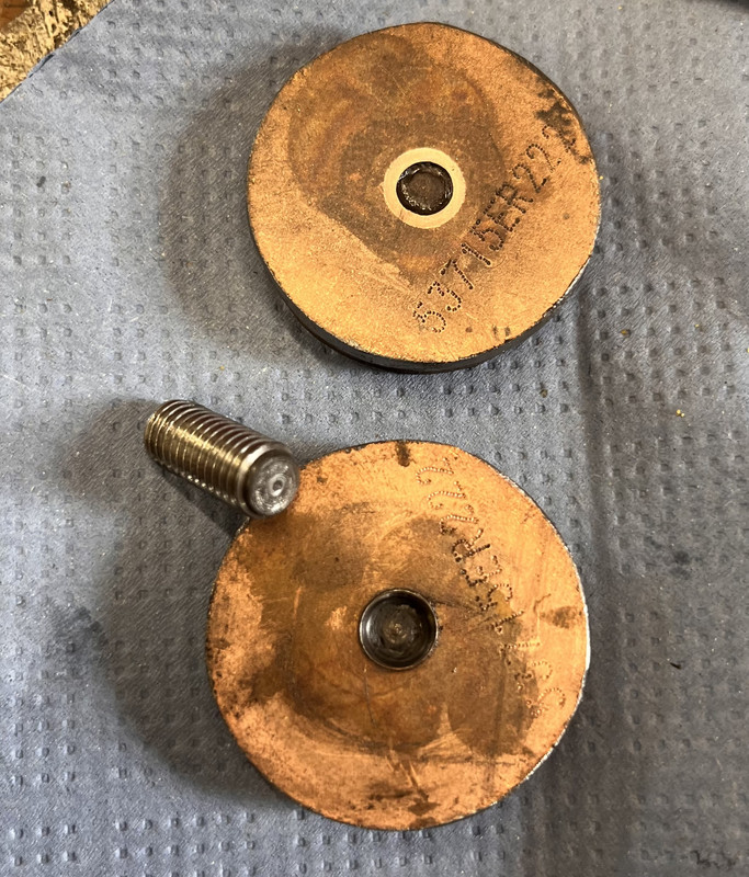

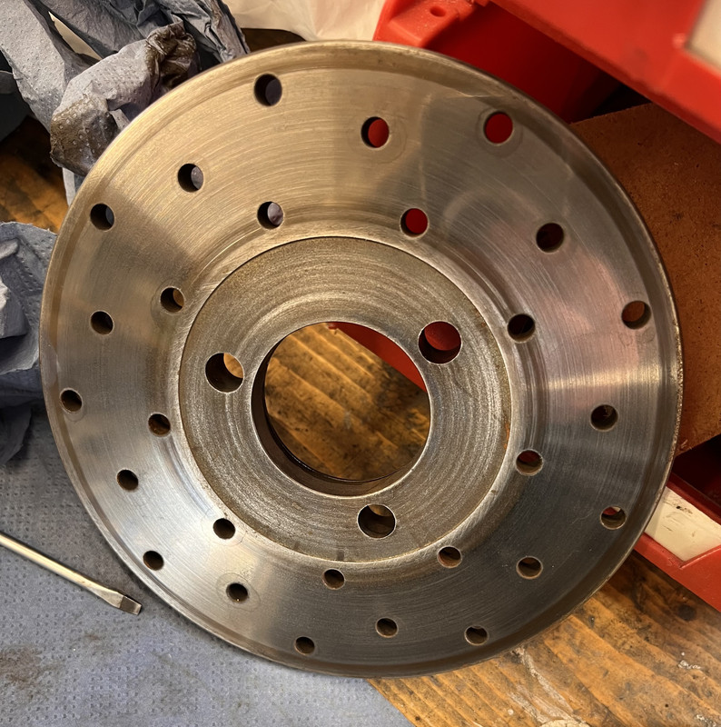

Postby Storkfoot » Mon Apr 08, 2024 10:02 pm
On this scooter, I have a second hand Vietnamese copy front disc hub. The actuating lever is an original Italian one rebuilt with new bearing and ball bearings. I have replaced the disc itself that came with the hub to another Vietnamese vented one (at the time I rebuilt the disc hub during the pandemic, I couldn’t get the better quality Italian disc)
viewtopic.php?f=19&t=15144&p=146291#p146291
Anyway, the pads I have are sintered, the type that essentially look like they are solid copper almost. I have taken them out a couple of times to clean them up, check that they are free to move and put some copper grease on the back.
The braking is good and that’s without doing a reverse pull. But the squeal at slow speeds is pretty annoying. At this point, the benefit of good braking outweighs the squeal but is there anything I can do to stop it?

Postby dickie » Tue Apr 09, 2024 7:06 am
After you removed and cleaned the pads, did the squealing disappear for the first few applications? If it did, then it's probably contamination getting onto them. It can take the tiniest amount for this to happen.
Also, is your disc drilled or plain? Drilled ones can help to keep the pad surfaces slightly roughed up and keep squealing down.
Hard braking can help too, whereas light frequent braking tends to polish up the surfaces. Maybe the slide pins are a little tight, so the disc is rubbing on the pads all the time and causing them to glaze? That last point is pure conjecture, I've never come across that being a problem, but a thought just popped into my head.

Postby Storkfoot » Tue Apr 09, 2024 2:13 pm
dickie wrote:After you removed and cleaned the pads, did the squealing disappear for the first few applications? If it did, then it's probably contamination getting onto them. It can take the tiniest amount for this to happen.
Cleaning did, as you say, help for a few miles but then it went back to what it was like before. It is a vented disc. I do still have the circlip fitted to the disc though. That said, it appears to move okay on the pins.

Postby missing lynx » Wed Apr 10, 2024 11:30 am
Have you given them a good spray with brake cleaner? Squeaking can be caused by contamination on the pads or disk also is the anti rattle clip working properly? If the disk isn't able to float under centrifugal force it will rub (squeak) the static pad
missing lynx
Posts: 891
Joined: Wed Nov 26, 2014 5:14 pm
Re: Copper sintered disc pads
Postby Storkfoot » Wed Apr 10, 2024 4:01 pm
missing lynx wrote:Have you given them a good spray with brake cleaner? Squeaking can be caused by contamination on the pads or disk also is the anti rattle clip working properly? If the disk isn't able to float under centrifugal force it will rub :) (squeak) the static pad
I have used copious amounts of brake cleaner on pads and disc. I may as well try taking the circlip out of the disc next time I am in the hub. I’ll also check the adjustable grub screw that positions the static pad is okay. I didn’t take much notice of it before but it did appear to have a sharper point than I remember them having.

Postby Storkfoot » Fri Apr 12, 2024 9:56 pm
I have taken the circlip out, cleaned the disc and pads up again and taken it for a short test ride. Too early to categorically say that has resolved the squeak but it seems better.

Postby dickie » Sat Apr 13, 2024 9:18 pm
I once had a disc that didn't float on the pins properly. The fix was to bend the spring into a tighter radius. Basically the spring was applying too much force on the pins. Maybe you could do the same rather than leave it out?
