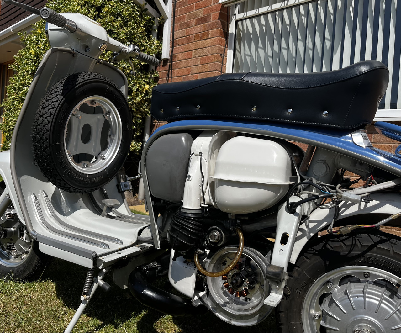

Finally, I shall be putting this 185 engine in my SX150, replacing the Casa 192 that is in there at present. Unfortunately, I cannot find the Mikuni TM24 I was planning to use so, for now, I’m going to use the PHBL25 I had been using on the Casa.
I’m going to try the bgm Clubman, the enlarged MB airbox and metal mesh filter, and a SIP Vape static at 17 degrees.
The jetting I had on the Casa won’t work on this set up.
I’m thinking of starting with the following:
Pilot 48
Slide 45
Atomiser AQ266
Needle d22 2nd clip
Main 98
I know I have a d26 and a 40 slide I could try and I hope I have an AQ264 too.
If anyone has any thoughts on the jetting for an untuned 185 breathing through this air box and exhaust, feel free to share :)

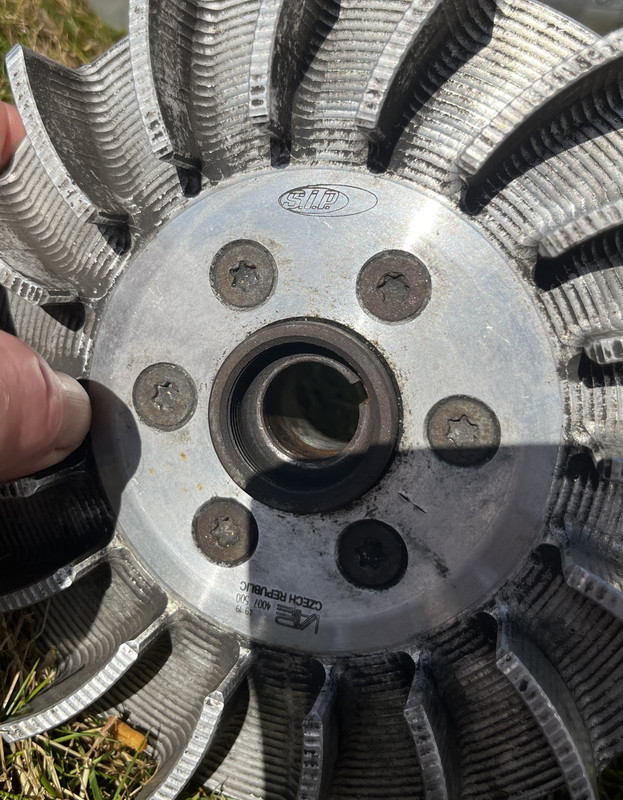

I have the engine in the frame and have swapped over the Vape ignition from the old engine. Unfortunately, I can’t find my trusty old CamLam timing disc so I am awaiting another to arrive later today. In the meantime, I think I need to lap the flywheel with the crank judging by the rust evident in the flywheel keyway :shock:

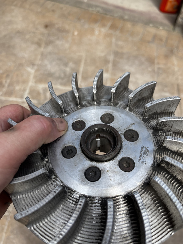

I didn’t fully torque up the flywheel before strobing the timing. That resulted in the woodruff key shearing off. The first time this has ever happened to me.
Anyway, now I have a functional clutch, I have trundled around the estate a few times and the carb settings seem ok. On the stand too, the engine revs up and down easily. But, I do need to run this barrel in so need to do a few plug chops too.
