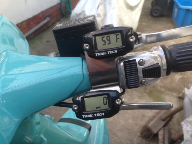

Postby Norrie Bodge » Wed Sep 06, 2017 11:05 am
hi m8 heres my GP setup
i run with NGK B9/B8 ES plugs & NGK resister type suppressor cap & have no problems.
i believe you can run with a BR grade plug with the same result
the only thing that annoys me with this CHT unit is it changing on the run between the 3 settings :- Time/current CHT/my Max CHT

Postby CHRIS in MARGATE » Sat Nov 10, 2018 7:47 pm
TrailTech... fabulous ittle unit.
No battery required.
If ordering for Lambretta, specify when ordering as you need an extension to get all the way to the headset.
I run mine in Fahrenheit so I can see the increase in temperature more quickly than in Celsius.

Postby ROClarke » Mon Nov 12, 2018 9:57 pm
CHRIS in MARGATE wrote:TrailTech... fabulous ittle unit.
Yes fitted the exact same one in the end,just takes a bit of fiddling to get the sensor positioned under the plug on a TS1 head.hopefully winter project of a BGM head will allow easier fitting.
