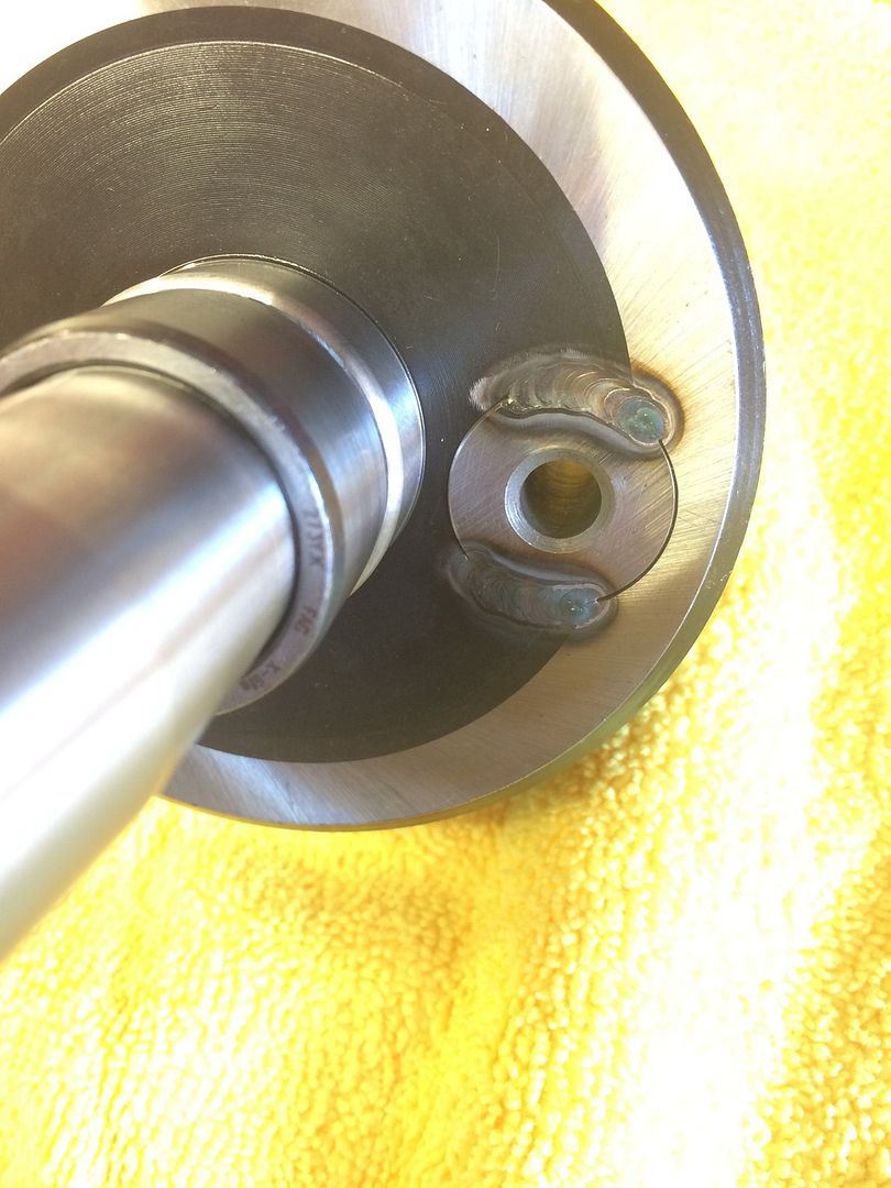

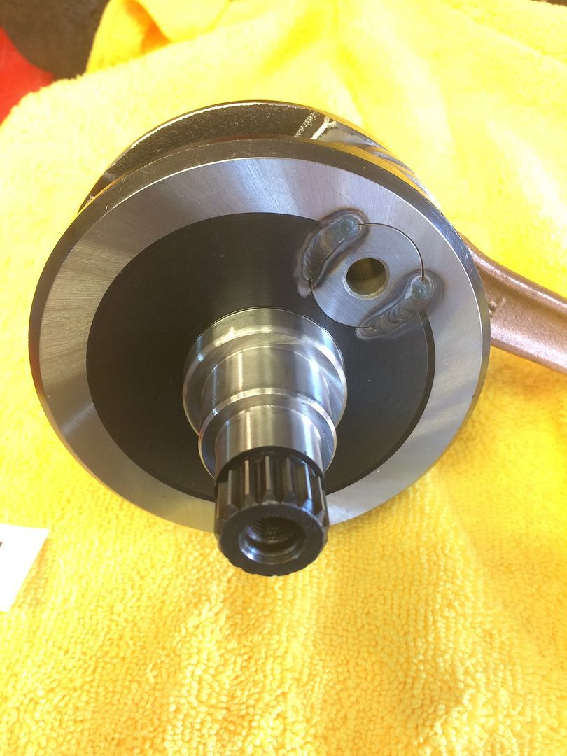

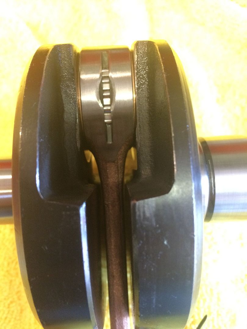

Postby Captain Pugwash » Wed May 27, 2015 8:09 pm
This is the 60x110 "Harry Barlow" built crankshaft I'm fitting to the Avanti, the barrel will need a mild tweek to the ports to suit the longer stroke.
The barrel assembly will move by 4mm, and as some have mentioned it might make the barrel a tighter fit when in the scooter.

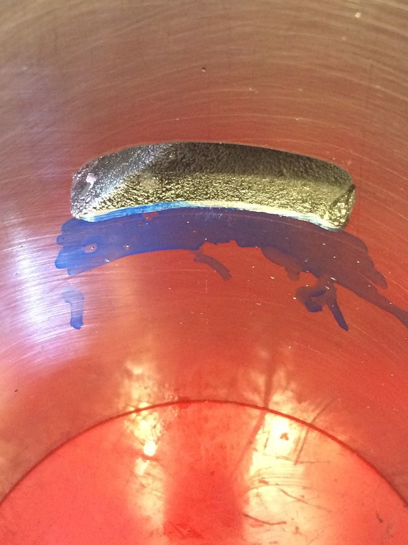

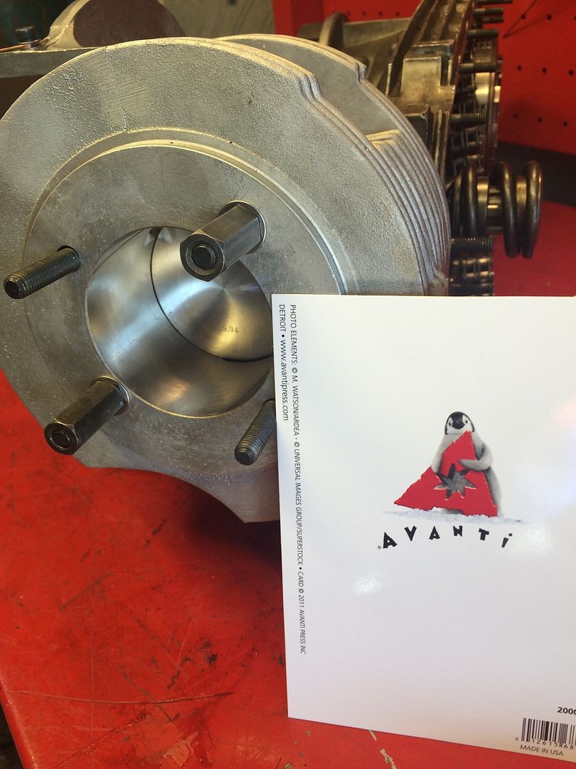

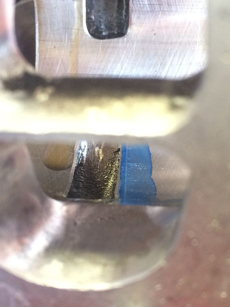

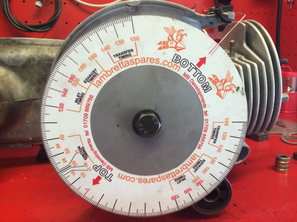

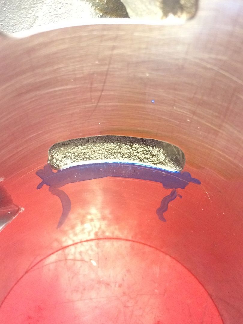

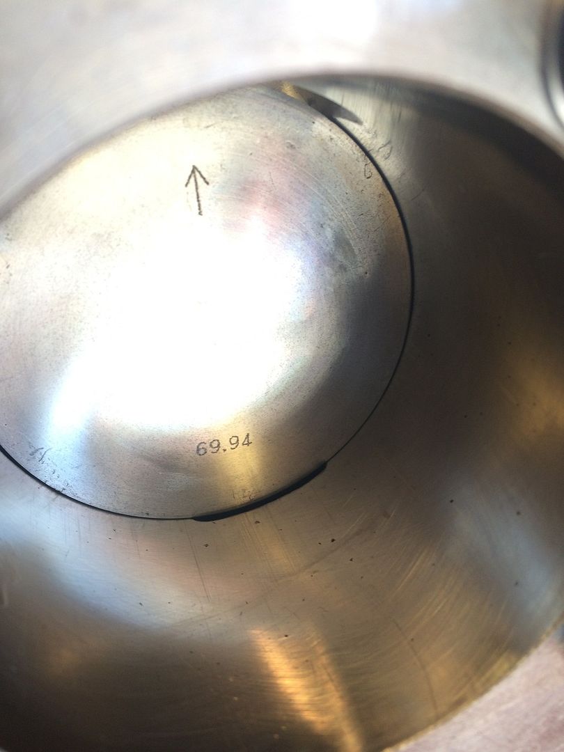

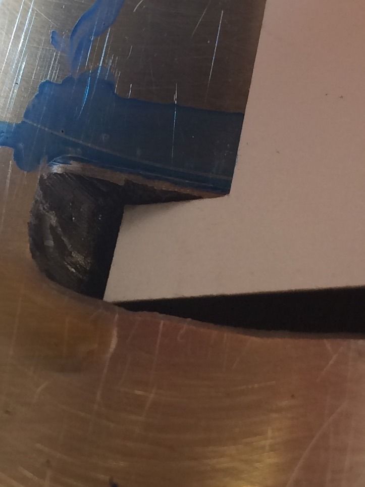

Postby Captain Pugwash » Sun May 31, 2015 6:18 pm
Packer fitted for 60 stroke 110 crank.
Port timings rechecked on new rod and stroke.
As it is now with staggered "transfer port timings"
Both main transfers inked for marking up maximum port modification.
One main transfer showing a negative port roof entry angle the other is the same.
Better view of both transfers marked up prior to any cutting.
