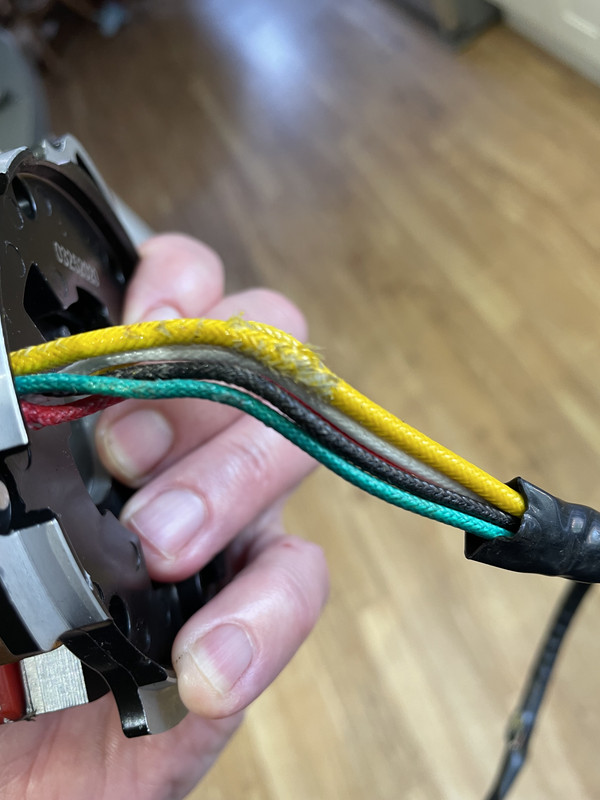

The new version 4.5 BGM stators with the silicon insulation I’ve never been a fan of. The insulation when cutting makes it difficult to get a clean cut with strands of insulation looking untidy, I’m left messing around trimming ends with scissors.
Yesterday I was speaking to an electronics engineer at work about these silicon insulated cables and he said, good for high heat conditions, very poor mechanical strength.
Having just removed one of these stators I was surprised the damage to the insulation under the cable clamp as the leads leave the stator. This is a low mileage engine, and I’m now concerned insulation failure and shorting on higher mileages. See damaged to the fat yellow cable picture below.
Anyone else found similar and have a solution?
I’m thinking a rewire

Reading the BGM stator leaflet two points
1: The black outer extends behind the stator in one picture in the manual. The means the clamp is onto the outer not directly onto the silicon inners as I had it
2: From the leaflet 'Be careful not to squeeze the cables anywhere'. Guess what my cable clamp was doing..
This issue maybe down to me :(
My only defense is, it wasn't so critical with more robust PVC insulated cables
I'll update this if/when scooter center respond to my question

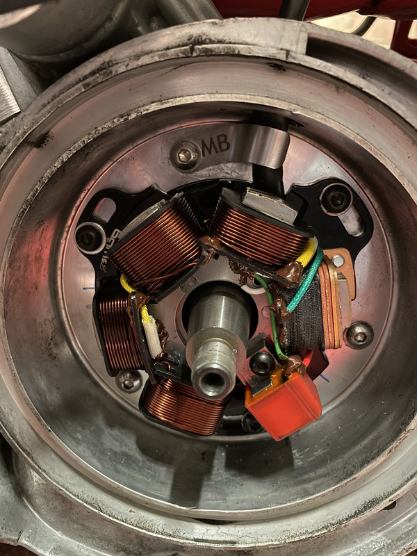

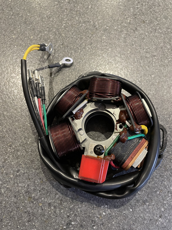

As an update I spoke with scooter centre where I’ve suggested improvements to their installation guide regarding the coloured outer making it clear that the outer is to be fitted so it’s immediately adjacent to the stator
I’ve refitted mine per the image. This time you can’t see any inners
I’ve also fitted a sturdier cable clamp as well, as the old one was flimsy and prone to bending
For the stator with the damaged outer I have chopped out the damaged cable and replaced with new cable
This will be my spare stator I’ll take to the euro.
