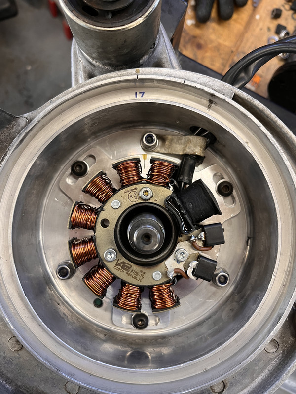

Have you watched the Cam Lam video on Facebook? If not, have a watch.
It just so happens, I have one of my engines out as I have been fitting a new crank. I now need to check TDC and 17 degrees static before I strobe it. They all need strobing in my experience.
For the time being, I have just put the stator back in the place it was before. As you can see, my centre line on the stator, which aligns with the firing point on the flywheel, also lines up with the “17” mark I made on the mag housing.
Does that help?

I can’t see your marks in your picture but, to me, your stator doesn’t look like it is aligned with 18 degrees.
All I can suggest is that you go back and check TDC and your 18 degree firing point.

Postby nickw » Sat Oct 14, 2023 7:42 pm
Agree with above. Your timing mark (white mark) looks way out when the two photos are compared

Storkfoot wrote:I can’t see your marks in your picture but, to me, your stator doesn’t look like it is aligned with 18 degrees.
The picture I put up isn’t as a direct comparison. My crank is not the same as yours.
Please let us know how you get on though. Good luck :)
On the subject if strobing. I have now set up four static Vapes. Only on one occasion did the strobe verify that the static marks were correct. The other three required adjustment.

thank you for all the comments , the white mark looks out of alignment but it is the way the picture was taken.
I worry that the 60x115 crank Yam piston assembly may be so unusual as the render the vape out of adjustment on this set up.

Postby Storkfoot » Wed Oct 18, 2023 7:03 pm
avanti wrote:thank you for all the comments , the white mark looks out of alignment but it is the way the picture was taken.
KTF
One of the ones I set up, on a GP since sold, was a 58/115 crank. That set up okay at a static 17 or 18.
Have you checked your TDC again yet?
