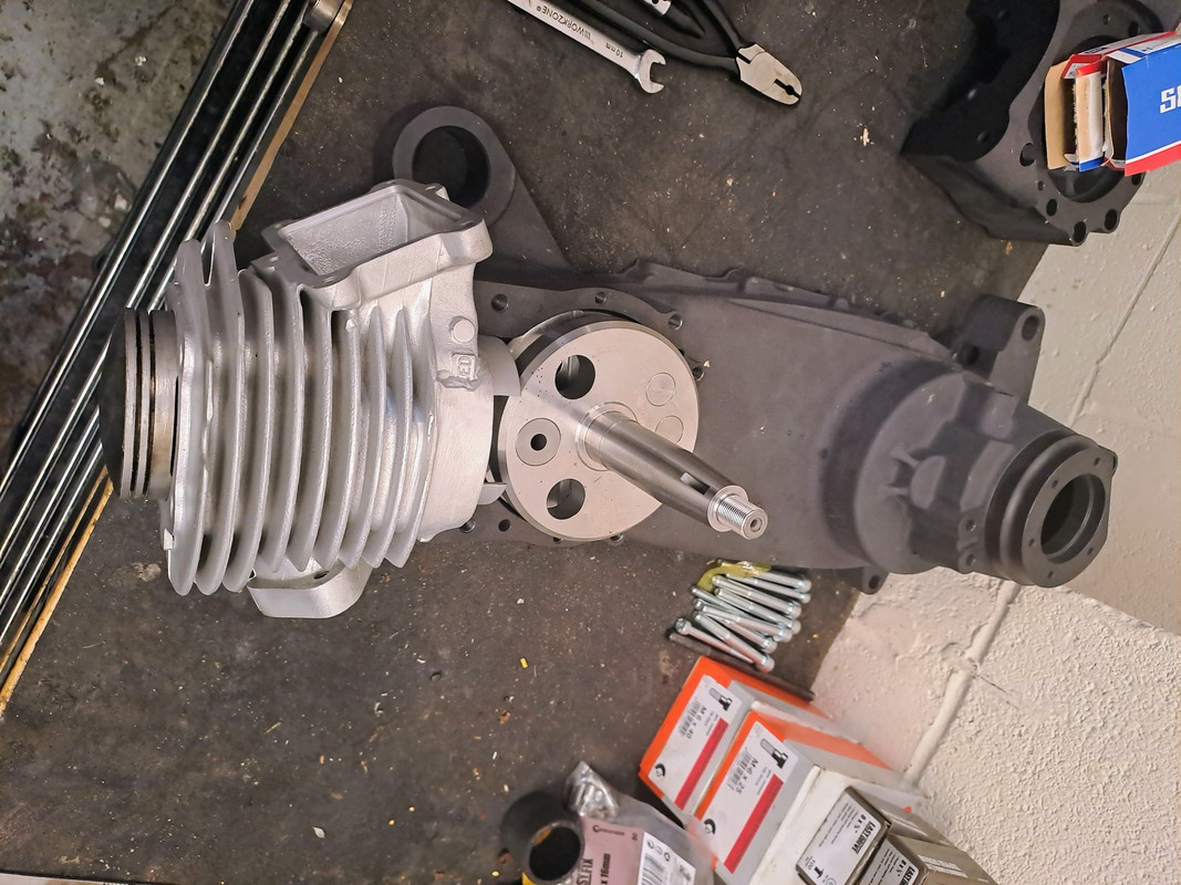

First step of RB270 project complete with the barrel now stripped of nikasil and ready to be fitted with a cast iron sleeve. My mate Viv is taking care of making a packer plate for the base of the barrel and the necessary extra meat and cooling fins added to the top. The original exhaust port will be bridged and then the small exhaust ports will be opened up into the main port on each side. All based on a CasaCase with 70 x 120 crank.

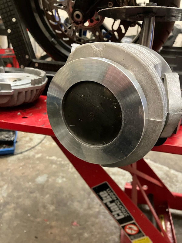

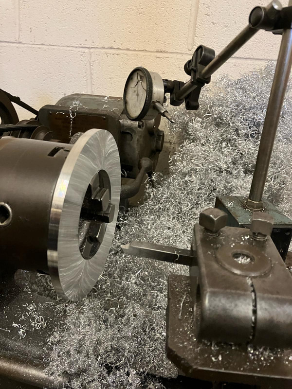

Postby Solid Air » Wed Feb 21, 2024 3:42 pm

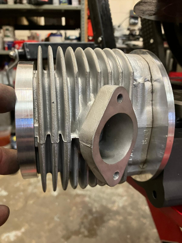

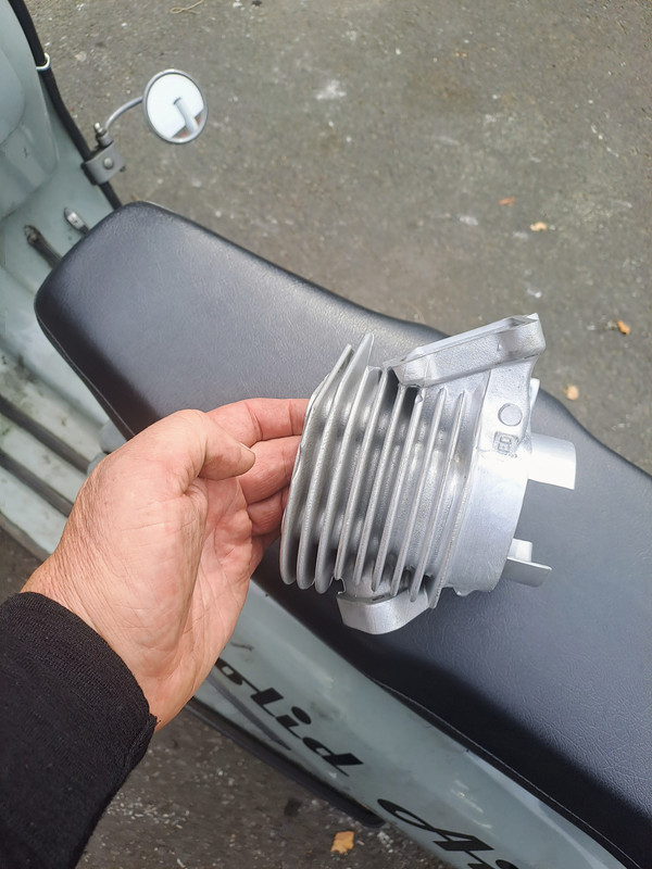

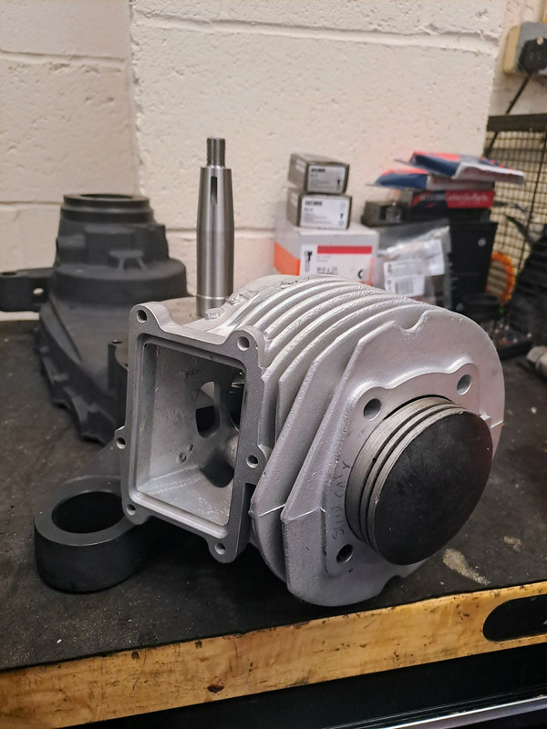

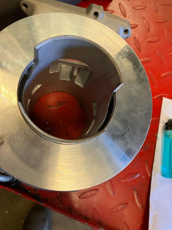

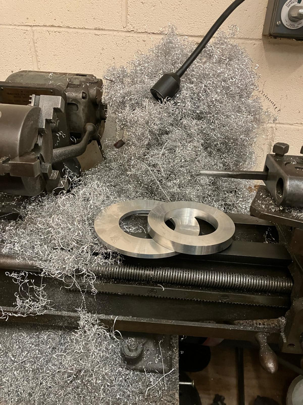

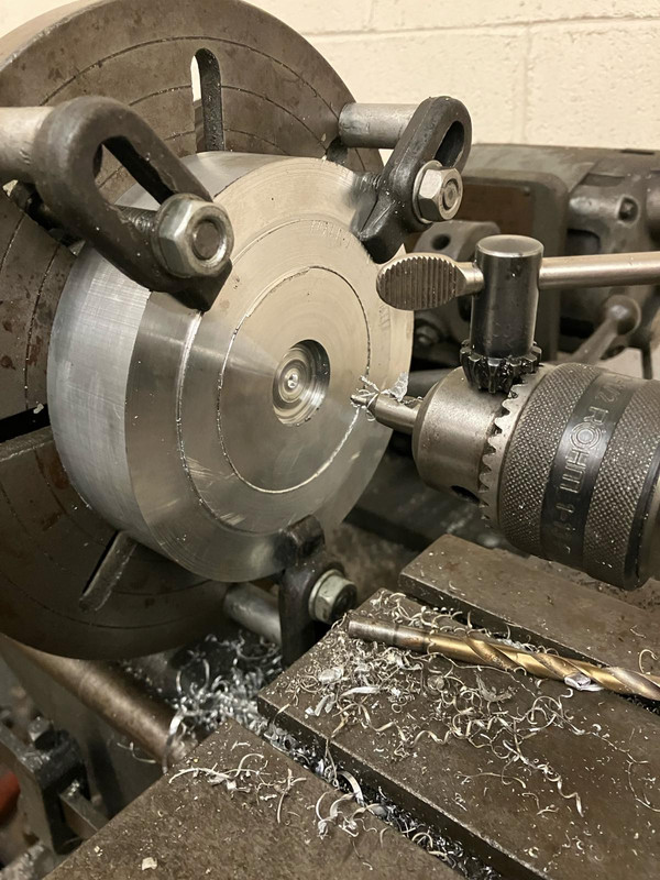

After a period of inactivity for one reason or another, work has restarted on the RB270 project and machining the top and bottom additions for the barrel, not by me I hasten to add though.... what are friends for?

Re: RB270 Project
Postby Norrie Bodge » Wed Feb 21, 2024 6:48 pm
Some great work goin on there mate :-)
Timings will be:
Exhaust 175
Transfer 125
Boost 130
Inlet 360
About where I setup mine .. that’ll be a great ride 8-)
