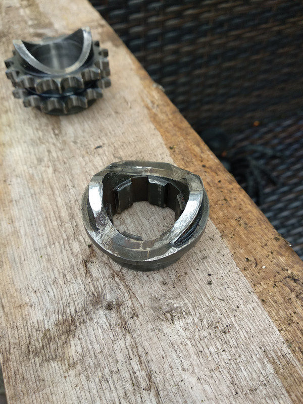

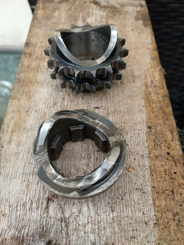

UPDATE! Well, well, well no sign of operator error but the sliding dog is indeed more f*cked than the local crack whores (& that's saying something...). I can't believe that issues weren't manifesting themselves in the engine's previous Mugello incarnation :?
Someone of a less neo Luddite inclination will be along at some point to post some less than pretty pix. With thanks again

Posted on behalf of Andy BLC. Sorry I couldn't put them up earlier mate, Tess and Issy's birthday so been busy with them.
Imagepaste image host
Re: Clutch issues...
Postby dscscotty » Sat Aug 29, 2020 5:51 pm
Er that's your problem!
Postby dscscotty » Sat Aug 29, 2020 5:53 pm
Having had a bit of experience with RB's, particularly RB20's as long as they're in good order, standard cush/springs are fine, if it is slipping it'll be down to the fact the sprocket/sliding cush surfaces are worn/damaged, which yours clearly are.

Having subjected the cush drives to the rigours of racing, I've never had OEM's ride over the cams like the one depicted. That said, I loaned my good 14T sprocket out so bought another non OEM for Three Sisters (when it was a shorter track) & lost drive after a few laps of practice. The cam of the sprocket was worn away so badly the drive cam just rode over it. The gearbox oil was metallic soup.
BTW, the 14T I eventually got back, was made from an OEM 18T @ Apple in Thrapston.
A useful trick to preload the cush is to use the S1 top dished washer which is shallower.
It might be useful to mention that there is no need to faff around trying to align the dished washer splines. Just tighten up until you meet a little resistance, then a copper faced mallet on the dished washer will align it, which you can tell when the mallet starts bouncing. Then torque up the bolt.
