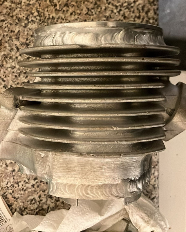

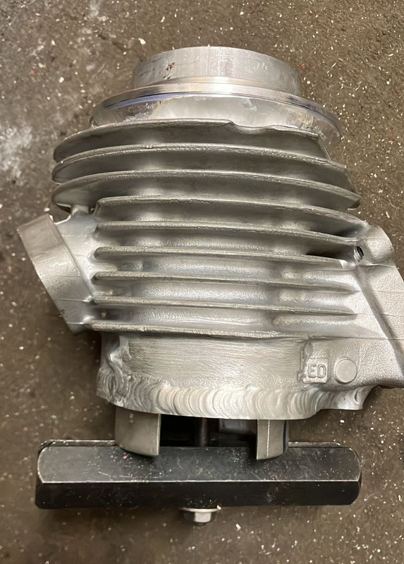

Postby Solid Air » Fri Jan 10, 2025 8:56 pm
It's been a while, but finally some progress to report. Barrel welded up, iron sleeve to be fitted very soon.... finger crossed.

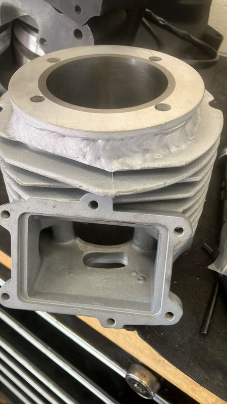

Postby Solid Air » Sat Jan 11, 2025 5:27 pm
WT#1 - I can't claim to be the technical brains behind the engineering of the barrel. I came up with the idea of using a CasaCase with a big crank to make a torque low-revving engine, with the added safety given by the larger crank, and my mate had an RB barrel sitting on the shelf.
As we are using the crank to increase the cc, the piston will be a standard / Wiseco RB piston, which should also give added off-the-shelf convenience if needed.

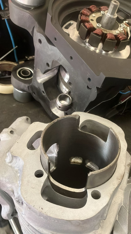

Here is a better picture of the bottom of the barrel, there will be a port in the crankcase to the floor of the inlet, lining up with the rear ports above the inlet (apparently :D)

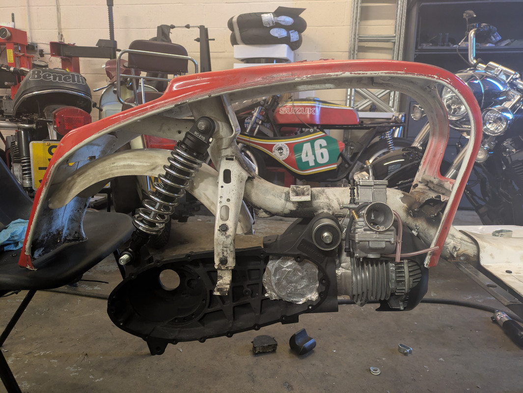

Postby Solid Air » Wed Jan 29, 2025 7:18 pm
Cheers Shane.

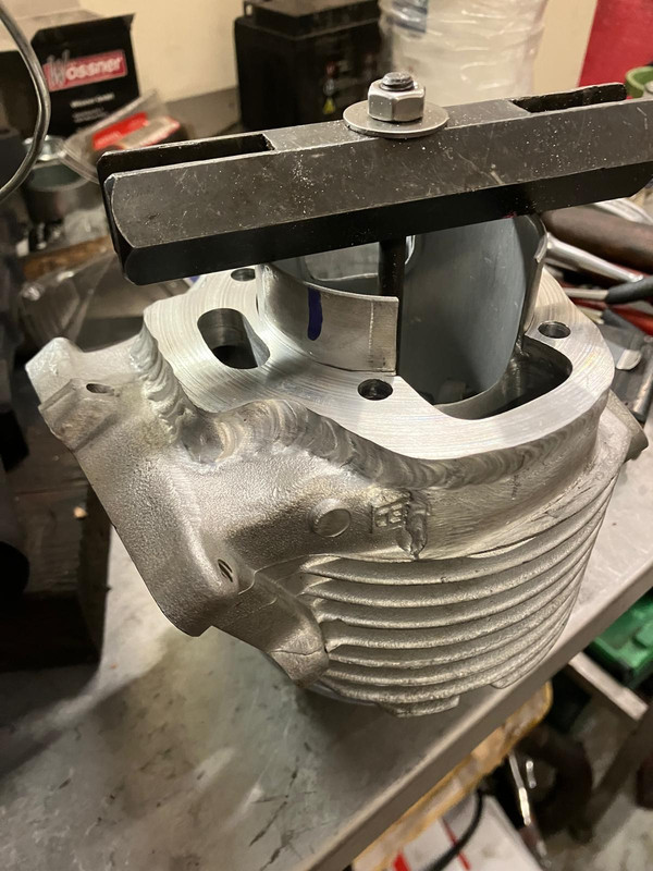

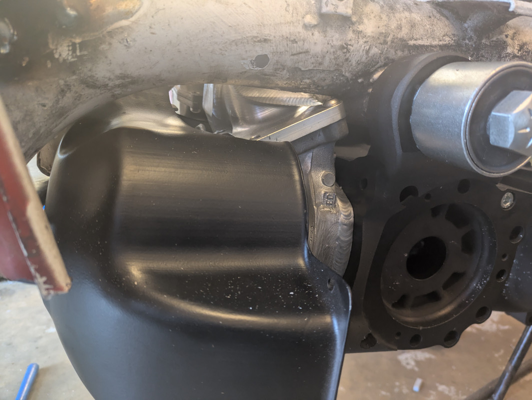

Today's progress
Mocked the top end up to check frame fitment.
We were expecting to need to move the frame engine mount, but all that we had to do was take the corner off the inner front left of the frame loop and tickle the rear runners.
The deck height is much lower on the CasaCase than a standard one, which meant that there was just about enough space for the top end without moving the engine mount. Pic 2 does this clearly - the gasket face is immediately in front of the silent mount, whereas with a standard case gasket face it is further forward.
Also, there is still some machining to do on the cylinder head which, will give an extra 3-4mm.
The flat-sided engine bolt and offset cones helped too.
Re: RB270 Project
Postby Adam_Winstone » Thu Jan 30, 2025 4:35 am
Your frame / head clearance is similar to that on my Mugello 293 with 72mm stroke on Casa Case, which has been fine in use. I have used the more common AFR head, rather than the Mammoth head, so am glad to see that you've managed to configure this to suit also.
