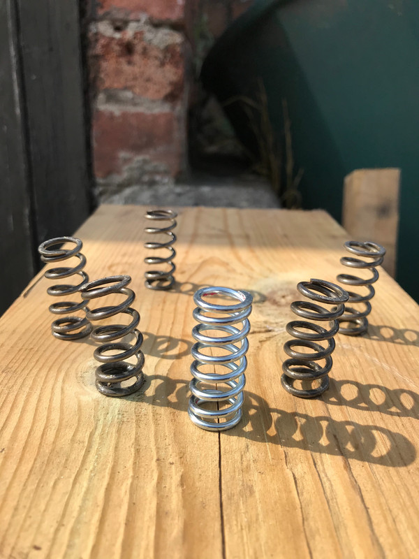

So... Process of elimination, as alluded to earlier, cheers chaps!, stronger clutch springs are the next (&final!) attempt to sort this. Chiselspeed springs have been ordered... ;)

Chisel Speed springs here & on the kitchen table, not the engine mind, make's a change :lol: Tomorrow will tell... ;)

Well an epic fail (again) later... While pulling the engine apart I became aware of an issue I'd not noticed previously, probably due the small amount of resistance not being felt while holding the chaincase side in place while tightening it up. So... as I was loosening off the allen bolts (look good, but stopped using them decades ago) I noticed that the sidecasing was lifting off by itself. Hmmm very wrong! Once the casing was off it was immediately obvious that the clutch pressure plate had been way too close to the brass bush, the perfectly circular gouge being the give away, & to be honest mildly manifested during kickover. Again, & this is not an excuse, as I hadn't been ordering & buying the parts just trusting in them I was again a tad flumoxed while getting closer to another 'F' word, this scenario was just beyond comprehension. A phone call to Jerome @ Readspeed (top lad with great business sense, the Chiselspeed springs don't fit in the red devil clutch recess) later, an extra clutch & friction plate & a new set of springs ordered (4 of the springs were bent, photo possibly to follow, & if so YES I did ping the springs into place with a screwdriver!). I'd like to think that this saga is on the home straight with one last post due to say that all is happyness & light, hope I've not just knackered that :roll: The way I understand it is that the extra plate (with trimmed ears) will pull the clutch pressure plate deeper into the clutch basket meaning that it will no longer be rubbing on the bronze bush thereby eliminating clutch slip... To be continued...

Postby Warkton Tornado No.1 » Sun Sep 20, 2020 11:23 pm
I am in the habit of checking the gauge, number of turns in the spring & the fully compressed length as a set using a vice.
It's amazing the variation, but rule of thumb is the thicker the gauge, the stronger the spring. Forget about length having any affect. What you need is the shortest coilbound length. As I have dozens of sets available, from various sources (that I cannot say whose is whose :roll: ) & I most recently fitted a CamLam six plate in a standard clutch component set-up using the shortest coilbound strong springs that I had to hand, & the clutch was perfect.
Lastly, in case you don't know, check that the springs don't get coilbound by operating the lever with a tight cable. Better still, with compressor still in place, count how many turns it takes to fully compress the clutch (coilbound) & measure the tool pitch. That will give you an accurate figure for the running clearance, important for separation to eliminate drag.
