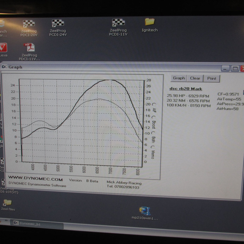

Here's an RB20 VHSH 30mm-Chisel pipe

Thanks dscscotty
is that CST 6 pipe?
