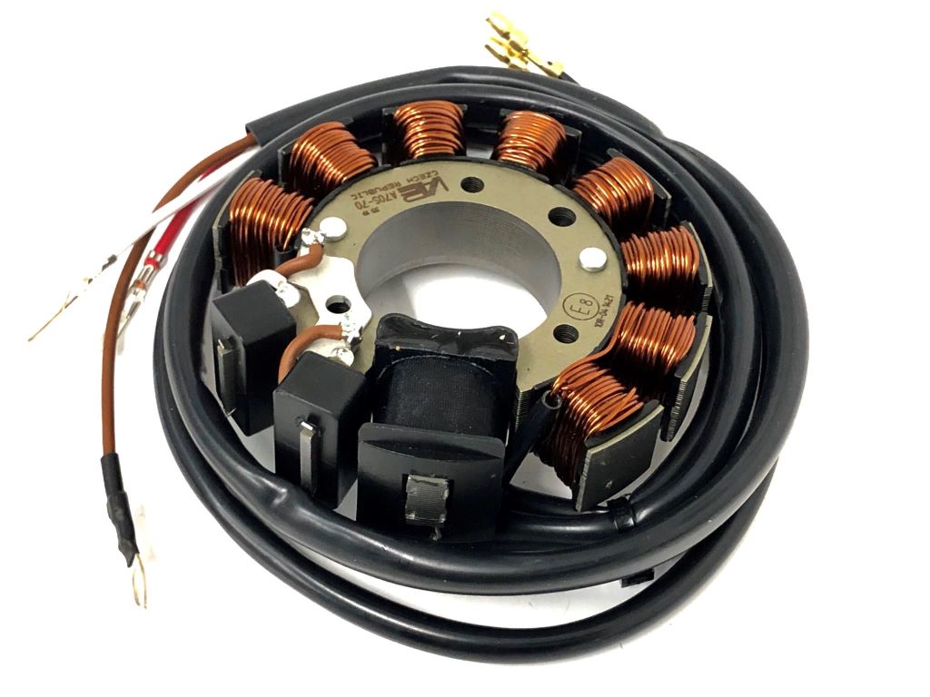

Postby Fast n Furious » Tue Jan 16, 2024 12:04 am
I don't have 1st hand experience with these Vape stators but looking at the attached photo of one, it looks like 8 Lighting coils, 2 pick-up coils and 1 conspicuously looking LT coil.
Am I missing a trick here?
