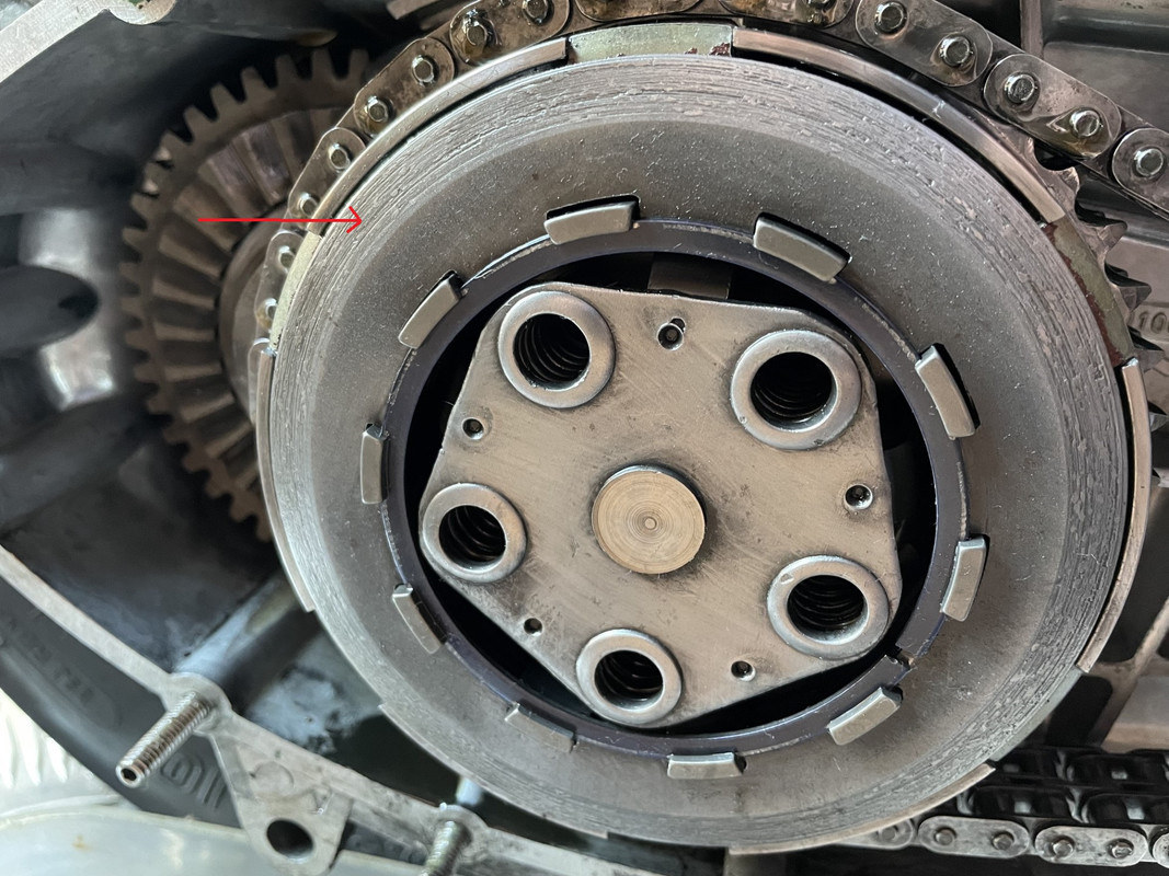

The area highlighted by the red arrow - I think this is the kickstart rubbing the top plate
Is this bad enough to want dealing with - I assume grinding material from the kickstart?
I don't see this as a cause for the clicking noise. Yes I know I have fitted the clutch circlip badly

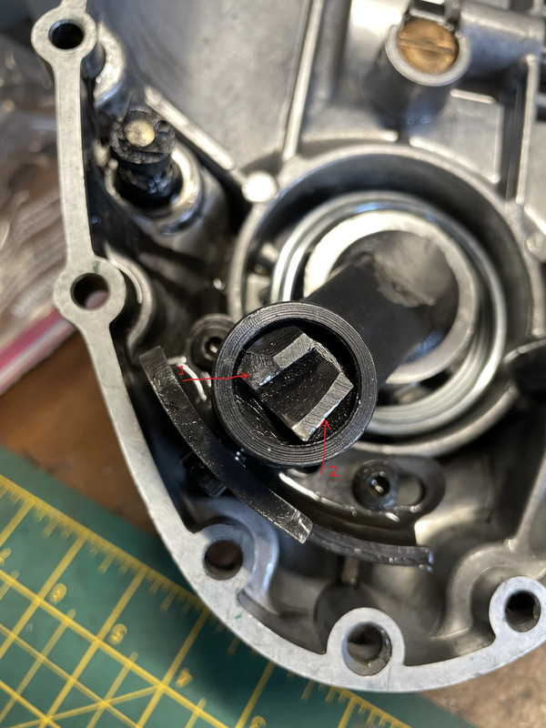

Do I have the improved, reduced height kick start teeth 1st gear?
That accounts for the broken tooth on the magnetic drain plug!
witness marks on other intact teeth at point 2
wondering if this accounts for the clicking - kick start piston interfacing with 1st gear?

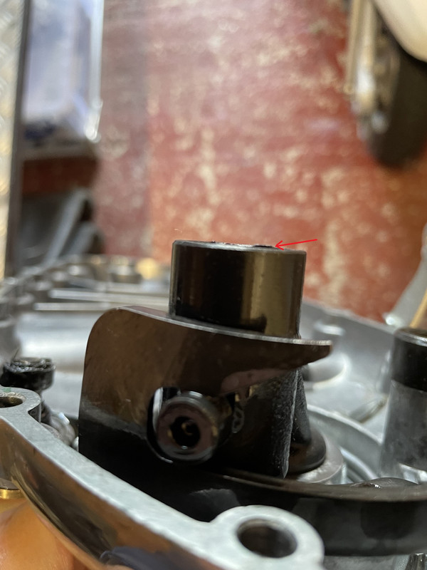

Plunger not retracting fully below the kick start :(

Obviously the top clutch plate is a separate issue which I’ll also need to address

As for the jumping out of gear. The wishbone was touching the casings when in 5th - sorted that with the trusty Dremel.
I checked the kickstart clearance to 1st gear using plasticine, and clearance to the clutch top plate via engineers blue, all good!
