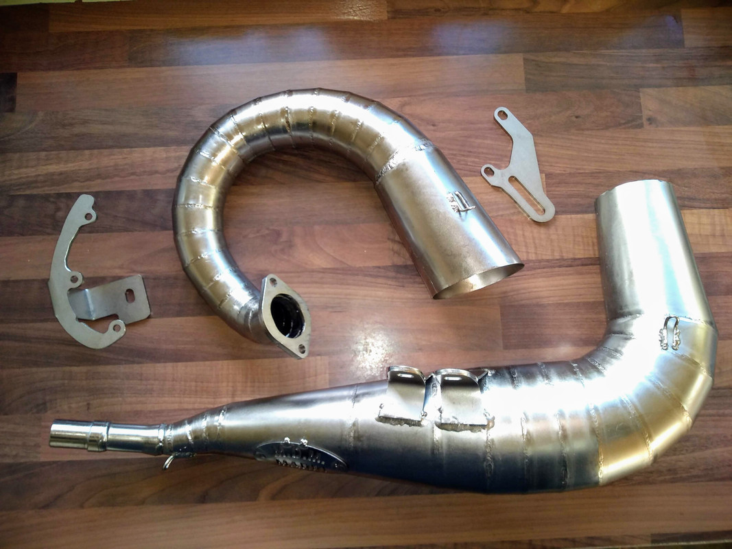

had my BGM clubman u bend done in bright nickel.a friend works at a platers and suggested it to me .im sure he siad nickel was used as the base coating in bright show chrome plating process.
Mine has lasted a good few years( had it done in June 2014) but starting to look tatty and a few spots of rust appearing

Postby vegansydney » Sat Jan 09, 2021 4:21 am
I picked up several kilograms of electroless nickel plating today including some Tutto Lambretta U-bends and they look almost too nice to fit. My electroplater even commented how nice they came out.
