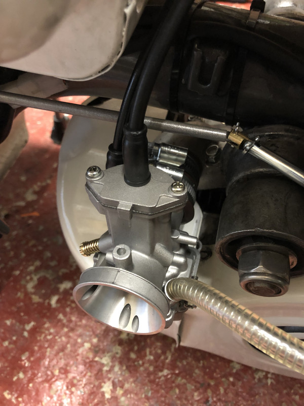

Here's the fitment of the carb. Cables clear the toolbox and the fuel lever is no longer at a crazy angle
I've since been told a 30mm PWK doesn't like a remote filter, so I'll have to get my head around that if the carb is too stay (after all that!!)

Postby Warkton Tornado No.1 » Fri May 24, 2019 12:24 pm
[quote="nsaints"]Thanks for all advise ^^
Managed to source a PWK specific manifold. Buzz had no stock, but Martin at Just Lambretta came good
The Manifold was bargain basement price, and needed some minor fettling
Image[/quote
Dunno who told you that, but one reason I really like the PWK is the ability to run a capable filter without issues such as hot start/flooding without having to drill leak holes as with some Dell'Ortos! That is because the design incorporates an overflow in the bowl, just where it needs to be, because panelled Lambrettas have heat soak issues when the engine is stopped. As mentioned previously, a 34mm PWK runs absolutely brilliantly with a homemade foam filter, either via an elbow or as a 'sock' just pushed on.
The only trouble encountered has been the jets getting blocked because an inline filter was not originally fitted, but that has now been rectified.
PWK carburettors are fitted as original equipment on some equipment, so the proof of being compatible with an air filter is there to see.
(My Mate may have got a bit carried away with his right hand :roll: with his rebuild ('Old School' pattern piston, cast iron barrel) as it had a soft sieze so the top end needs to come off soon, but the 32 pilot may be a bit too near the margin.....)
