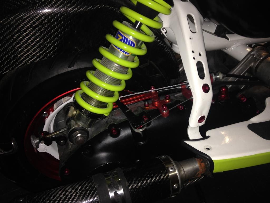

Postby Dazts1 » Sun Feb 22, 2015 10:29 am
Here a couple of pics of the motor.

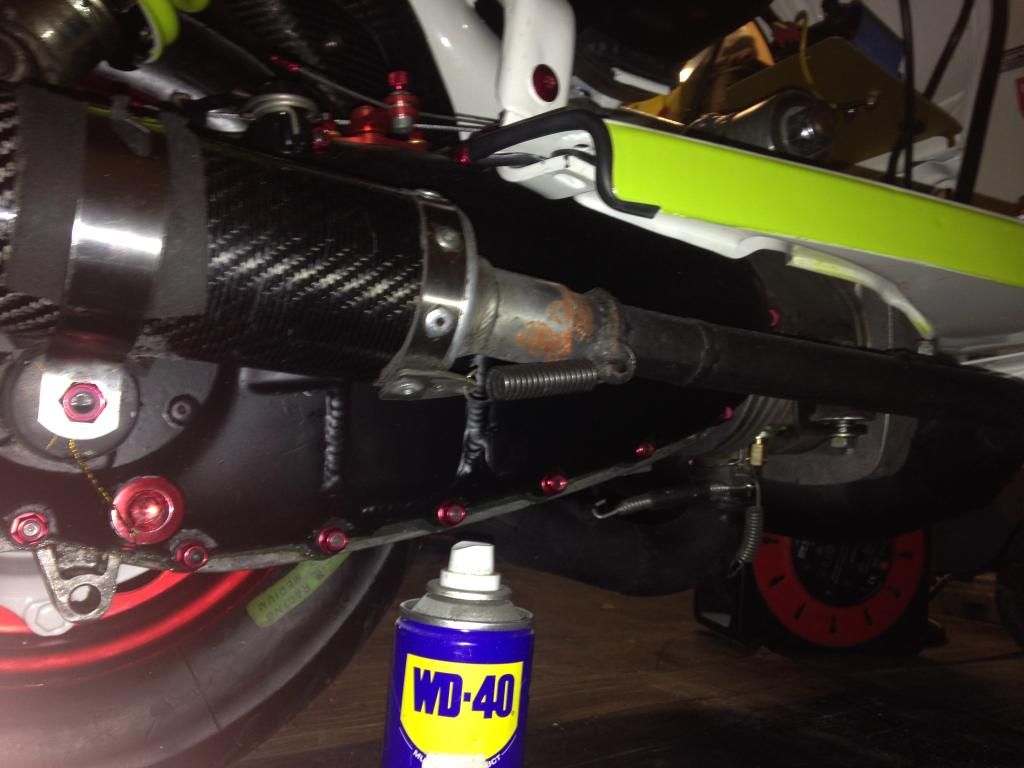

Postby Dazts1 » Sun Feb 22, 2015 10:42 am
I had a targaline gear change set which I was going to put on a road bike. I thought the precise gear change was more important on this.
Pipe fitted.
