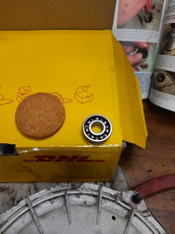

Those dimensions are correct. I found another one and remembered a complete hub I had stashed as well. I was convinced the tube was a nice sliding fit, but it's rattly as he'll.
So hub is finished now.
Just a tip though. Don't put a bearing next to a biscuit in case you abent-mindedly pick up the bearing and try to eat it. It was an unpleasant surprise. Thankfully I realised the moment it touched my lips rather than trying to chew it.

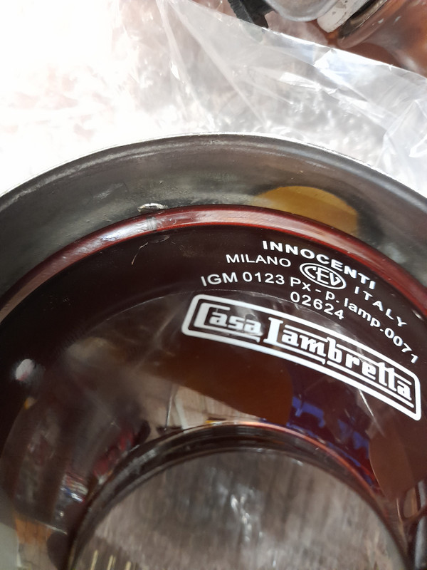

dickie wrote:Headlamp reflector is goosed but I can't find an identical one. Does anyone know where I can find one? Are these type with notches normal? New to me, but I don't have much experience with series 2.
Original CEV 8050 reflectors are not that hard to find as they're not unique to Lambrettas and were used on Ducatis (and possibly other Italian marques). I've got several NOS 8050 reflectors in original boxes and a few near immaculate used ones here that I've picked up for under €30 a piece. If you were closer I'd sell you one. Don't pay stupid money for them.
I'm no expert, and hopefully an adult will be along shortly, but I know there are several versions--all interchangeable--all with different ways of mounting the headlight rim. The most common ones appear to be the ones with the plain edge, but I've also seen ones with 6 slots the outer lip for securing the rim. Going by the logo, yours looks to be an early one.

Thanks Sydney. I've ordered a casa one which looks the same apart from the notches. I'm going to try to cut them in myself, but may well end up with just a knackered reflector. We'll see......
It would have been nice to keep the original and get it rechromed but at £100 versus £30, it seemed silly. I even thought about keeping the inner tubes as they appeared perfect but as it's been off the road since 76, it may have been even stupider!

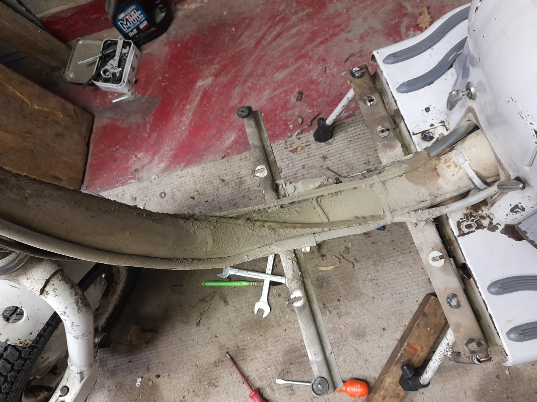

It's all just about stripping and cleaning really. Any parts that don't perform their function will be replaced but otherwise I'm keeping totally original; this means most rubber parts plus a few things like fork springs.
Took the legshields etc off for a deep clean. 60 years of Italian dust and grime takes some shifting even with muc-off.

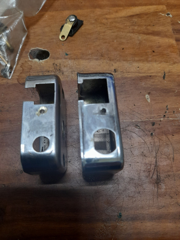

Postby dickie » Thu Apr 07, 2022 10:18 pm

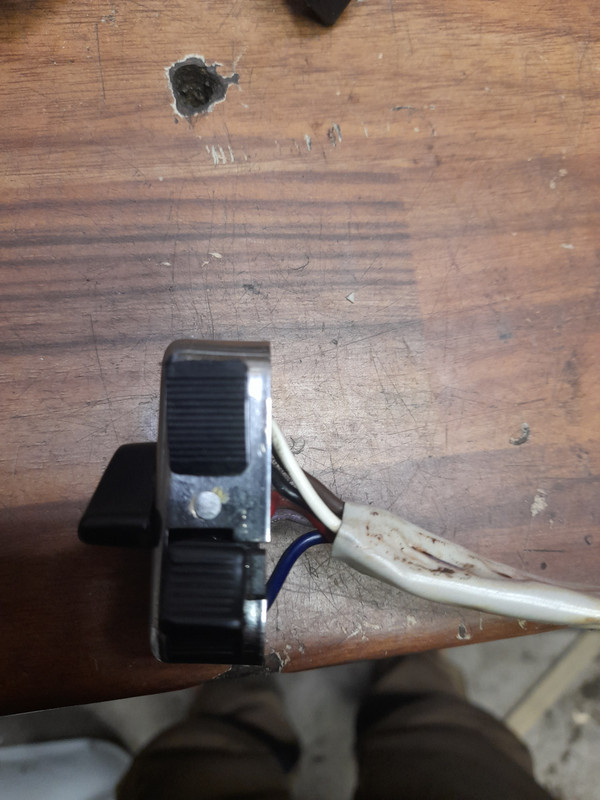

The horn button was snapped on the light switch. As with everything else, I didn't want to replace it, I'd rather repair it.
So, I bought a cheap Indian one so that I could swap the button for my original switch. This was a bit of a gamble as I didn't know whether I could strip and rebuild one or not.
You need to remove the e-clip from the back, then the rotary switch can be lifted out and it's easy to strip after that.

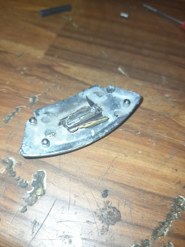

The switch is held in place by a solid rivet so I had to dremmel the rivet out of the old one and same with the new one.

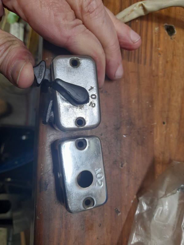

A problem was that the indian button is slightly bigger that the original button, so I had to open up the hole. I used a 9.5mm drill and a little filing.
The right one is the indian one and shows how much bigger the hole is.
I've never used solid rivets before, but I got some 2mm x 3mm aluminium ones and just gently peened them over. It was much easier than I feared.
Of course, it was.tempting to use the indian ebay switch but it just didn't look right, AND it's a bit of a quest now to use as much original as possible.

The headlight was good apart from the reflector.
I toyed with the idea of getting it replated but it was going to cost about £120.
I just didn't want to cover it in foil tape as it wouldn't do its job properly.
So the next option is buy a copy. But I couldn't find one. The original has notches all round but none of the ones I could find had these.
You can see here that it doesn't work with this rim and lens;
So I cut slots an it's a great fit. New rubber seal and that would have been it but I've lost the effing clip for the bulbholder :roll:

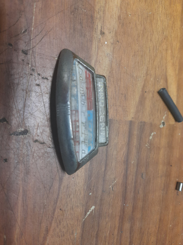

Sadly, when i pulled the badge out the horncast, the clip part on the back snapped. Image
So I levered the infills out of a new one I had and swapped the ones from my original one.
Looks OK I reckon. I'm sad that it's not completely original but it's close enough.
