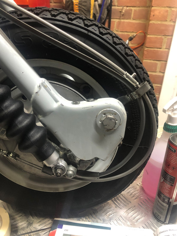

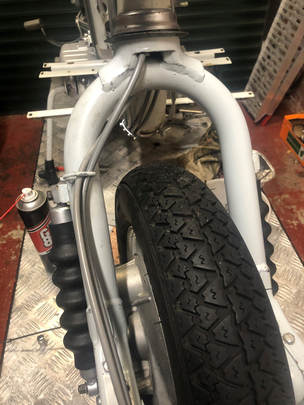

Question for those in the know - grey speedo cables seem to be supplied too short, so a nice loop at the wheel end seems impossible. The cable is perhaps an inch too short
1st I tried a scootopia speedo cable, then I read Mec-Eur are a better length. So I bought a mec-eur cable, nope just the same. :(
I read a theory that grey speedo cables have mistakenly, started to be made to the same length as a GP speedo cables. seems a good explanation
I don't have a genuine innocenti grey cable to confirm this by measuring
anyone else know a solution to this... I'm not sure it's possible to make your own speedo cables..?
Here's a couple of pictures to illustrate my point
Too tight a a speedo cable loop at the wheel?
Cable run down the fork

Postby Warkton Tornado No.1 » Sat Feb 27, 2021 6:47 pm
"Speedo cable" written on the back of my hand to prompt me to measure a few.
If no grey available, a donor from another vehicle can be made to suit & may be a better bet than remade cr@p. The outer could be greyed by heat shrinking grey on & the inners are modifiable (shortening & squaring) by loading the cable (actually, more like a spring) with solder & forming the desired square end. I've had to do so for a flexible drive on porting tools, so it does work. Bit of a faff, but Lambrettas, eh?
Posts: 2286

Postby nsaints » Sun Feb 28, 2021 9:00 am
Thanks for checking.
I've just measured the mec-eur outer and that's 44 inches exactly, which is the same as the Scootopia. a tad shorter than the cable you measured
It's not the end of the world with the outer being slightly too short. With a liberal amount of grease on the inner, it should be fine-ish :?
However the too tight a radius then ideal at the wheel, must be putting additional strain on the speedo drive gear, and contribute to premature failure :roll:

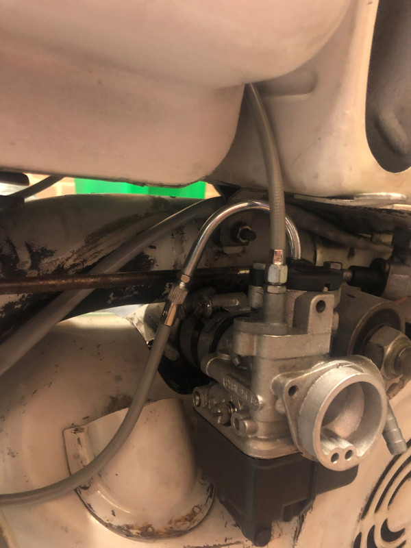

To maintain the standard carb outer cable (for the dummy oiler) I've used a 160 degree dellorto angle to give me a few inches extra cable length for the uprated carb.

I just revisited your images & reckon that you should tweak the fork link centre mounted (Gasp! Take a breath) cable clip by making the two bends within it a little greater, effectively moving the clipping component closer to the pivot centre. Also rotate it clockwise as you look @ the offside.
If you do so with the intention of giving the speedo cable clipped in it, you should be able to create a better radius to it making it's entrance to the speedo drive less sharp.
Let the speedo cable's most comfortable geometry dictate the positioning of the clip, not the brake cable.TBH, the standard front brake cable routing loses so much efficiency it's little wonder that reverse pull is a preferred choice for many of us. Today's traffic, worse driving standards, better tyres etc all seem to contribute to the necessity to gain what you can in the braking area whilst utilising OEM components. Not that I am opinionated....... :lol:

Just tried bending the guide without any heat and it snapped like a dry twig :lol: :oops:
Just ordered a new guide...
Edit..
Without the cable guide fitted the speedo cable follows a nice loop close to the fork boot
With a fork with a welded wire guide the speedo cable length would be near as darn it perfect
So perhaps the grey speedo cable length ‘issue’ has always existed since the introduction of the bolt on cable guide?
Anyhow as stated earlier not the end of the world.

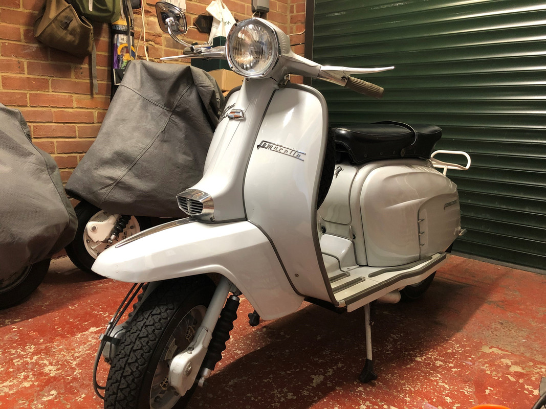

Just finished..
In the end the speedo cable was OK, I just bent/eased the plastic shroud into the same curve as the cable, and everything was well
I also picked up a nice inner legshield spare wheel holder.
pleased with with the overall result, and roll on warmer days/evenings :)
