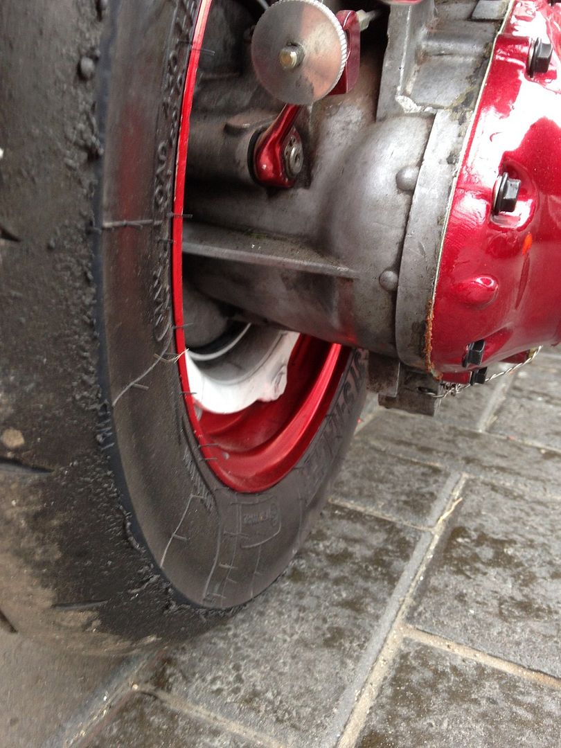

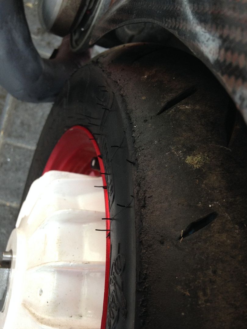

Just having a look over the bike this afternoon. Pulled the plug and it was still very dark. I down jetted from a 168 main on Saturday night to a 162. Pulling the plug showed it to be well rich hence down on power 2nd race on Saturday. Dropping to a 162 obviously wasn't enough as the plug was still black I was advised with avgas the plug should be a grey brown. It just shows how altitude affects jetting. Looking at the plug I probably could have come down to mid 150's. The scoot survived the weekend quote well with minumn maintainance to do. I ve just been looking at the rear tyre leaning the bike over to see how far down I must be getting to shred the tyre the way it has.

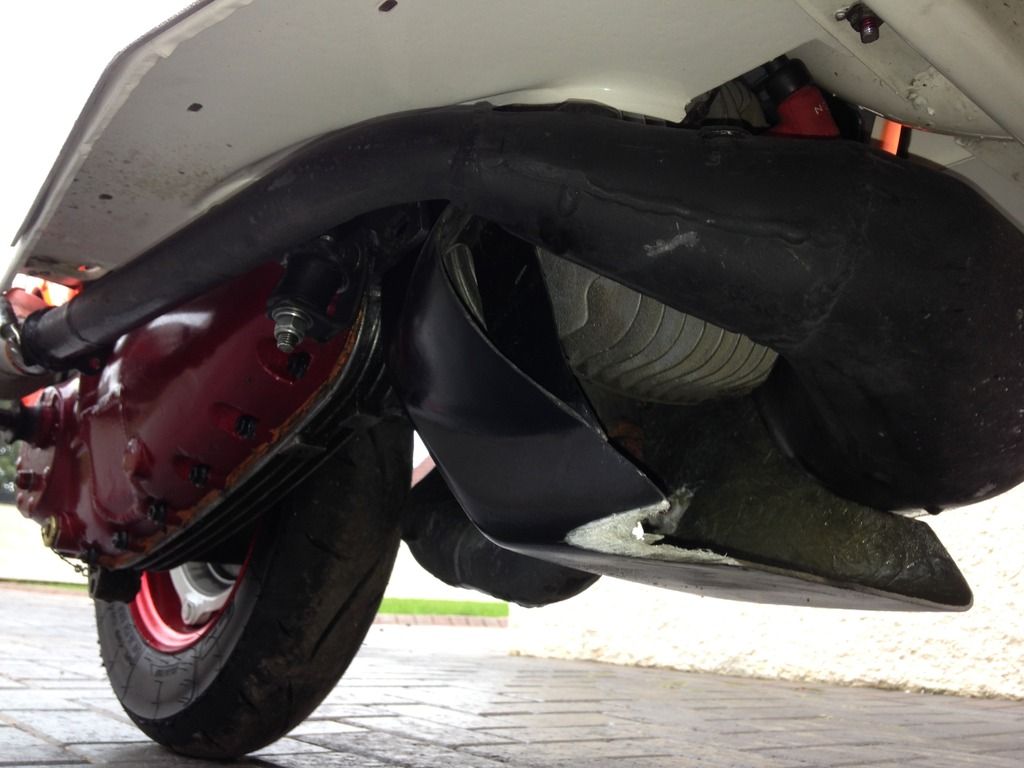

It certinatly didn't feel like it was getting down that far. I also noticed the fiberglass airscoop also took a good scrapping. I'll have to modify it so it sits a little higher up.

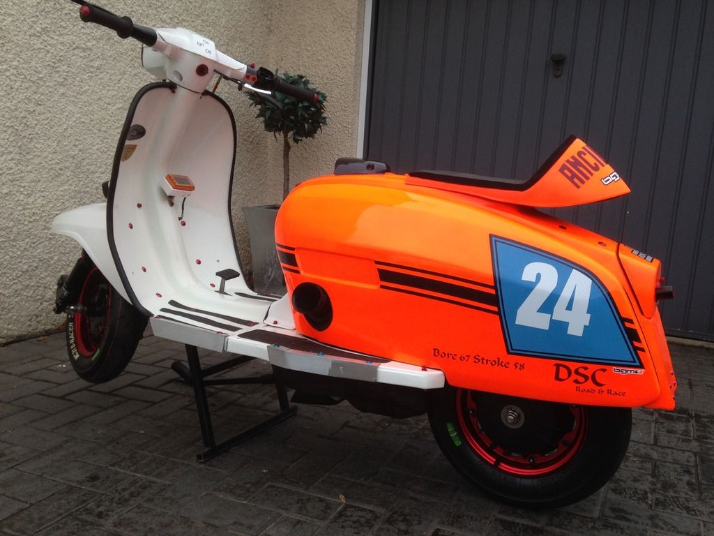

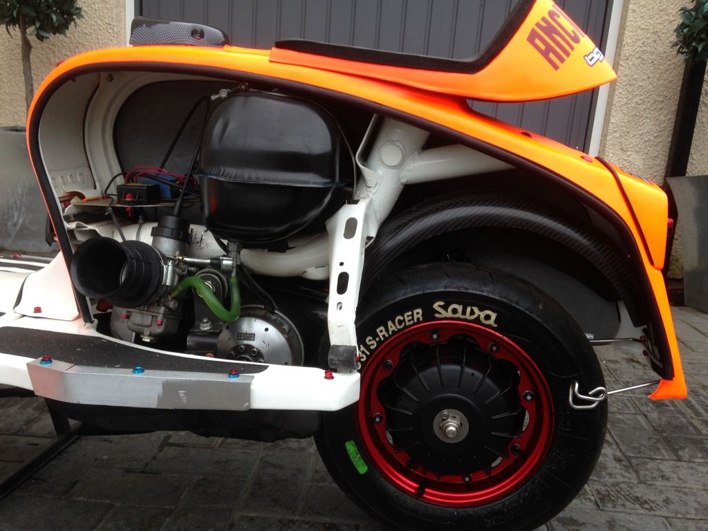

Postby Dazts1 » Sun Jan 17, 2016 8:58 pm

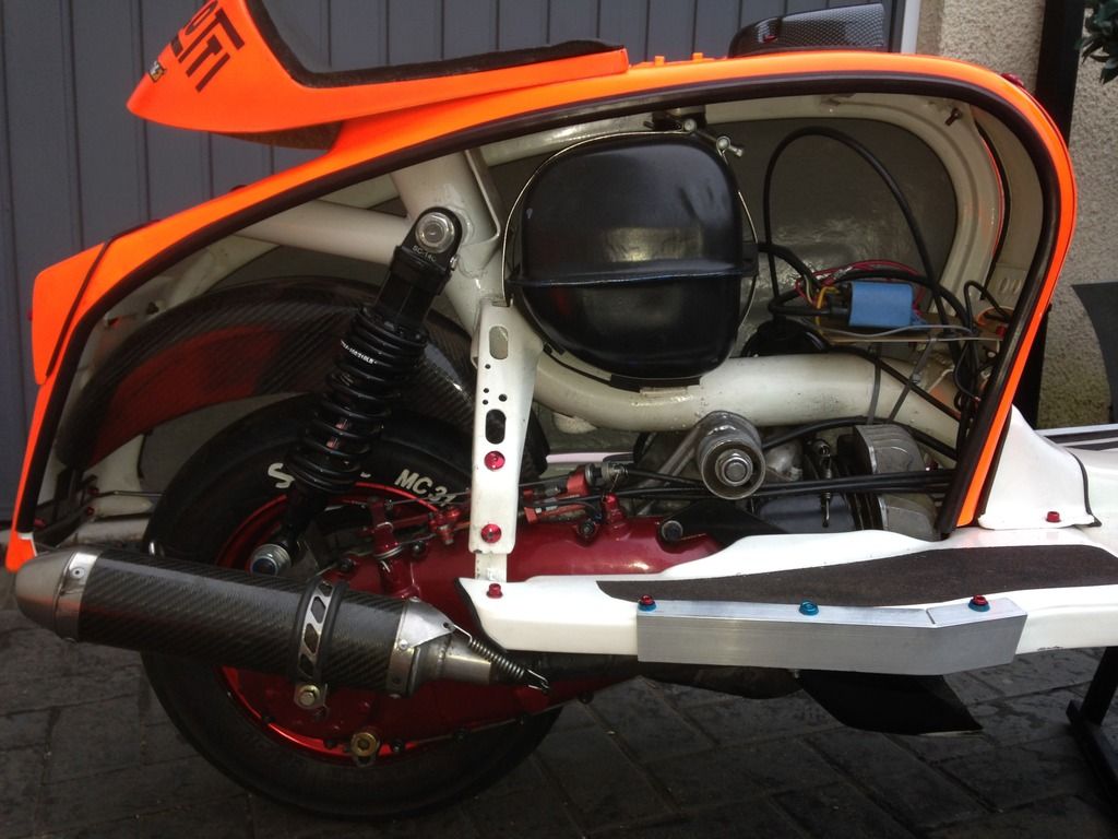

I've been adding a little extra striping to the paint, daft I know keep it simple in case of another off. I've also got a mugello upgrade to add to the motor and another ignition system coming soon

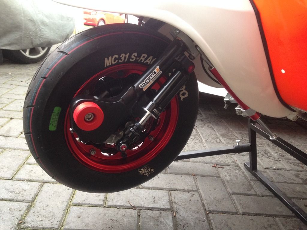

I've also lengthened the bgm shock to it's max 310mm to jack the back end up for better ground clearance.I've also been advised this gives better handling. You can see by the gap from rear wheel to mudguard.

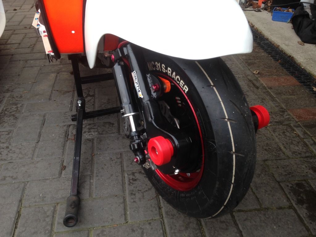

Postby Dazts1 » Sun Feb 07, 2016 10:07 pm

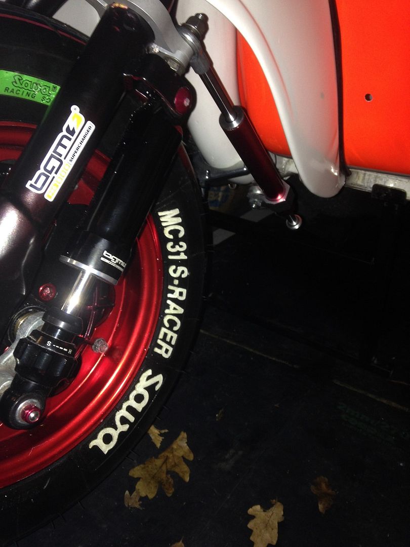

A little more prep work. Picked up a few bits , added a steering damper. Team replay have been running these this year. With good results I'm told. Also got myself a pair of crash bobbins for the forks. These will protect the forks and dampers if we take a tumble again.
It's got a good feel to it.
