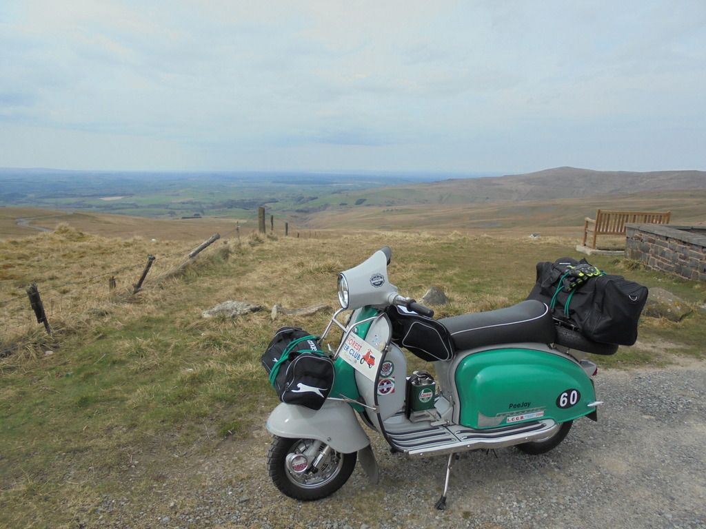

pictured at Hartside Summit on my way to Saltburn

What sort of screen do you have on the scoot ?
Saw it outside the Seacote and thought it suited the scooter. very nice.

hi Mick
it started off life as an SX coast to coast screen.
i'm using a PX disc larger headlight so the screen was modded at the front to suit and a club mate who is a boat laminater made a mould, lot of faffing around to do it but worth it in the end.
the original one was bought on fleebay and is made of abs plastic and is suited for a hydraulic front brake. it is possible to fit it on a standard S2 handlebar with some internal cutting of the screen but i needed a much bigger hole for the light.

Peejay, always admired your series 2, the perfect rally scooter in my mind. That seat looks soooo comfy. :D

really great picture Peejay . Your scoot looks like you're kitted out for a 2x week Himalayan expedition :lol:
Tell us a bit about the ride for those of us that couldn't make it. ;)

Lovely scooter Peejay, I also use a tank bag in a similar way, how do you support yours?

i do tend to carry rather a lot of baggage when on weekenders!
i'll be posting pics of the event soon, i'll say more then :)

Beautiful looking scooter Peejay, just looks so right.

thanks Andy, it's taken some time to get it just how i wanted it but been worth the effort for sure :D

Can I ask if the dampers are BGM and do they fit straight on with the turning mudguard ?

dampers are BGM with a homemade stainless piston krud deflector.
you will need a 10mm spacer to move mudguard away from damper, mine are nylon.
