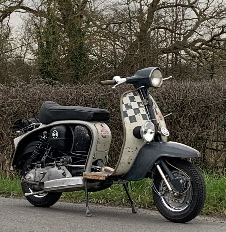

Postby alex_hughes » Thu Mar 12, 2026 11:01 pm
Maiden voyage
Really not completely road ready… cables need shortening etc but I couldn’t resist a blast up the road. Rides very nicely, always a relief
