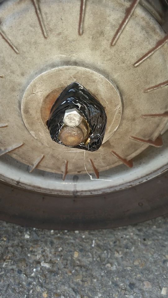

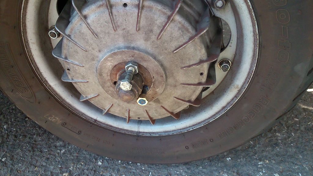

So what do you do when your in the middle of Belgium , and you loose your locking ring ? BTW this was his second ring to go missing on this trip :shock: the first was only noticed, when his wheel came loose on a french motorway :shock: .... luckily he noticed the second one missing at a service station . When he told us, he was white as a sheet , i think partly because he realised he 'd had a lucky escape, and partly because the van with all the spares had left us, to go home a few hours before.
So where can we get a locking ring and an M7 grub screw ? ....in the middle of belgium ???
After a little lateral thinking , we came up with this ,a shocker half nut , then the hub nut locked up tight, an M7 exhaust stud and nut , a hub extractor bolt, an M8 nut and finished of with the bodgers staples, a cable tie and gaffer tape to hold it all together :D
We managed to convince him that it was "probably" more secure than Innocentis solution :D
He did another couple of hundred miles like that , it didnt move ;)
