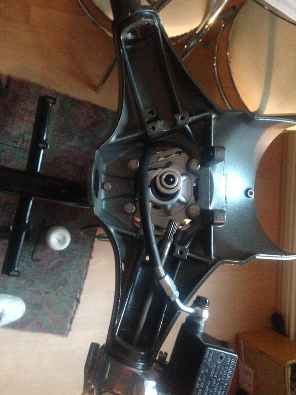

hi,
Has anyone got pics of the routing for a hydraulic disc brake hose on a series 2, particularly the headset? Thank you

Postby Norrie Bodge » Sat Jun 06, 2020 3:53 pm
lammydave wrote:hi,
Here’s mine

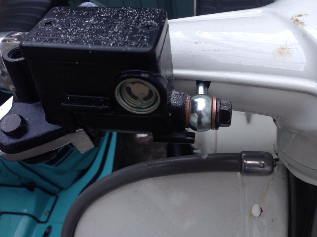

Postby drivera » Sat Jun 06, 2020 6:10 pm
Replace the headset bolt with a shorter Allen bolt and use the ready made hole in the headset :D

Postby shane BBoys » Sat Jun 06, 2020 6:57 pm
As above use a series 3 bolt for the clamp it allows for a route through.

Postby lammydave » Sun Jun 07, 2020 11:02 am
nice one, guys, thank you .. like the bolt idea... saves drilling!!
