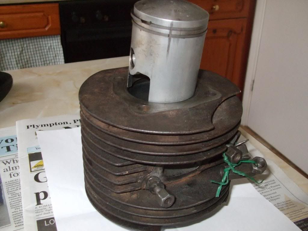

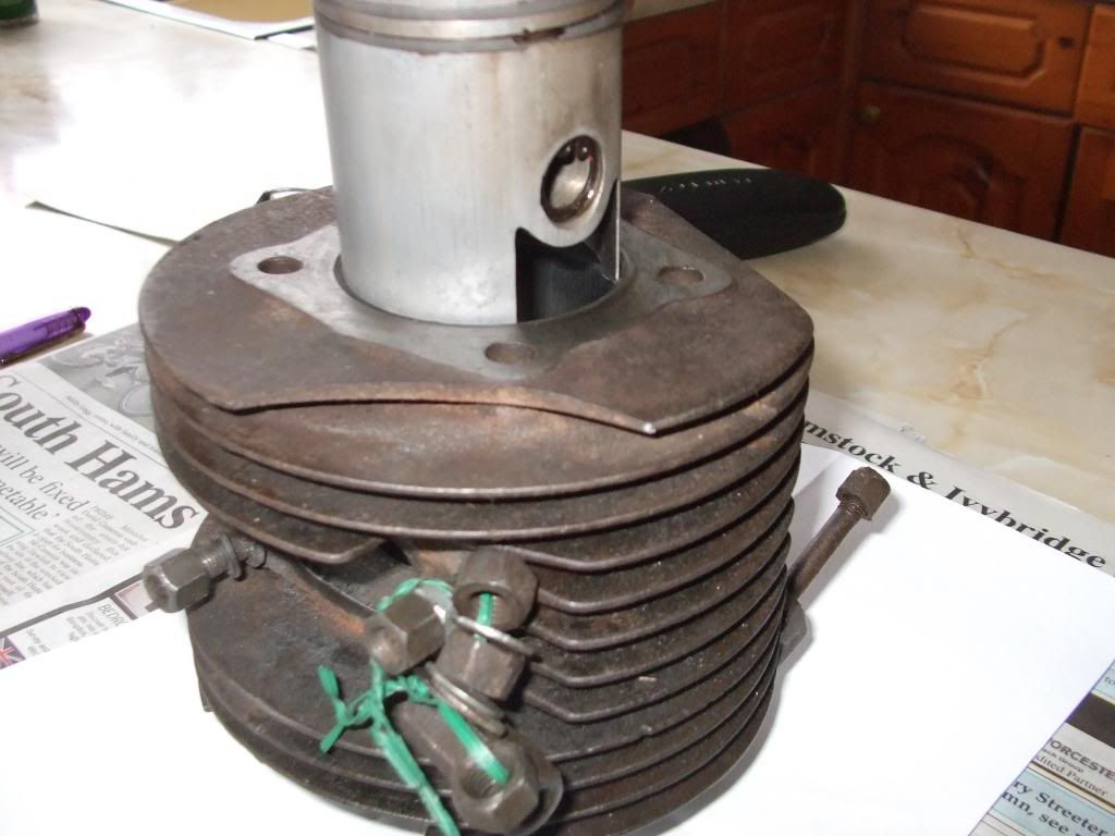

Postby Alex_amd2001 » Fri Feb 13, 2015 9:40 am
Okay, so I'm trying to check if the piston is in the right way around, but there's no arrow stamped on it. There's an S1 stamped but not much else. Is there any other way to determine the way it goes? Ring pegs closer to the ground...if that makes sense? Truly driving me nuts now. Thanks everybody!

Postby grandpa » Fri Feb 13, 2015 10:42 am
Hi Alex,
Look at page 103 top right hand corner of Sticky's 2nd edition note shape of piston under gudgeon pin opposite side of mag.
If engine all assembled pour a thimble full of fuel down plug hole refit plug and it should run for a few seconds.

Postby Alex_amd2001 » Fri Feb 13, 2015 12:23 pm
Thanks Grandpa, that's really helpful. Appreciate it.
